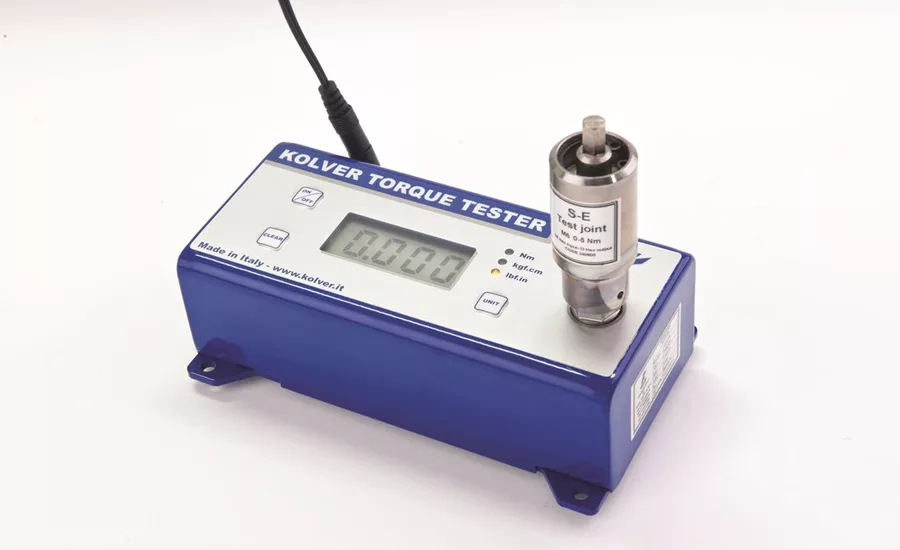

As a backup to regular calibration, assemblers can conduct periodic spot checks of their tools using a torque tester with a built-in stationary transducer. Photo courtesy ASG, Div. Of Jergens

As a backup to regular calibration, assemblers may want to conduct periodic spot checks of the tools using a torque tester with a built-in stationary transducer or a torque analyzer equipped with a rotary transducer. The latter may be more suitable for plants assembling several joint sizes, because one analyzer can work with several sizes of transducer.
"If a tool is out of calibration, you'll find it faster through spot checks than you will in a 6-month or yearly calibration cycle," says Mountz.
Torque-testing equipment can be scattered throughout an assembly line, or it can be gathered in a central location within the plant. Some manufacturers opt to put torque-testing equipment onto a cart so it can be brought to the tools, instead of the other way around.
The accuracy of torque-testing equipment ranges from 0.1 to 1 percent of a given value. In comparison, the clutch of a typical pneumatic tool might be accurate to within 10 to 20 percent. Depending on its sensitivity and features, a torque tester ranges in price from $1,750 to $2,500. A rotary transducer costs between $1,100 and $2,000, and a torque analyzer costs $1,500 to $2,000. A typical assembly plant might invest $500,000 in tools, so in the big picture, that's a small investment.
