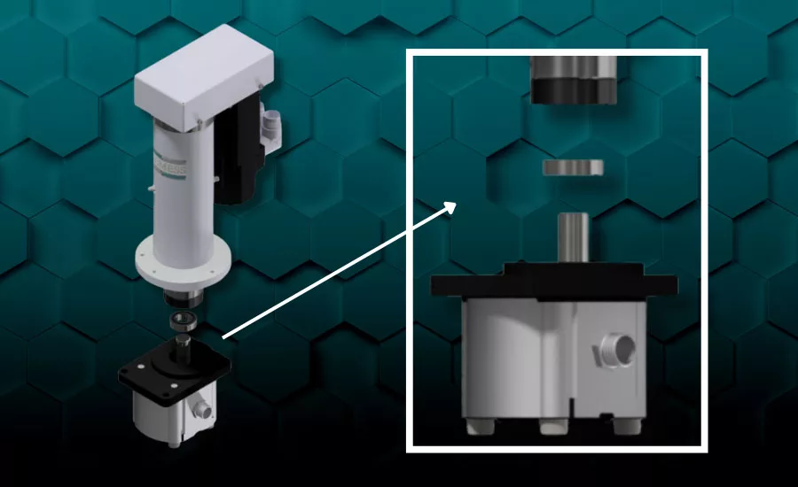

How One Pump Manufacturer Saved $1 Million by Replacing a Hydraulic Press with a Promess EMAP
Promess EMAP
Image Credit: Promess Inc.

The Challenge: Uncontrolled Force = Hidden Product Failures
The manufacturer used a hydraulic press to insert bearings into pump housings. As with most hydraulic systems, the press went to full pressure every cycle, regardless of part variation. That meant some bearings were being over-pressed, damaging them in a way that wasn't detectable during internal testing.
The consequences were significant:
  • Excessive force caused internal component damage
  • Pumps passed inspection but failed prematurely in the field
  • Warranty costs skyrocketed
  • No force monitoring meant no way to identify out-of-spec assemblies
They needed a solution that could adapt to part-to-part variation while providing full process control and traceability.
The Solution: Intelligent Force Control with the Promess EMAP
Promess introduced a 20kN Electro-Mechanical Assembly Press (EMAP) paired with a Promess motion controller. This integrated solution is built to deliver precision, repeatability, and real-time feedback.
How the EMAP Solved the Problem
1. Adaptive Force Control
Instead of slamming to full pressure every cycle, the EMAP:
  • Began pressing to a defined point
  • Switched to a relative force mode, applying only the exact force needed
  • Prevented over-pressing and eliminated hidden component damage
Each bearing was pressed to the proper seating force.
2. Complete Process Monitoring
Every cycle generated a force vs. distance curve, capturing real-time performance data. This allowed engineers to:
  • Verify every press cycle
  • Detect anomalies
  • Compare results against tolerance bands
  • Improve overall process control
3. Full Traceability
The system stored process signatures and cycle details such as:
  • Date and time
  • Pressed part serial number
  • Force/distance curves
  • Pass/fail results
This meant every pump had a complete historical record, which is a requirement for many quality-driven industries.
