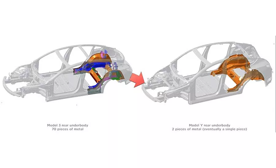

Large castings have enabled Tesla to consolidate components and reduce the number of stamped metal parts. Illustration courtesy Tesla Inc.

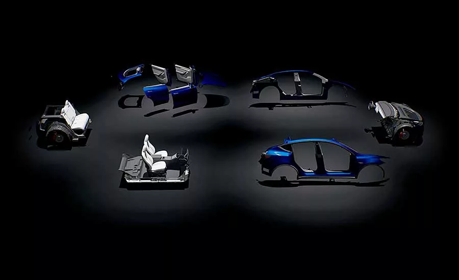

Production process.
The unboxed production process will consist of five main subassemblies, including front and rear mega castings. llustration courtesy Tesla Inc.

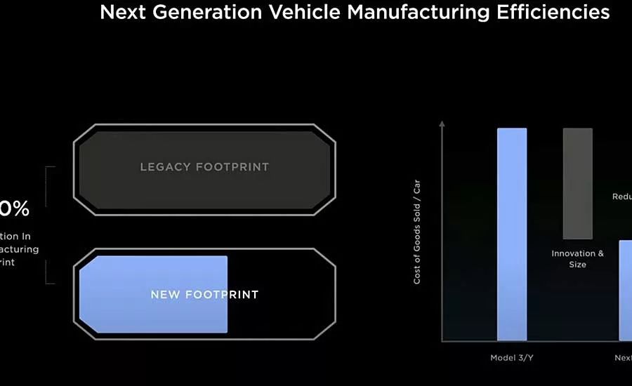

Next Generation Vehicle Manufacturing Efficiencies.
Tesla hopes to improve manufacturing efficiencies and reduce production bottlenecks. Illustration courtesy Tesla Inc.

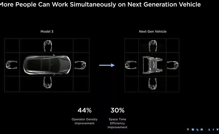

More People Can Work Simultaneously On Next Generation Vehicle.
Tesla’s next-generation vehicle will result in a 44 percent density improvement and a 30 percent improvement in space-time efficiency. Illustration courtesy Tesla Inc.

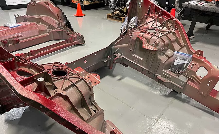

The Tesla Model Y pioneered the concept of using large mega castings, such as this front end. Photo courtesy Munro & Associates

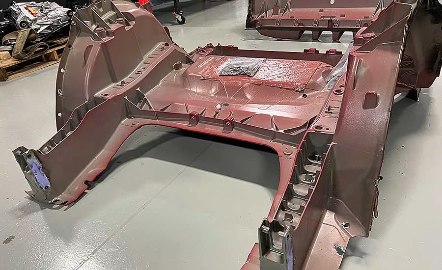

This rear casting used by Tesla simplifies assembly by eliminating hundreds of stamped metal parts. Photo courtesy Munro & Associates
This photo shows the front (right) and rear Model Y mega castings side by side. Photo courtesy Munro & Associates

“By doing the same thing on the front or rear part of a vehicle, we can get more people working on the car at the same time, resulting in better operator density,” Moravy points out. “[On our next-generation vehicle], that will result in a 44 percent density improvement and a 30 percent improvement in space-time efficiency.”
Moravy says that will make automation easier to implement on final assembly lines. “We will balance parallel and serial manufacturing in a way that we only do things that are necessary, with a much shorter final assembly line…that optimizes material flow,” he explains.
“We will take all of the tested subassemblies and attach them,” notes Moravy. “We will only attach doors and other parts once. Interiors will [be inserted into the body] from the bottom up. That means we’ll be doing more work on the car more of the time.”

Tesla has already revolutionized automotive assembly with its front and rear mega castings. Large 6,000-ton aluminum die casting machines eliminate hundreds of stamped metal parts. The giga presses enable Tesla to produce a three-piece chassis that consists of a structural battery pack sandwiched between a front and rear casting.
“The front and rear giga castings are massive components that together eliminate more than 350 stamped steel parts, including brackets,” says Cory Steuben, president of Munro & Associates, which has performed tear downs of electric vehicles, including various Tesla models, looking for product design flaws and manufacturing improvements.
“The front casting includes the left and right shock towers, the wheel arch, the crush can for the front bumper, and the left and right door hinge pillars,” explains Steuben. “The rear casting is even longer, reaching all the way from the rear bumper crush can to the rear passenger seat. Some portions are very thick, while others are quite thin.
“Right now, many of the workstations and production tools used at Tesla’s assembly plants are exactly as you’d see at a legacy automaker” Steuben points out. “However, the level of integration in the body structure has revolutionized the size of the body shop.
“When I visited the Austin factory recently, one front casting was coming off the giga press about once every 60 seconds,” notes Steuben. “Each one eliminates roughly one-third of the traditional body shop that produces a stamped steel, welded vehicle structure. The production cell itself measured about 100 by 100 feet, with 14 operators.
“Castings are like stones,” says Steuben. “They provide amazing structural rigidity, because they don’t flex like many types of stamped steel subassemblies. They are attached to the rest of the vehicle with threaded fasteners and structural adhesives.
“However, one thing that Tesla has struggled with in the past are thin, nonstructural portions,” claims Steuben. “They sometimes get hairline cracks in them, which can lead to water ingress issues. A traditional stamped panel, on the other hand, wouldn’t have this problem.”
