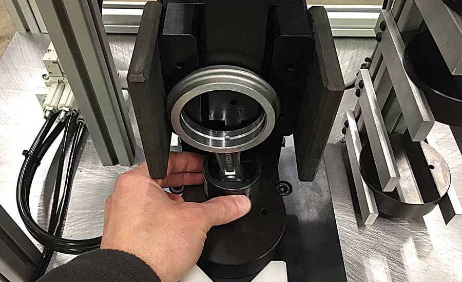

In this application, a piston assembly is loaded into the fixture prior to pin insertion. Spacer blocks on the right allow for various piston heights and sizes. Photo courtesy BalTec Corp.

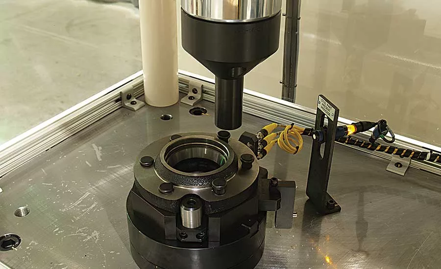

Press-fitting is used for small and large parts. Here, studs are inserted into a forklift wheel hub. Photo courtesy FEC Automation Systems

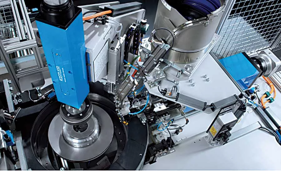

Automotive manufacturers frequently use press-fit assembly. This unit press-fits a component into a brake disk. Photo courtesy Kistler Instrument Corp.

BalTec offers several manual, pneumatic and hydropneumatic presses for press fitting. Customers include automotive, medical and other industrial manufacturers such as HVAC-component makers. One latter company recently asked BalTec to customize two DA-850 pneumatic presses so they can press-fit pins into 40 different-height pistons for refurbishing HVAC compressors.
Each direct-acting press features a ram that produces up to 8.5 kilonewtons of force and a stroke up to 80 millimeters. The press’s upper tooling is able to insert pins in pistons of all heights, whereas its fixture has quick-change spacer blocks that accommodate height variations. A pneumatic clamp device secures the piston in place during pin insertion. Force and distance monitoring triggers an audio sound and visual message to indicate whether the specific process is OK or not OK.

Regarding shape, most press-fit parts are round, but they can also be oval, square, rectangular or triangular. Inserted parts may be solid or hollow. Keith Lowery, servo press product specialist at FEC Automation Systems, notes that nonround parts may require an extra step to ensure proper orientation, resulting in longer cycle times. Large parts require a press that provides higher and more consistent force and sufficient part access.
Part alignment is equally important for a good press-fit assembly, according to Natsume. He says the best way to prevent misalignment is to use the right tooling and fixturing.
To enhance joint strength, part edges may be designed with indentations or projections. Lowery says that knurls enable the inserted part to bite into the mating part and help prevent the joint from moving when exposed to high torque forces. In plastic and electronic assembly, grooves or barbs on the mating part help prevent the joint from being pulled apart.

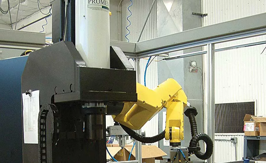

“Without a doubt, servos offer the most precise control of ram position and speed for accuracy and repeatability,” says Zabrosky. “However, if a high level of precision isn’t needed, I’d recommend the company use a manual or pneumatic press instead, because they are cheaper and require less maintenance.”
High-volume assembly is needed to justify the servo’s higher upfront cost, confirms Lowery. Other benefits of the servo press include flexibility for high-mix operations, energy efficiency, quiet operation and a relatively small footprint.

Another tool that significantly enhances press-fit assembly is force and distance (displacement) monitoring, says Zabrosky. The force sensor is installed between the cylinder and the ram, and measures the force produced during the entire assembly cycle.
The distance sensor (or transducer) is positioned near the force sensor so that the press controller can display curves of force over distance or force over time. Through the controller, engineers can also set upper and lower limits for the pressing force. Should it fall above or below the set figure, an alarm is signaled.
“Force and distance monitoring is a great way to gain valuable information about the quality of the parts and the assembly—so long as the press frame is properly designed,” concludes Brieschke. “If the frame deflects too much, the resulting force-distance curve will be skewed from actual results. The best way to prevent deflection is to engineer enough strength within the frame design or use reinforcements.”
