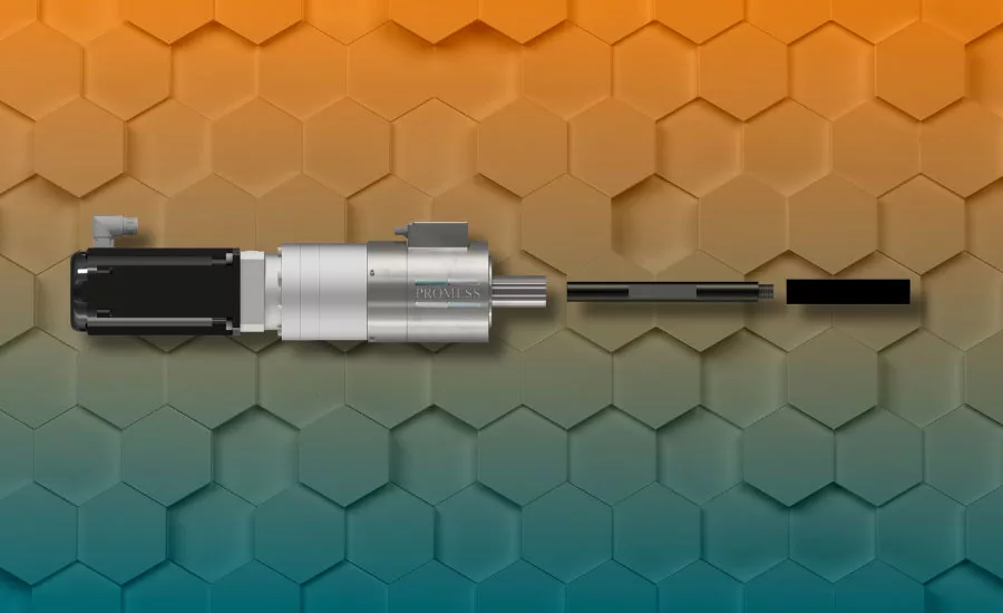

Automating Rifle Barrel Assembly with Precision: How Promess TorquePRO Improved Alignment, Accuracy, and Traceability
Promess TorquePRO
Image Credit: Promess Inc.

The Solution: Automating Barrel Alignment and Torquing with Promess TorquePRO
Promess implemented a 200 Nm TorquePRO system paired with the UltraPRO controller to transform this operator-driven task into a fully automated and highly controlled assembly process.
Precise Dovetail Alignment
The primary challenge was ensuring the dovetail cut on the barrel (used for front sight mounting) aligned perfectly with the rear sight on the receiver. Previously, this alignment was subjective and relied heavily on visual judgment.
With TorquePRO:
  • The system automatically rotates and seats the barrel into the correct orientation.
  • A closed-loop control algorithm ensures alignment accuracy without manual intervention.
  • The need for visual confirmation or hand-adjustment is eliminated entirely.
Controlled, Repeatable Torquing
Firearm performance depends on barrels being torqued within a tight specification. Over-torquing risks distortion; under-torquing risks movement during use.
TorquePRO delivers:
  • Accurate torque application within defined limits
  • Live monitoring of torque and angle signatures
  • Repeatability from assembly to assembly
This ensures every barrel is installed with absolute consistency.
