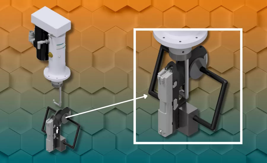

The Solution: EMAP + High-Precision External Load Cell
Promess’ applications engineering team collaborated with the manufacturer to develop a complete solution centered around the Promess Electro-Mechanical Assembly Press (EMAP), equipped with a 10 lb external load cell calibrated specifically to 5.5 lbs and capable of ±0.5% accuracy.
Why This System Was the Perfect Fit
1. Ultra-Precise Force Measurement
The external load cell provided resolution low enough to measure forces down to mere ounces. This allowed engineers to map trigger force profiles with exceptional detail.
2. High-Accuracy Position Control
The EMAP’s servo-driven motion ensured linear, repeatable displacement, travel distances, and trigger break positions.
3. Dual Data Monitoring
Both force and positional data were monitored continuously through Promess software. Each trigger stroke was automatically evaluated against the manufacturer’s specification.
4. Automated Sorting and Rework
Any unit falling outside tolerance was:
  • Flagged immediately
  • Removed for rework and retesting
  • Logged with data for continuous improvement
Engineers could customize system responses—stop the process, divert the part, or continue with tagging—based on their production strategy.
