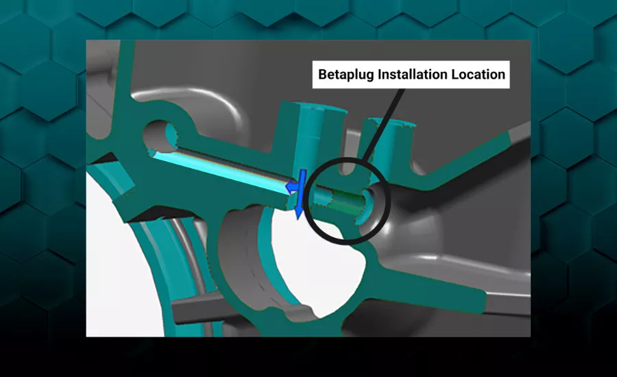

Modern automatic transmission cases are highly complex castings with intricate internal channels designed to manage hydraulic flow and control functions. Many of these channels cannot be cast internally and must be connected using cross-drilled holes which is a process that drills through the outer housing and internal passage walls.
content provided by promessOnce cross-drilling is completed, the external opening must be sealed reliably to prevent fluid loss. Even small inconsistencies in sealing can lead to leakage, cracking, and costly warranty failures.
One long-time Promess customer faced exactly this challenge when a proven sealing method began failing in a newer, thin-walled transmission housing design.

To solve the cracking issue, the manufacturer replaced the steel ball with a Betaplug® expansion plug from The Lee Company. This two-piece tapered plug features:
  • An outer plug body with lands and grooves
  • An internal pin that expands the plug radially
  • Predictable boss stress ideal for thin or brittle materials
  • A controlled staking process that locks the plug in place
The Betaplug eliminated the cracked housings and improved sealing integrity.

Promess engineers collaborated with The Lee Company to analyze the full installation profile. They recommended leveraging the EMAP’s advanced data processing capabilities, not just force or distance independently, but the rate-of-change relationship between force and displacement.
During installation:
  1. The plug initially moves as a unit into the bore
  2. Resistance increases as the lands bite into the housing
  3. The plug body stops moving
  4. The inner pin continues advancing, expanding the plug
  5. A distinct inflection point appears in the force-distance curve when staking begins
This inflection point is highly repeatable and provides a precise indicator of proper installation.
By programming the EMAP to detect this inflection point and terminate the press cycle accordingly, the system ensured:
  • Proper staking depth
  • No over-pressing
  • Consistent sealing performance
  • Automatic detection of missing or misoriented components
