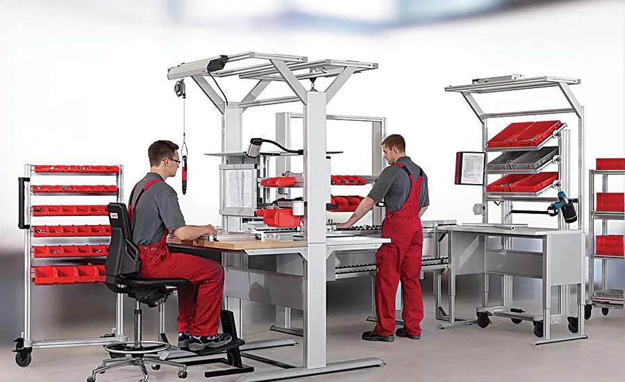

Ergonomic Work Benches
In looking after the well-being of employees, work bench components need to be designed to fit with easily-adjustable features wherever possible. After a brief training, including how to adjust chairs, employees can make all the necessary adjustments independently so they may work in their best posture and, more importantly, modify that posture at any time.

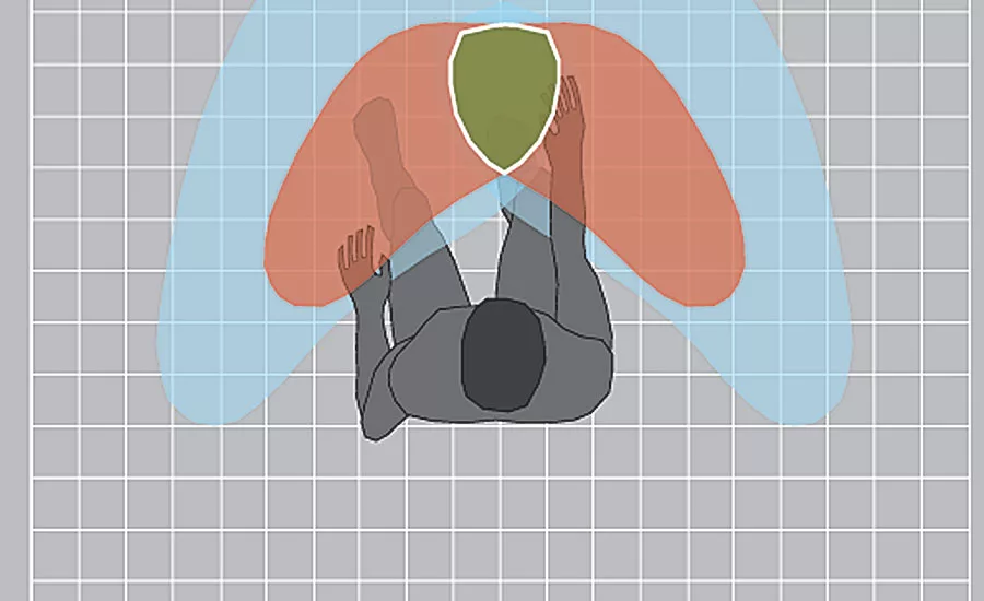

When it comes to handling materials at a work bench, the ideal place to position components is in a zone reachable by each arm (seen as the orange zone in the figure to the right). Operators can reach articles in this zone without having to turn their bodies. This high-degree of flexibility keeps reaching distances to a minimum and reduces the musculoskeletal strain on the employees while increasing productivity.
Items used less frequently can be located in the extended zone (seen as the light blue section in the figure above), which also stretches away from the bench. This zone can incorporate mobile picking trolleys, which – if they are height adjustable - can enable operators to alternate between sitting and standing.
