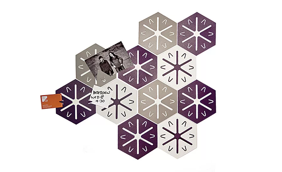

One of Klickity’s most popular products is its KLIP modular notice board, which was introduced in 2014. The board consists of hexagonal polypropylene (fully recyclable) discs that are placed next to each other to form rows and columns, or overlapped to form clusters.
Sold in packs of four, each disc measures 6.1 by 7.1 inches, and features top-side slots and an eye-catching color pattern (purple-white, grey-white, yellow-white, yellow-gray, or blue-navy). Paint-friendly sticky pads on the back of each disc allows it to be easily attached to a wall. Letters, notes and photos are then clipped into disc slots as desired.

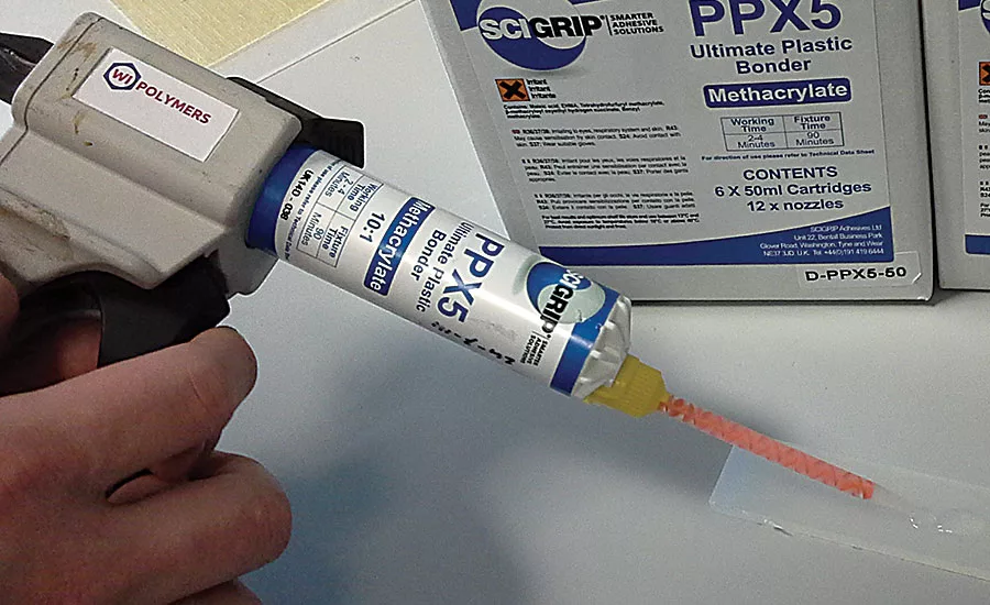

Development of the KLIP board did pose one new challenge to Cronin. During prototyping, she discovered that the self-adhesive dots used successfully in Klickity’s other non-shear applications did not keep the pads adhered to the discs when shear load was applied. This occurred because the discs’ polypropylene surface was repelling rather than attracting the self-adhesive dots.
To resolve this problem, Cronin enlisted the help of Action Adhesives, the local distributor for adhesive-supplier Scigrip. Action Adhesives recommended the dots be replaced with a two-part methyl methacrylate adhesive called PPX5.
This adhesive is formulated to provide a resilient bond to polypropylene and other low-energy surfaces without any pretreatment. In addition, its low exothermic (heat-releasing) properties prevent polypropylene from deforming during adhesive curing.
To verify PPX5’s effectiveness, the distributor conducted a series of successful test bonds with polypropylene samples. Cronin also likes that the adhesive is low odor, has an off-white color when cured, resists most chemicals and is easily applied from 50-milliliter dual cartridges.
