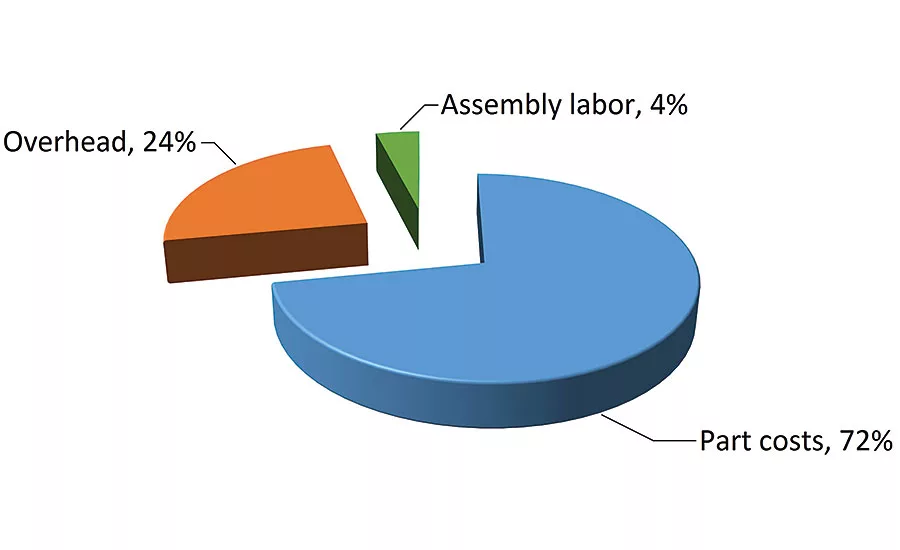

Although the percentages vary, the overall cost breakdown of a product is typically this:
  • Parts, 72 percent.
  • Overhead, 24 percent.
  • Labor, 4 percent.
Most of a product’s cost is tied up in materials and process-related outlays. The cost of direct labor usually makes up the smallest proportion. Overhead is still significant, but that also represents a much smaller proportion of the total cost.

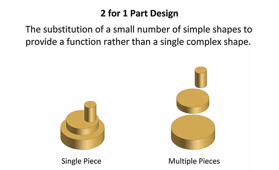

In the early 1950s, an engineering practice called design for producibility (DFP) began to take hold. Seeing a steady increase in manufacturing costs, design managers worked with production to make designs that were better suited to the shop-floor capabilities of the day. This approach invariably simplified parts, but it also created a much more complex product structure through an increase in the overall number of parts. For example, DFP recommended that designers separate complex parts into a series of simple shapes and then join them together during final assembly.
On the surface, the practice makes some sense, because the parts themselves make up the majority of total product cost and the labor cost is often small. However, more than 30 years of experience shows that it is much more cost-effective to produce the single, more complex multiunctional part rather than the series of simple shapes all joined together.
Why? The majority of the cost reduction that results from using the more complex (functional) shape does not come specifically from a reduction in assembly cost. The largest savings actually come from a reduction in part manufacturing costs! This is because it is often less expensive to use modern manufacturing processes to make the single, more complex part, than it is to make a greater number of simple parts.

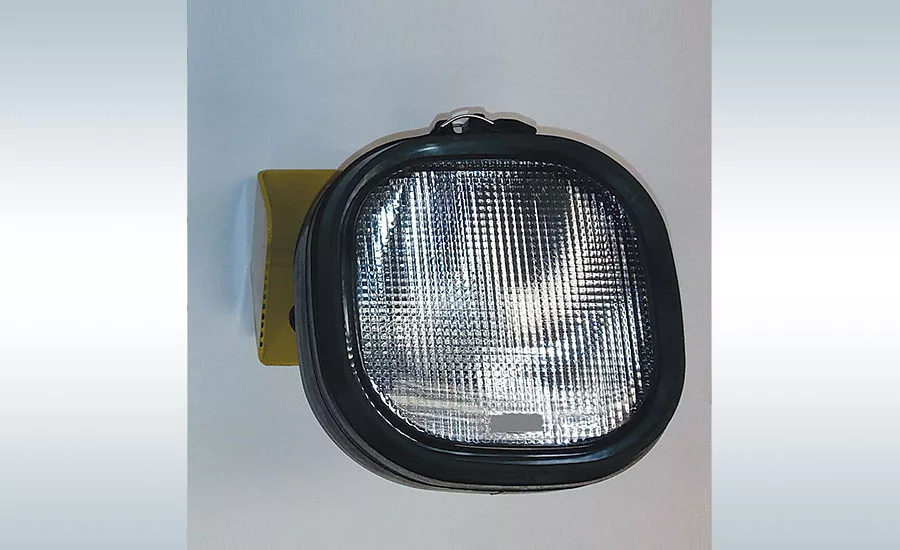

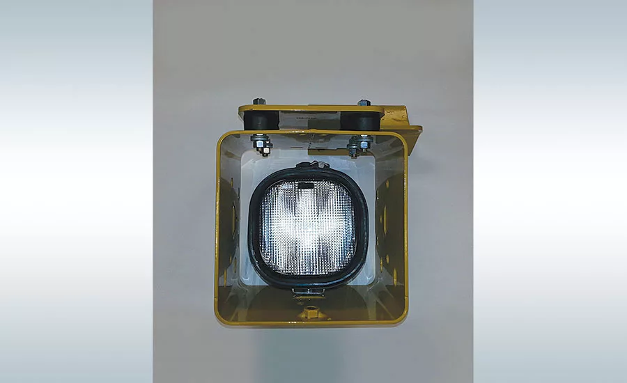

Dissecting a Lamp Assembly

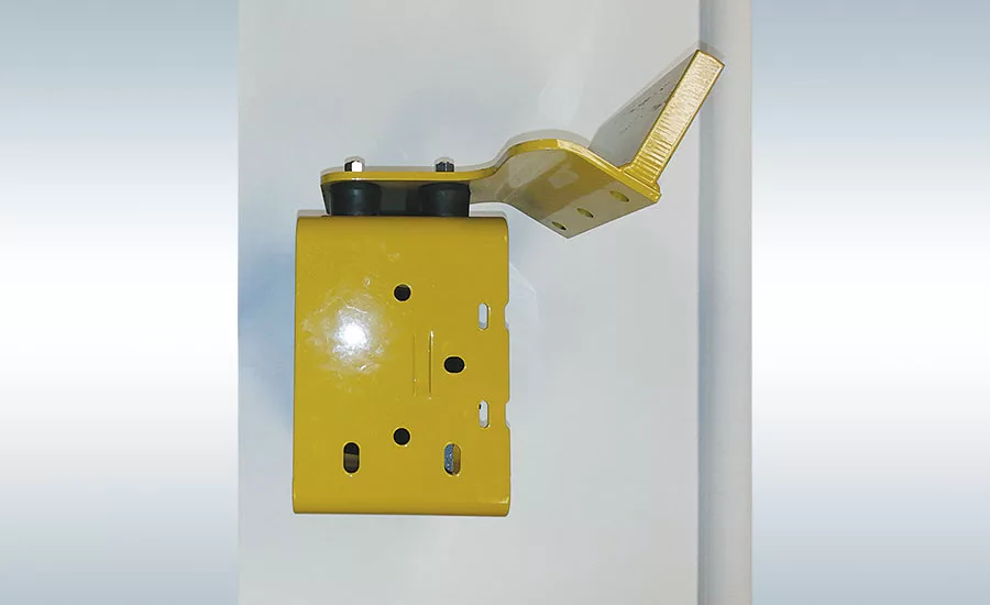

As an example of how DFA can lower cost and improve functionality, let’s consider an OEM’s recent redesign of a rear lamp assembly for a piece of heavy equipment. The original design consists of 37 parts. There is a lamp bracket made from a mounting block that is welded to a cantilevered mounting plate. Four rubber isolation mounts are secured to the bracket with nuts and washers. A lamp “guard” is then mounted to the other end of the isolation mounts, also with nuts and washers. The lamp and pivot bracket are then mounted inside the lamp guard with a screw and washer. Many of the parts are made from 0.25-inch thick mild steel, and the total weight of the assembly is about 18 pounds. This design had been in production for more than 20 years.
Boothroyd Dewhurst DFA software was used to derive an estimate of 13 minutes to assemble this design, including the time for all the welding and dressing. DFM Concurrent Costing software was also employed to estimate the manufacturing cost for all the parts. The total cost to manufacture, assemble and install this design was estimated to be $88. Feedback from the manufacturer indicated that the estimate was within 10 percent of the price they actually pay for the product, so the software’s estimate of total cost for the original design is reasonable.

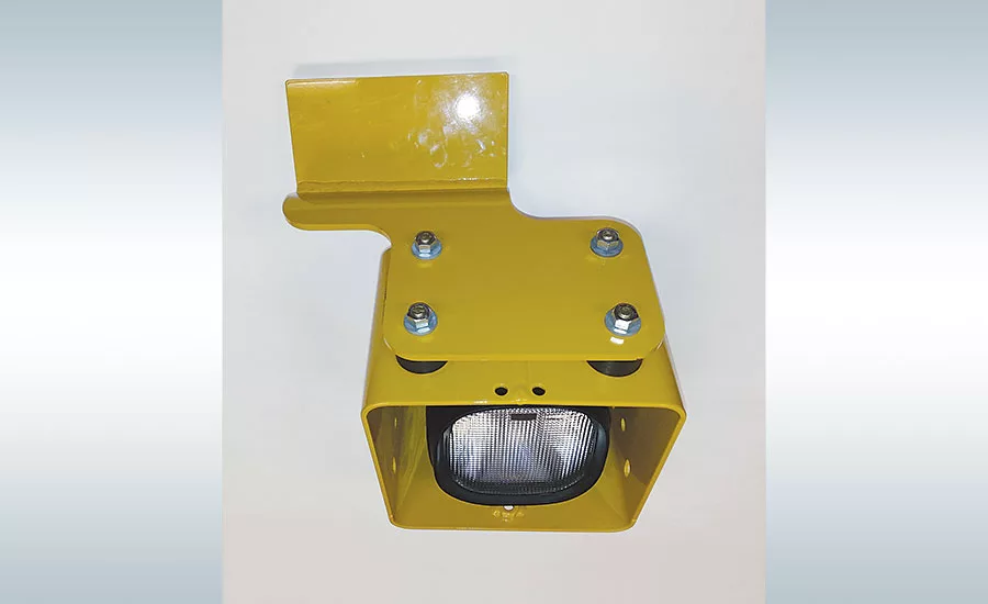

The OEM identified the lamp as a possibility for cost reduction and redesigned it. To create a lower-cost design, the lamp guard and the isolation mounts for the lamp were removed. And, the lamp bracket was made from 0.125-inch mild steel.
Each part in the redesign still serves only a single function, and the functionality of the lamp bracket is certainly debatable. The DFMA
software estimated that the redesigned lamp assembly would cost $42 to manufacture, assemble and install.
Feedback from the manufacturer indicated that estimate was again within 10 percent of what the company pays for the lamp assembly, so it was a fair benchmark.
Clearly, the company’s design philosophy for the lamp assembly was directed at the cost of the individual parts rather than on the efficiency of the whole product as a system of integrated components. To satisfy the target cost, the company removed the functionality of the lamp guard and rubber mounts. The remaining parts were cheapened through a reduction in their thickness and strength. The practice of functionality removal to save money is quite unusual today because, normally, product functionality is fixed by the customer’s expectations or by the functionality of similarly classed products from competitors.

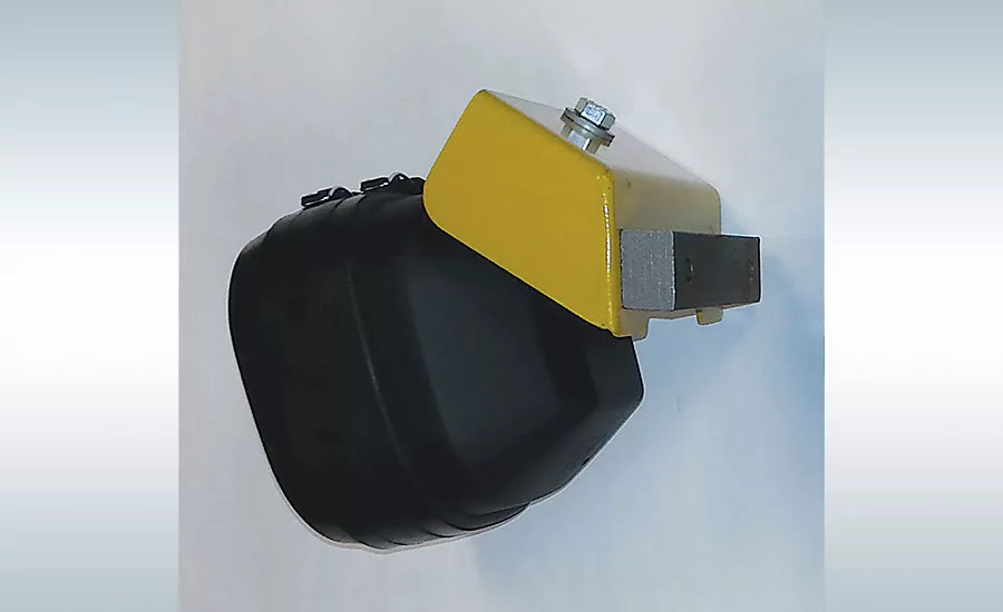

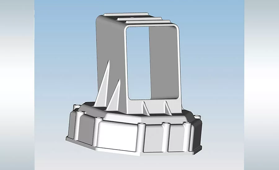

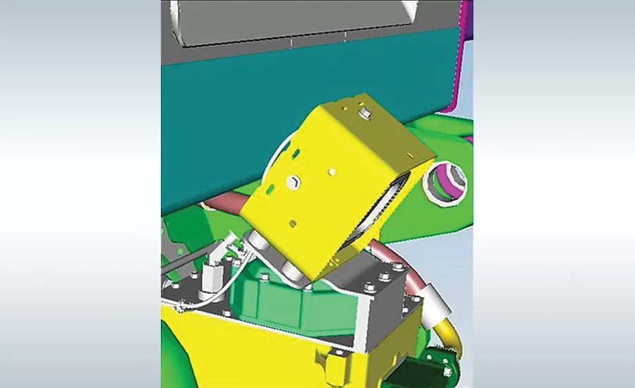

The original design called for the lamp assembly to be located on the rear of the vehicle, just above the transmission cover casting. That is the optimal location because the lamp is unlikely to suffer damaging impacts, and it can provide light where needed at the rear of the machine. This situation presents an opportunity to use DFA principles to reduce cost by integrating the mounting bracket and guard into the transmission cover casting. This redesign changes the simple, single-function transmission cover into a multifunctional part.
To determine the portion of the cost for the multifunctional part that is attributed to the lamp assembly, the cost of the original, single-function transmission cover was estimated and then subtracted from the estimate for the redesigned cover that includes the integral lamp guard. This results in a cost estimate of $48 for the DFA redesign and includes the amortized cost of the pattern and core box required to make the aluminum sand casting. The estimate for the DFA redesign also includes a cost of just over $4 for the rubber isolation mount and hardware to mount the lamp inside the lamp guard.
Comparing Designs

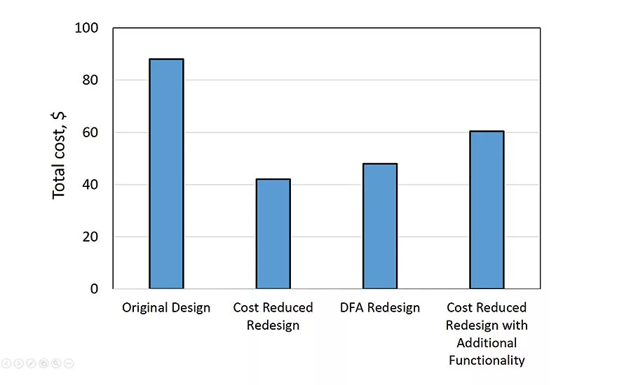

The single-part, single-cost engineering method that the OEM initially used in redesigning the lamp assembly led to a noteworthy 52.3 percent cost reduction. However, that reduction was generated at the expense of functionality. This illustrates the largest problem associated with such a design philosophy: It leaves the design team with few options to satisfy cost-reduction goals other than to sacrifice the very things that the customer wants to buy, such as the functionality, durability and performance of the final product. If this design method were applied to redesign the rest of the vehicle, the customer would likely find less value in the vehicle and purchase a competitor’s product instead.

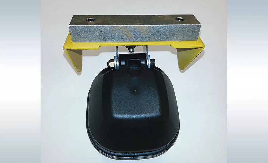

The DFA method, which concentrated on finding assembly labor efficiency, resulted in a similar 45.5 percent cost reduction. Yet, it sacrificed none of the original design’s functionality. In fact, a knowledgeable customer is likely to view the DFA redesign as an improvement in the product, rather than a cost reduction, because the DFA redesign is likely to handle vibration better than the original. It will tend to be more reliable during use due to the robust lamp guard integrated into the casting.
However, the DFA redesign in this case does cost $6, or 14.3 percent, more than the manufacturer’s cost-reduced redesign. More than two-thirds of that difference can be attributed to the $4 needed for the rubber mounts, a feature that was removed in the other redesign to save money.
Upon presentation of this DFA redesign to the company, the designer said that he would never take this approach with the design because the redesigned transmission cover casting would cost too much to produce and would require a core for manufacture. Such statements demonstrate the resurgence in the old design philosophy that focused on the cost of a product’s parts, even to the point that functionality is removed to save money.
While it is true that the multifunctional casting in the DFA redesign costs more to produce than the original transmission cover casting, it also eliminates the need for a separate lamp bracket and guard. When all of this is considered, the DFA redesign is quite cost competitive, especially if the functionality and usefulness of the design are taken into account.
The designer at the OEM also indicated that it would be much more cost-effective to add a guard and a rubber isolation mount to the cost-reduced redesign. This option was investigated, and the DFMA software determined that this design would cost just over $60 to manufacture, assemble and install. This means that the least expensive option that incorporates all of the original design’s functionality is the DFA redesign that utilizes the multifunctional transmission cover to minimize the amount of assembly labor required!
It should be noted that the feedback we received occurred before the designer saw the cost estimates for each design alternative. After the cost estimates were disclosed, the managers at the company thought it was well worth the extra $6 to provide the customer with a guard and a rubber-mounted lamp.
