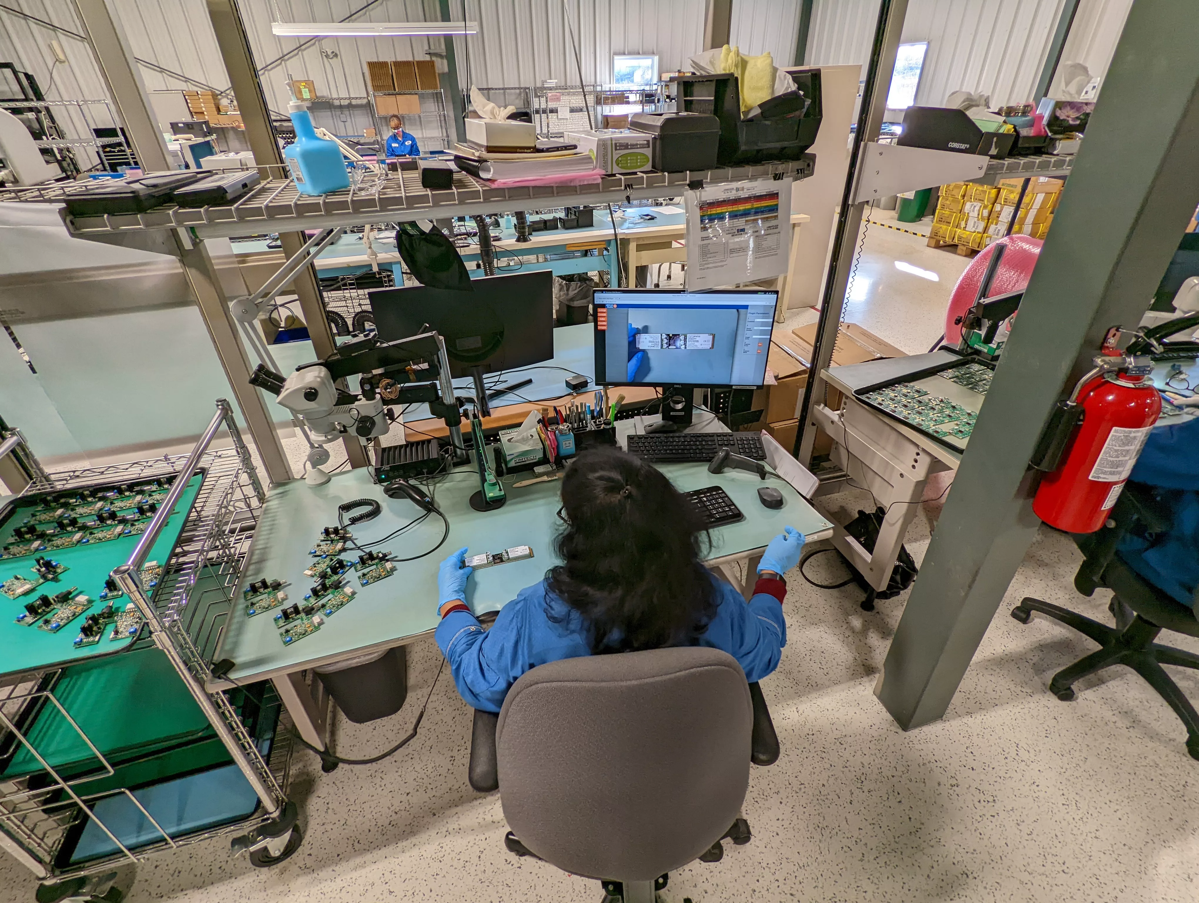

DICA provides high quality electronic assembly services for a diverse range of industries, including industrial controls, telecom, security, and digital imaging. The manufacturer uses Pleora’s Visual Inspection System to help operators detect errors often missed by automated optical inspection (AOI), such as incorrect components and orientation, solder defects, and through hole issues, as well as review of custom, low-run products where automation is too complex and expensive.
“Pleora’s Visual Inspection System provides a ‘second set of eyes’ for our human inspectors,” said Steve Vaughan, Vice President, Operations with DICA. “Human visual inspection is a key component of our manufacturing processes, and Pleora’s system helps our operators make consistent and reliable decisions to ensure we always deliver to the quality standards expected by our customers.”

With just one good image, Inspection apps for incoming, in-process, and final quality control steps automatically compare products to a “golden reference” and visually highlight differences and deviations for an operator. As the operator accepts or rejects potential errors, the AI model is transparently trained based on their decisions.
After even just one inspection, the AI model will start automatically suggesting a decision for the operator. Over time, the speed and accuracy of automated decision-making will improve as the system continuously learns from operator preferences. In comparison, most AI inspection tools require numerous good and bad images plus time-consuming and expensive algorithm development before they can be deployed in production.
