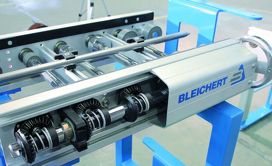

Engineered, built and installed by Bleichert Inc., the AL-25 conveyors use the same technology to meet two different requirements. One unit handles fully dressed, pallet-mounted engines in packages weighing up to 1,350 pounds. The other handles pallet-mounted instrument panels with a total package weight of only 80 pounds. The versatility to handle such a broad application range is designed into the conveyor’s roller drive mechanism.
One of the major advantages of the AL-25 is that the roller drive uses a friction clutch with adjustable tension. For light loads, the clutch tension is simply reduced. For heavier loads, it is increased. This capability gives the conveyor a broad application range.

The conveyor systems are modular, which minimizes engineering requirements and lead time. With the AL-25, the roller drives are designed in 1-meter increments, with rollers spaced at 3-1/2 inches and up in 1/2-inch increments, depending on the application.
Each roller is operated by a polymer bevel gear drive, which is powered by a modular drive shaft running the conveyor’s length. Torque from the drive shaft is transmitted to the bevel gear through a spring-loaded clutch. Clutch friction is adjustable in seven increments to match the load.
The drive motor can be positioned anywhere along the conveyor. It uses a gear reducer and timing belt to transmit power to the drive shaft. Each of the meter-long drive shaft sections is linked to the next one by a coupling to complete the modular drive system.
