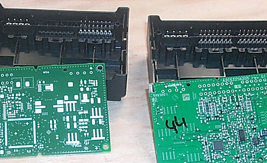

For the past few years, an automotive Tier 1 has used press-fit technology to assemble and test two types of PCB housings. One housing features a molded-in 16-pin connector with four power pins. The other housing has two 16-pin connectors and four power pins.
Assembly and testing is done in a semiautomatic workstation made by Schmidt Technology Corp. A worker places either housing (with PCB on top) onto a slide table, which transfers the housing to a nesting fixture. The PCB is positioned so the connector’s pins are properly aligned with the through-holes.
Upon cycle initiation, a camera takes a picture of the housing and PCB, and a scanner reads the PCB’s bar code. If the components are not compatible, a “not OK” message appears on an HMI and the fixture returns the housing to the slide table. If the components are compatible, the housing is uploaded to a 420 ServoPress and its ram presses the PCB onto the pins in 1.5 seconds.
After assembly, the camera performs pin height inspection to verify accuracy to within 0.003 inch. The completed housing is then transferred to an unload location. Total cycle time is 12 seconds. Bar code scanning enables complete product traceability.

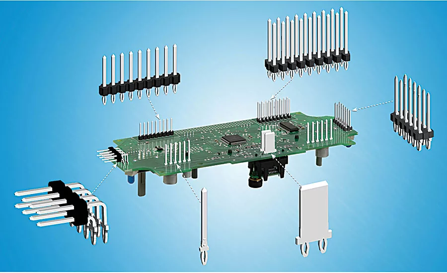

Press-fit pins are made of copper alloy, and each pin carries three to 50 amps. Originally, the pins were solid with a rectangular cross-section that deformed the through-hole during insertion. To combat the problem, suppliers developed compliant pins that are several thousandths of an inch greater than the diameter of the PCB hole but compress during insertion.
Once inserted, the pin expands and presses against the rigid sides of the hole to form a gastight joint. In addition, the joint’s high local pressure produces a cold weld effect that provides mechanical and electrical integrity.
The most popular compliant pin design is the “eye of the needle,” which features flexible beams on each side. Other compliant designs are the C-section and action pin. C-section pins are crescent-shaped and tapered so they expand or contract to contact the circumference of the through-hole. Action pins feature a split-beam design.
Besides preventing damage to the PCB, compliant pins provide spring force for retention and permit connector repairs. They also require lower insertion force than solid pins and allow multiple press-in cycles. Because of these benefits, compliant pins are generally preferred.
In certain high-temperature (above 125 C) applications, press-fit pins need to be plated for added durability. A tin-immersion or electroless-nickel plating is usually sufficient. However, the tin should be kept as thin as possible (1 micron) so it doesn’t scrape off when the pins are inserted.
“The most popular pin thicknesses are 0.64 and 0.81 millimeter, to fit into 1.016- and 1.486-millimeter holes, respectively” explains Lynch. “Factors that determine proper thickness include the pitch or density of pins within a connector, and pin-strength and current-carrying requirements. For example, applications that emphasize high mechanical strength or power, such as hybrid cars, require our Macro pins (1 and 1.2 millimeters thick). But, parts that need PCBs to quickly transfer data, are better off with our Micro or Mini pins (0.2 to 0.4 millimeter thick).”

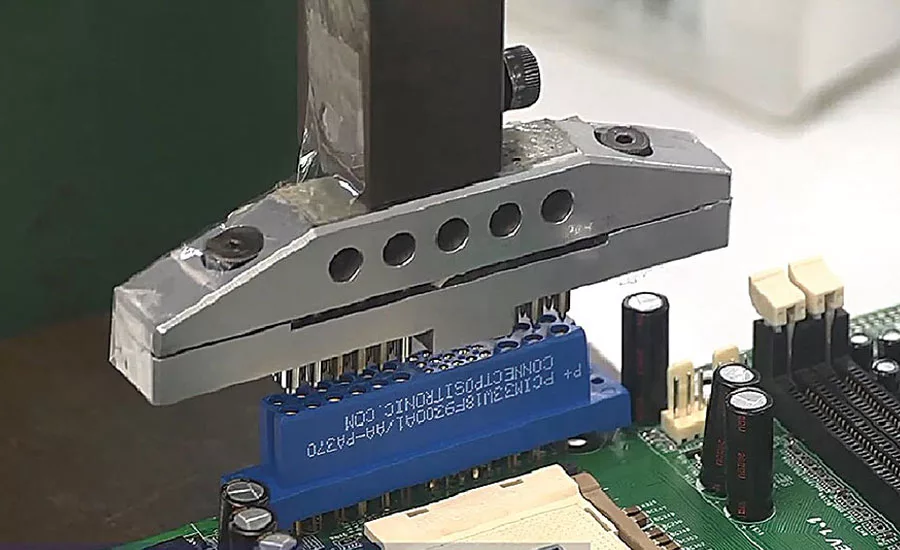

At its Dayton, OH, plant, Würth Elektronik ICS Inc. relies on several toggle and pneumatic presses from BalTec Corp. to insert press-fit pins and connectors. Workers there use presses with forces up to 56 kilonewtons to assemble PCBs of all sizes and shapes for agricultural equipment, fire trucks, golf carts and motor coaches.
Chuck Rupprecht, vice president and general manager for BalTec, says the company’s VK and L-VK series are frequently used for low-volume PCB assembly. The toggle presses offer force capacities from 5 to 12 kilonewtons. They also feature a square ram to prevent rotation.

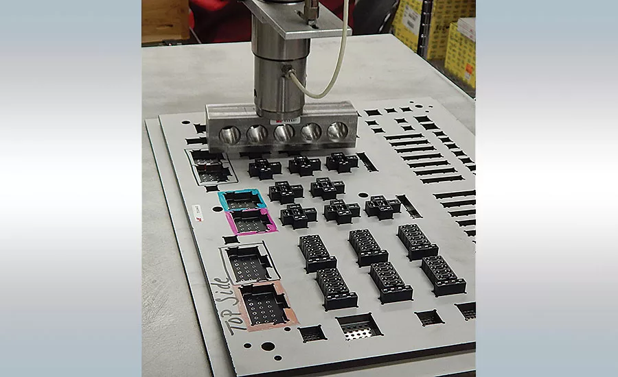

Connector suppliers often specify upper and lower tooling for each of their pin types or connectors. Most connectors, including right-angle models, can be inserted with flat-surface upper tooling. The lower tooling supports the PCB during pressing.
Some suppliers make connectors with holes at the top that expose the pin tops. Tooling protrusions fit into these top holes to lock with the connector and ensure that equal insertion force is applied to each pin during pressing.
To prevent board deformation, a distance of 0.5 to 1 millimeter should be maintained between the PCB and connector bottom during pressing. The connector’s plastic housing must also be strong enough to support the press force.
“Always make sure the press can provide enough force for the application,” recommends Rupprecht. “Let’s say that each pin might only need a few pounds of insertion force. But, if there are more than 100 pins in a connector, it probably needs about 500 pounds of force. And if the application calls for multiple connectors to be inserted simultaneously, you might need a press with 1,000 or 2,000 pounds of force.”
