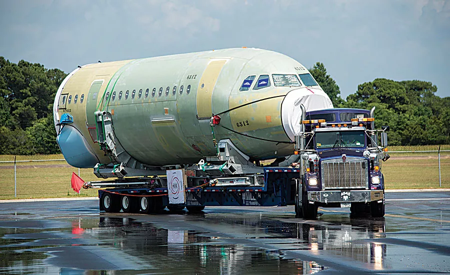

Fuselages and wings are transported from the dock to the plant by truck. Photo courtesy Airbus

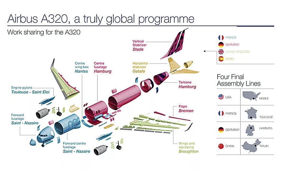

Major subassemblies are loaded onto a cargo ship in Hamburg for the 20-day journey to the Port of Mobile, which is located just three miles from the new factory. Fuselages and wings are transported to the new plant by truck.
The components are assembled at different Airbus factories in Europe. The front fuselage, including the cockpit, is built in France. The wings are produced in England. The rear fuselage is built in Germany, and the vertical tail plane is made in Spain.

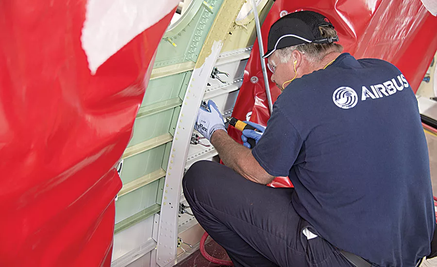

One new assembly process is used to attach the wings to the fuselage of the A320. The Mobile plant features a state-of-the-art automatic drilling machine. It replaces a manual process used at other Airbus factories to drill more than 2,000 holes.
“We have arranged tooling and jigs in an optimal way to minimize distances between workstations,” explains Weber. “The latest ergonomic improvements have been considered to achieve the highest health and safety standard for assemblers.
“Sequenced kitting is used to ensure just-in-time delivery of fasteners and other parts,” says Weber. “We also use paperless work instructions throughout the assembly line.”

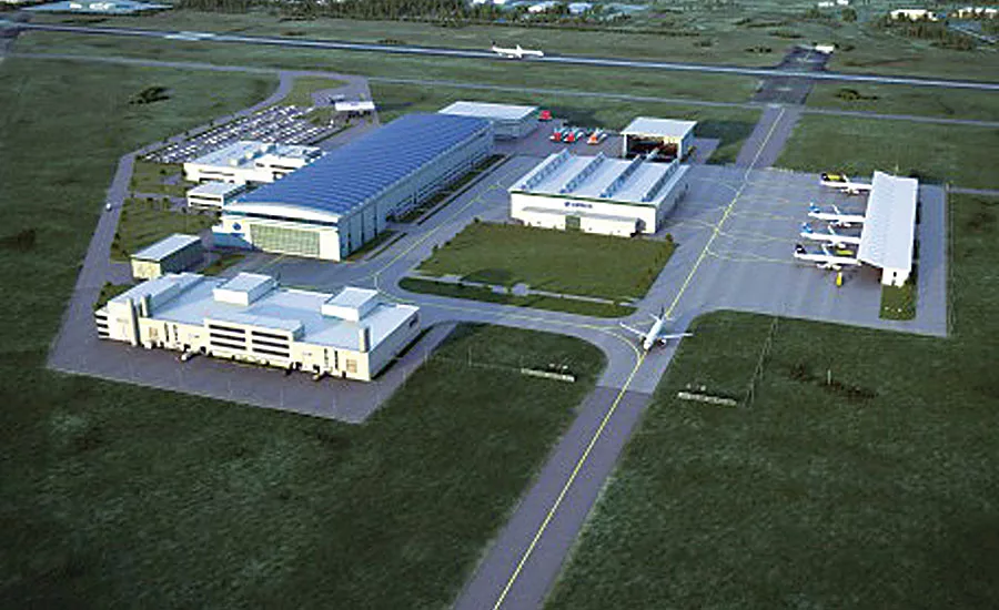

The 116-acre complex features several buildings, including offices, a transshipment hangar, a paint shop, a gauging hangar, a final phase hangar and a customer delivery center.

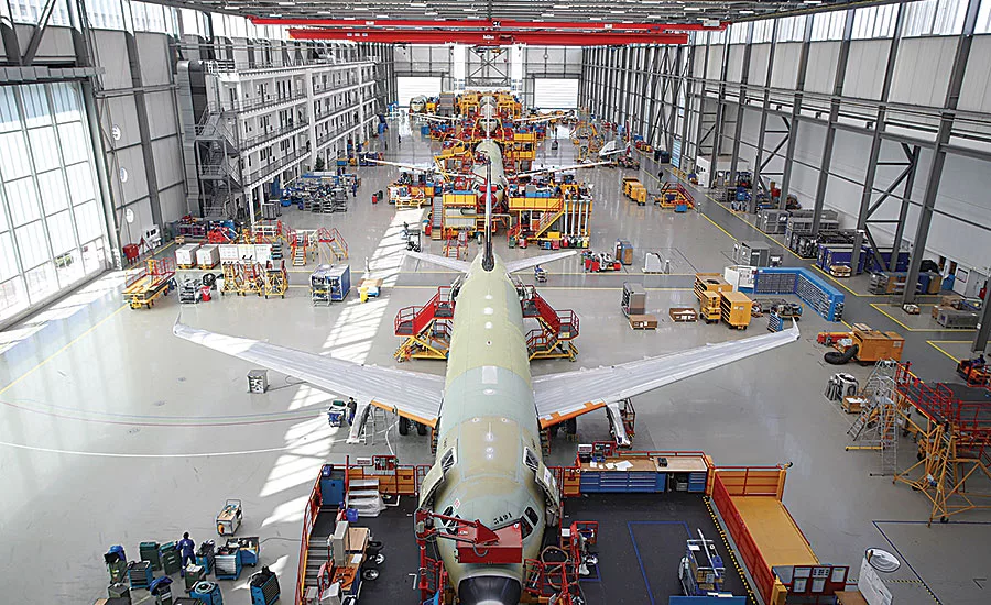

However, the largest building in Mobile is the 209,917-square-foot final assembly line (FAL), which can accommodate five aircraft at a time. It is a carbon copy of Hangar 9 at the Airbus factory in Hamburg.
Airbus engineers worked with systems integrator Comau Aerospace to develop assembly and test stations at the Mobile plant, including all jigs and tools.
“The assembly and test stations include the large steel fixtures that surround and hold the aircraft sections as they are assembled, allow [operators] to access the assemblies, and house the tooling and automatic drilling units used to put the aircraft together,” says Michel Pages, program manager at Comau LLC.

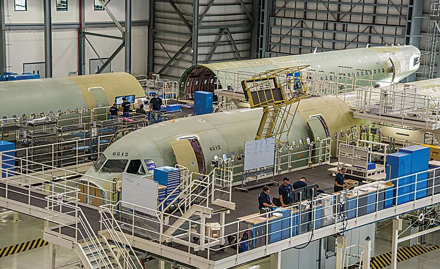

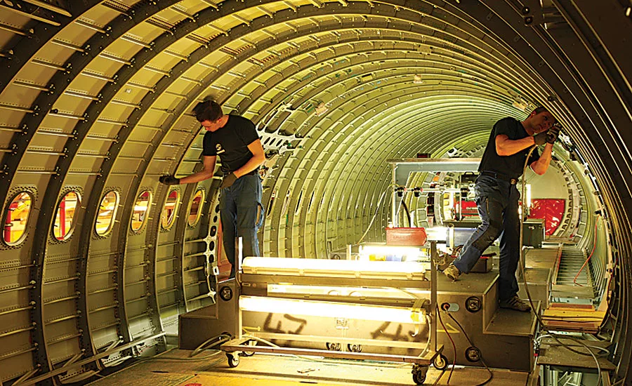

The 836-foot long FAL is divided into four workstations. The first area, known as Station 41, is where the forward and aft sections of the fuselage are joined together. The assembly process requires approximately 3,000 rivets, which are manually installed with air tools.
“This is also where we install ‘monuments,’ such as galleys and lavatories,” says Weber. “These items are too big to fit through an aircraft door, so we can’t install them after the entire fuselage is assembled.”
Station 40 is where the wings and the fuselage are joined. Assemblers on a parallel line attach winglets before the wings are joined with the fuselage. Landing gear and engine pylons are also installed here.
“All electrical and hydraulic systems are installed and connected at this workstation,” notes Weber. “And, we add power to the aircraft here so that we can begin to perform various functional tests.”
At Station 35, horizontal and vertical tail planes are attached to the fuselage. Auxiliary power units are installed and full power up of the aircraft occurs. The nose cone and radome are also installed.
“We also start installing the interior of the cabin, such as sidewall panels and linings, at this workstation,” explains Weber. “And, we furnish the cockpit.”

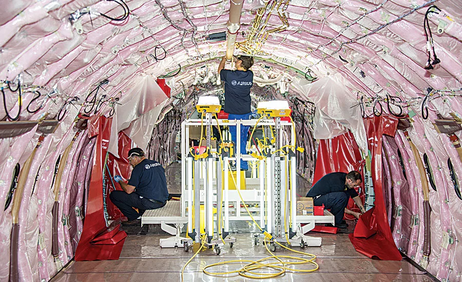

The final station inside the FAL is called the dock. That’s where lighting, in-flight entertainment and cabin pressurization systems are installed and tested.
“Final cabin install occurs here, including carpeting, overhead storage bins, seats and partitions,” says Weber. “Engineers also perform extensive testing of all cabin systems and landing gear.”
The FAL workstation numbering system does not follow chronological order, because various steps in the production process have been streamlined.
