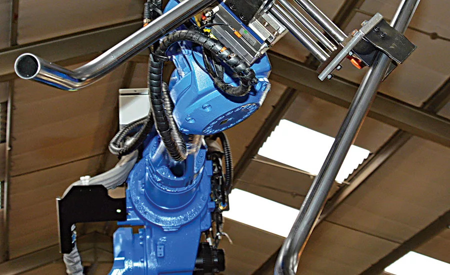

After the tube is bent to the proper shape, it is removed by the robotic handler and placed on a multiple-level rack. Photo courtesy Unison Ltd.

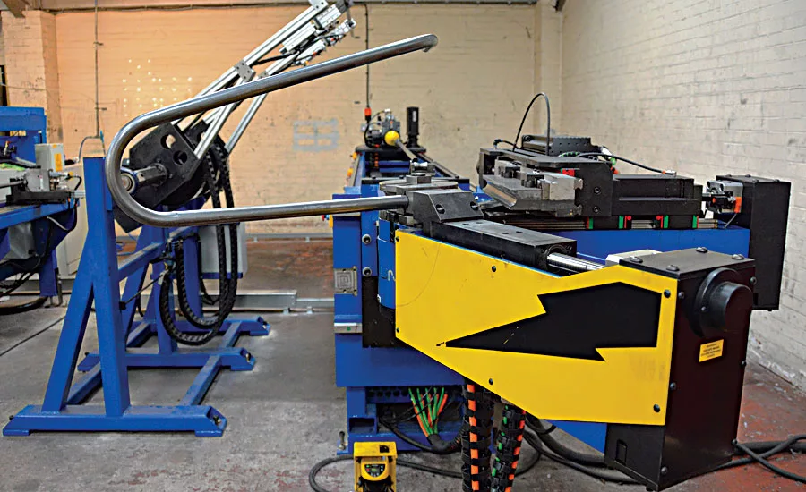

Within the cell is a tube bundle loader, a tube-orientation station, an intermediate dual-arm loader, a bending machine and a five-axis articulated robotic handler. The cell performs five processes, all of which are controlled by a central PC.
After the cell operator fills the bundle loader’s hopper and selects the operating program, he presses a button to activate the loader. It then feeds tubes individually to the tube-orientation station, which detects the weld seam and rotates the tube to the optimum position for bending. Next, the intermediate loader transfers the tube to the bending machine. After the tube is bent to the proper shape, it is removed by the robotic handler and placed on a multiple-row rack. From there, the tube is moved to other stations for hole punching and powder coating.
“This [cell] has multiple advantages, including better process consistency, higher throughput, much lower energy costs and reduced need for skilled operators,” explains Thacker. “Because [BiaB] products are designed for easy assembly, the frame parts need to be bent very accurately, with precision placement of the various bolt fixing holes. The cell’s tube-orientation station ensures that frames are bent in such a manner that holes are never punched through tube weld seams. This also helps with process consistency, because the seam affects the spring-back characteristics of the tube during bending.”
