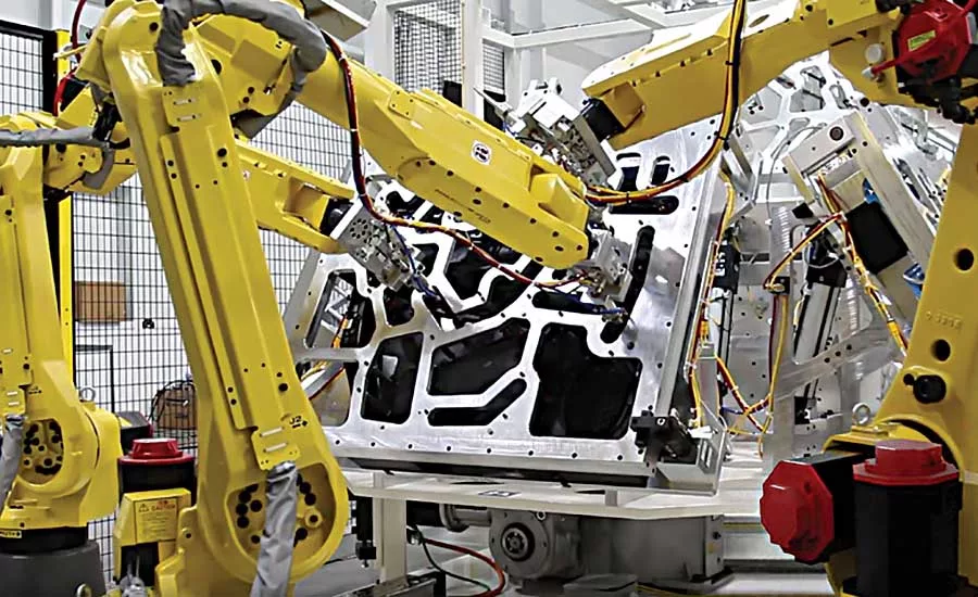

Three floor-mounted robots do work on each interior door assembly, which is moved into position on a rotary indexer. Photo courtesy Destaco

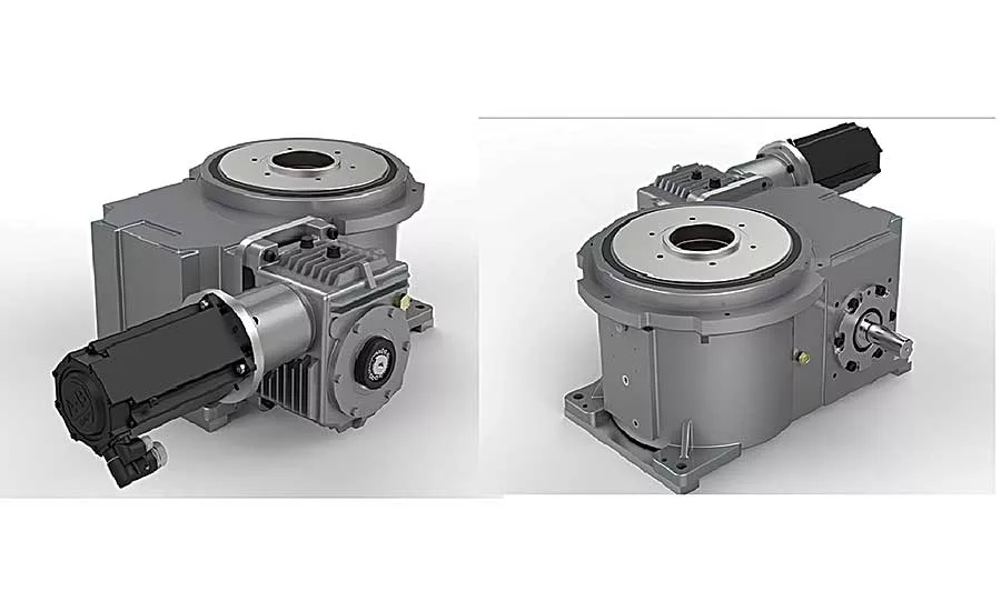

CG Automation and Fixture uses a servo-actuated CAMCO 1301RD rotary indexer in its system that makes interior door assemblies. Photos courtesy Destaco

In late 2015, CGAF began working with a Detroit-based Tier 1 supplier that makes large interior door assemblies for two popular midsize SUVs. The supplier asked CGAF to design a system that quickens robotic work on these door assemblies—and then provide and install 13 models of that system, including nine within only seven weeks. A short time later, CGAF engineers came up with a system that features a large four-station indexer (7-foot radius, 3,200-pound payload capacity) and three floor-mounted robots.
System operation begins after workers manually place type A and type B door assemblies in opposite stations of the indexer. The robots insert retaining clips and perform riveting work on one type A door
before the indexer rotates 180 degrees to present the other type A door to the robots. Then the indexer is rotated 90 degrees and the type B doors are worked on following a similar process. After this, workers manually remove the door assemblies and place four more on the indexer.

For this application, Destaco engineers recommended CGAF use a servo-actuated CAMCO 1301RD indexer, customized to meet the application’s payload, speed and output requirements. The 1301RD combines the benefits of an indexer—including a preloaded drive with no internal backlash, large face mounting, high-capacity bearings and rigid housing—with the advantages of a servo. It quickly changes motion, and offers precise control, computerized monitoring and fast tool change with no downtime.
The indexer has a maximum torque of 47,861 in-lbs, making it ideal for medium- to high-torque applications. A center through hole facilitates passage of electrical wiring, pneumatic lines or mechanical linkages. Destaco engineers customized the indexer in several ways, including lessening its tooling weight through finite element analysis.
