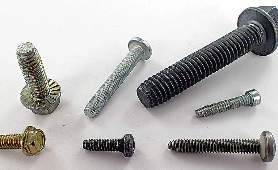

Subtle (but Important) Distinctions
Thread-cutting, thread-rolling, and thread-forming screws have a similar composition. They are made of carbon or stainless steel or aluminum, and have tensile strengths of at least 100,000 psi, with relatively high torsional strengths. The screws can feature any drive head design and be used in a wide range of materials.
On each screw shank is an asymmetrical thread that produces opposing forces during installation to create mating threads. Because these threads match the dimensions of the installed screw, there is no play between the material and screw, resulting in a dynamically safe joint. Coarse and fine threads are available, with the former recommended for weak materials.
What differentiates these screws is how they treat the material. A thread-cutting screw has a shank slotted point that cuts the material and forms the thread as it is driven down, producing chips that fall out of the hole. The shank slot minimizes chip production. Some screws feature a drill-like fluted point that is designed to penetrate hard substrates.
These screws are often used in wood, metal and plastic products that need periodic maintenance, such as outdoor bench seating and power tools. For plastic applications, the screws perform best in thermoset materials having a flexural modulus from 500,000 to 2 million psi.
Thread-rolling screws were introduced in the 1960s as a non-chip alternative to thread-cutting screws for sheet-metal applications, according to Simpson. They have a tapered lead and require that the fastener be harder than the mating material. During installation, the fastener roll forms the mating material into the thread shape.
Manufacturers in many industries select these screws because they prevent cross-threading, resist vibration and are reusable. Another appeal is versatility. The screws can be used in aluminum, magnesium and plastic, as well as sheet metal, and some suppliers offer thread-rolling bolts.

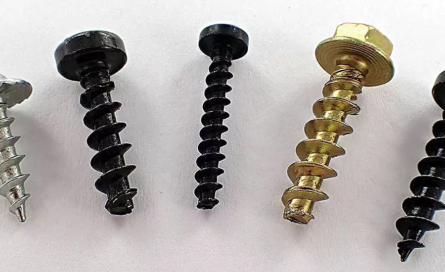

Thread-forming screws create threads in a similar manner, although they tend to shape material more quickly and efficiently. These screws feature a blunt end, may or not require a preformed hole, and are generally used in sheet metal, plastic and composite parts that require high clamp loads to resist loosening. Some screws can be removed and reinstalled multiple times, or replaced with standard metric machine screws.
The biggest users of thread-forming screws are manufacturers in industries that use a lot of high-performance thermoplastics, such as electronics, automotive, agriculture and office equipment. In these applications, the material has a flexural modulus from 150,000 to 400,000 psi. White goods and furniture manufacturers also frequently use thread-forming screws.

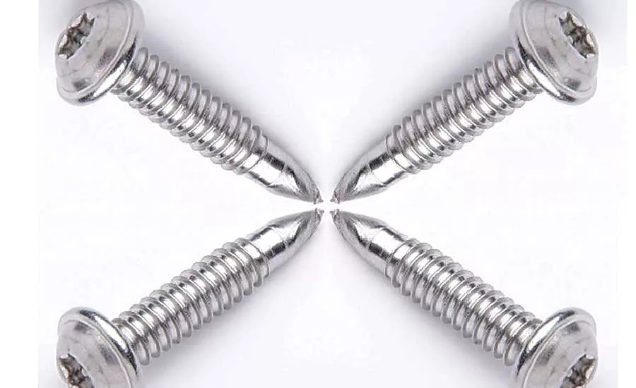

Both the Rolok thread-rolling and Polyfast thread-forming screws from Semblex are available with and without a cutting edge. The Rolok thread features three asymmetrical lobes that form mating threads in the nut member. This design provides high performance through low drive torque and high strip-out torque in a wide range of materials and configurations, like c-shaped extrusions.
Polyfast screws have 45-degree asymmetrical threads, providing a narrow shank and a 26-degree point. The wide-angle thread slices cleanly through material with minimal material distortion and splitting, while the shank requires low installation torque and high strip out torque, and the point eases installation.

A common, but too-often ignored problem related to installing thread-forming screws in thermoplastic is plasticization or softening of the material. This is particularly applicable when installing fasteners with systems that run at 1,000 rpm and higher. Plasticization gives the appearance that a torque-controlled system is installing a screw correctly at, say, 20 in-lbs, but a phenomenon called joint relaxation can soon follow. Within a matter of seconds, minutes or hours, it can make initial torque in the joint fall off dramatically; sometimes by up to 50 percent (to 10 in-lbs net, in this example).
Graham says the problem of plasticization is equally challenging for value added molding companies that install screws into parts that are warm and just out of a mold. Aware of this, some manufacturers use fasteners with a double-helix (high-low) thread where the high thread is sharper than a conventional one. This design traps more material between the threads, increasing stripping torque and allowing for a lower prevailing torque during the driving process.

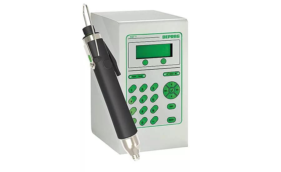

Sometimes it’s not easy to determine the installation problem related to thread-forming or thread-cutting screws. Cecil Morgan, applications engineer at DEPRAG Inc., cites a recent example of a major medical equipment manufacturer that was experiencing a high failure rate of stainless steel thread-forming fasteners used in aluminum parts. The problem was the screws were not fully seated, resulting in reworking the joints.
Initial testing revealed inconsistent friction torque levels. Some joints had a higher level than the specified tightening torque, while others only reached 40 percent of tightening torque. With further analysis, the manufacturer noticed slightly inconsistent hole diameters in the parts and inconsistent amounts of threadlocker on the fasteners.
To overcome these problems, the company began using DEPRAG’s Minimat EC stationary electric screwdrivers with the AST11 Controller. A software routine in the controller, the “Friction Torque Value Procedure,” calculates friction torque during fastener installation and applies consistent clamp load to the joint.
The company also offers the AST40 controller with Clamp Force Control (CFC) for its Minimat EC-Servo screwdrivers. CFC is an adaptive technology that eliminates all frictional influences up until the point of head seating, thereby ensuring the fastener provides consistent clamp force.

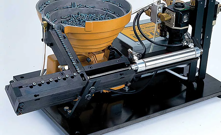

Simpson says that feeding these screws is often a challenge, especially those with contoured heads and short lengths. His recommendation is to use designs with defined side walls, like pan-head screws, whenever possible. Another challenge is convincing customers of the need to focus more on total assembly cost than the component cost—as well as working closely with their fastener supplier throughout the entire fastener selection process, including joint design.

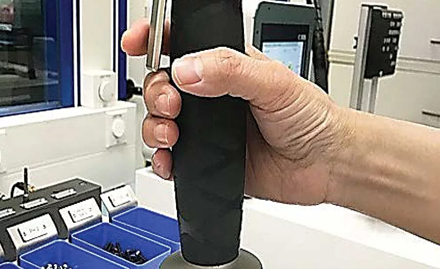

By pairing Weber’s C30S advanced process controller with motor drive and transducer packages, engineers can install and verify thread-rolling and thread-cutting fasteners in core holes in injection moldings, castings, extrusions, and multimaterial stacks requiring from 0.01 to 60 newton-meters of torque.
The controller allows up to 31 different tightening recipes or strategies to be programmed to best accommodate any given joint configuration. Torque, angle, and native analog depth auditing is possible, and numerous communication or bus interfaces ensure compatibility with most plant communication and MES systems.
Frequently used with the C30S controller is the HET series of handheld electric screwdrivers that provide 0.1 to 30 newton-meters of torque. The screwdrivers can be used for installation and joint auditing, and they have the ability to log and graph joint data when installing and removing fasteners, for higher levels of quality control.
