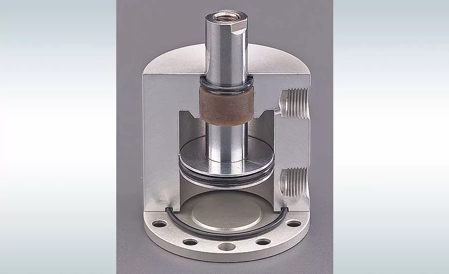

Fabco-Air’s Pancake cylinder is available with bore sizes ranging from 0.5 to 4 inches and standard strokes ranging from 0.0625 to 4 inches. Photo courtesy Fabco-Air Inc.

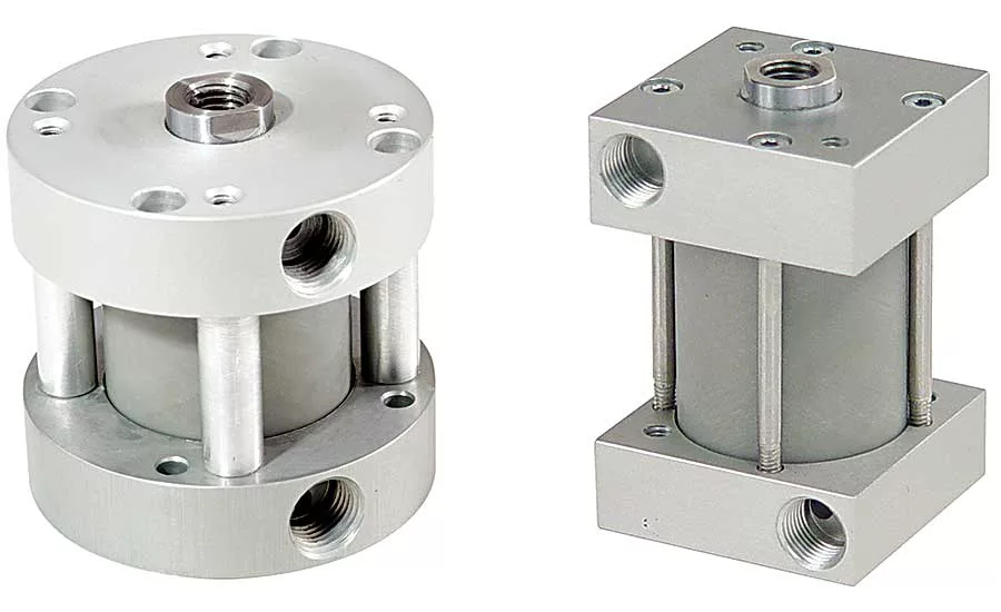

Compact cylinders are also available in a conventional tie-rod-and-spacer configuration, with round, square and extruded body designs. Photo courtesy Fabco-Air Inc.

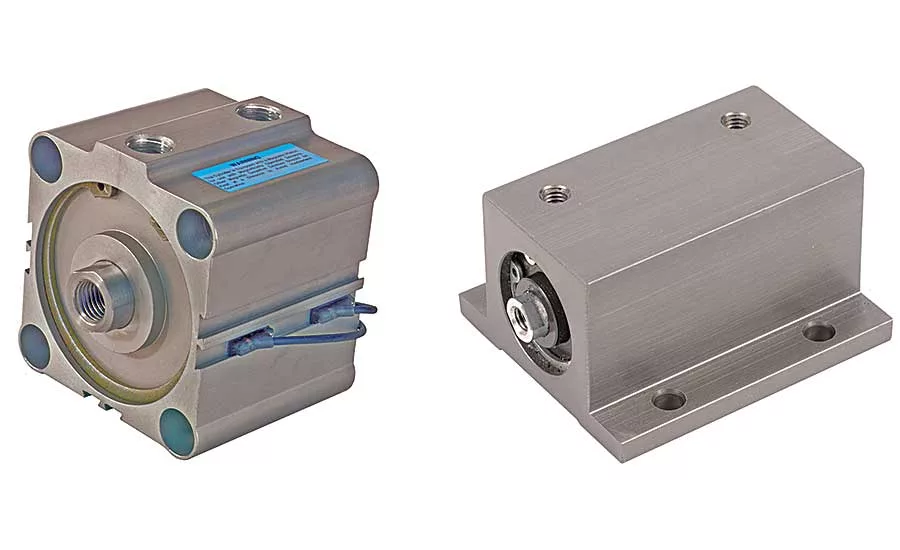

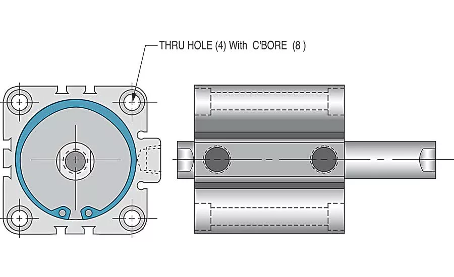

Through-hole mounting is available on many short-stroke cylinders. In this case, counterbored holes are drilled through the cylinder body for easy mounting with socket-head cap screws. Photo courtesy Fabco-Air Inc.

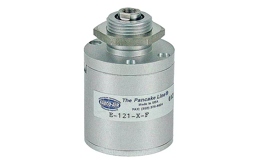

With the nose-mounting option, engineers can attach the front of the cylinder to the machine. Photo courtesy Fabco-Air Inc.

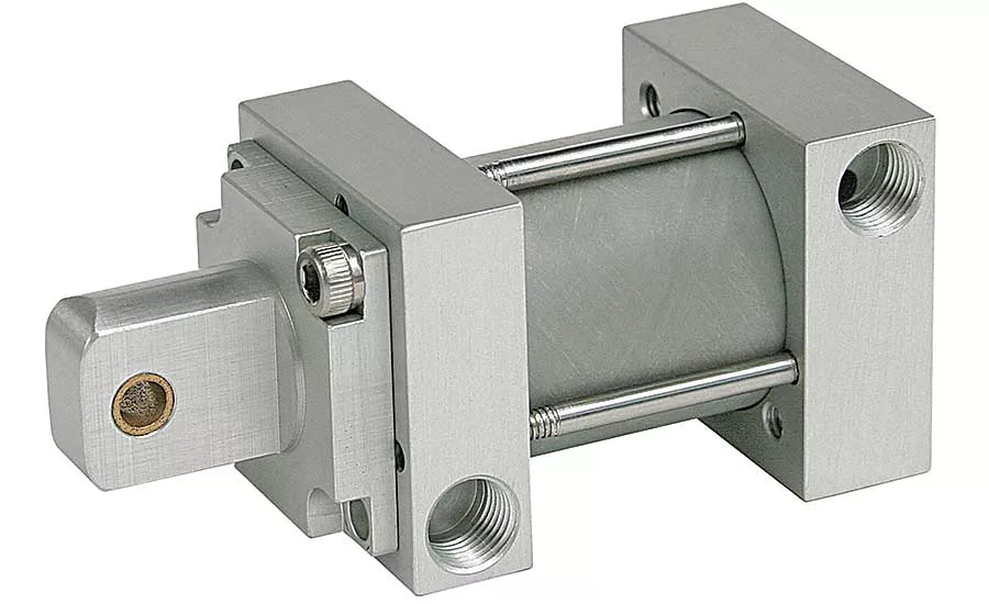

Pivot-mounting enables the cylinder to pivot through an arc. Eye and clevis mounts, as well as trunnion mounts, are available on many compact cylinder models. Photo courtesy Fabco-Air Inc.

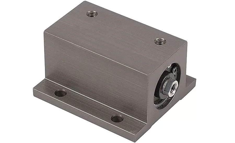

Compact Pneumatic Cylinders Can Play Big Roles in Automation
In some cases, non-centerline mounting may be less rigid than other mounting options. Because the plane of the mounting surface is not through the centerline of the cylinder, a bending moment is created around the mounting points. Nonetheless, side-lug cylinders are sometimes the perfect solution for unique applications. Photo courtesy Fabco-Air Inc.

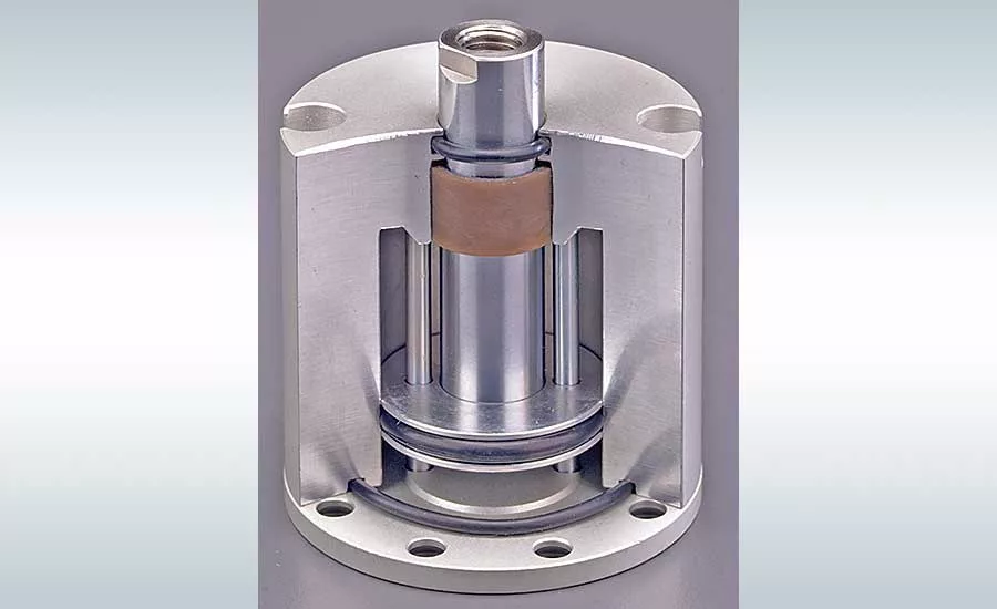

Maintaining the rod’s fixed orientation can be accomplished in several ways. Internal guide pins are one option for double-acting, singlerod cylinders. Two guide pins incorporated inside the cylinder pass through the piston head. These guide pins prevent rotation of the rod with a usual tolerance of ±1 degree. Photo courtesy Fabco-Air Inc.

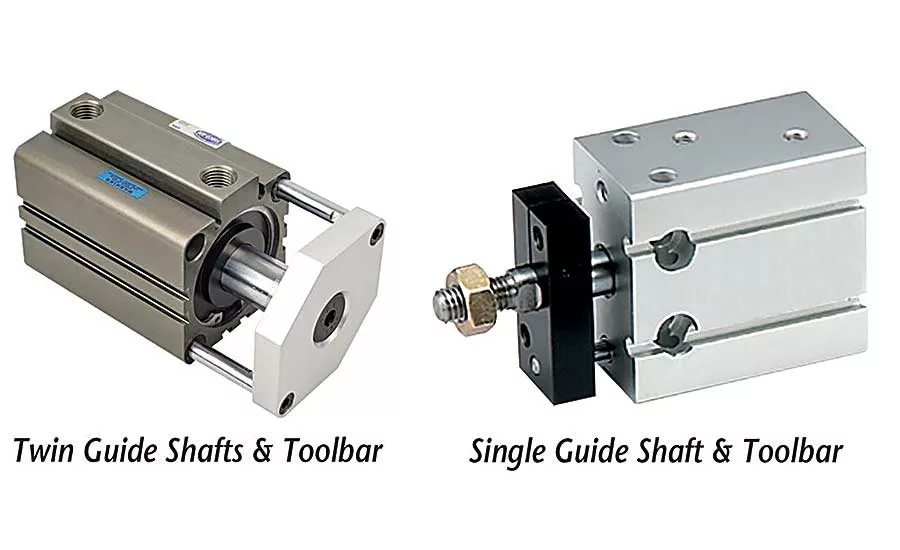

Another anti-rotation option is to use an external guide block securely attached to the piston rod. One or two steel guide shafts, attached to the guide block, assure anti-rotation of usually less than 0.8 degree. Photo courtesy Fabco-Air Inc.

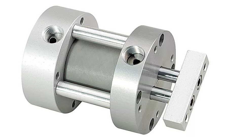

One more option to prevent rotation is to incorporate twin piston rods into the cylinder head. The rods are securely fastened to the piston and tied together externally by a tool bar at the ends of the rods. The tooling plate ensures that the rods move in tandem and provides an ideal mounting surface for attachments. Photo courtesy Fabco-Air Inc.

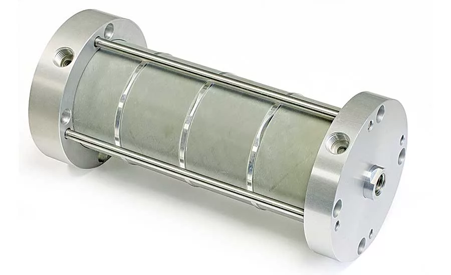

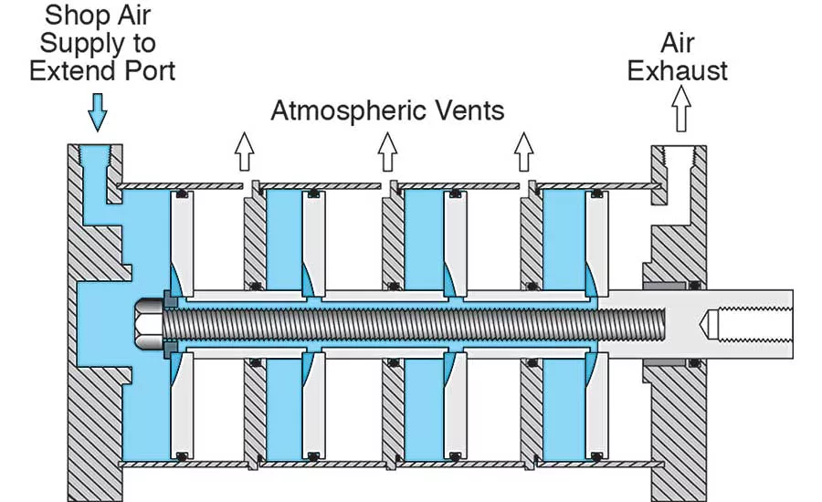

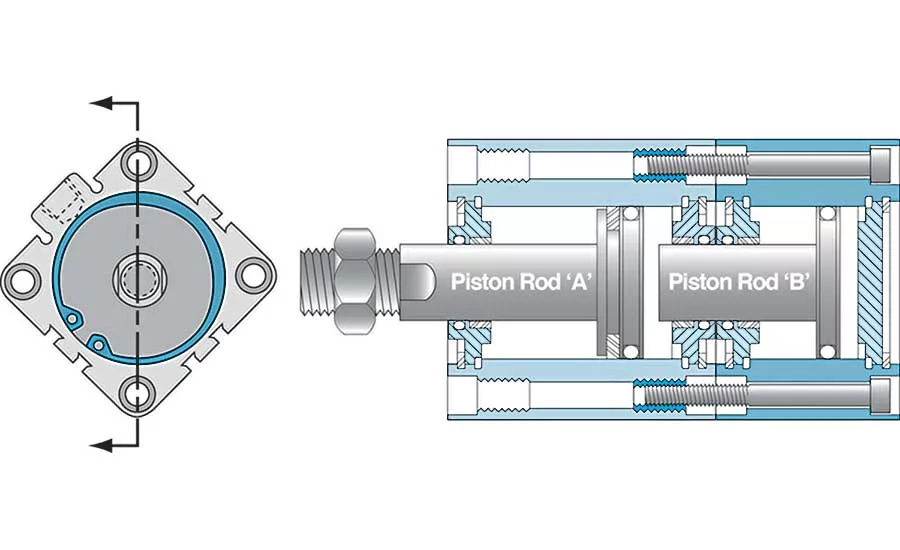

Multiple pistons are used to increase the thrust force of the cylinder. Multipiston cylinders provide the same output force as single-piston cylinders with much larger bores. Higher forces can be achieved in tight spaces vs. larger bore cylinders, which require a larger footprint and a wider center-tocenter space when more than one cylinder is required. Photo courtesy Fabco-Air Inc.
This setup provides three stroke positions. Two cylinder bodies are coupled end-to-end. The piston rod of the rear cylinder extends through the cap end and can push the piston of the front cylinder. In position 1, both pistons are retracted. To get position 2, the piston rod of the rear cylinder extends, moving the front cylinder’s piston rod partially forward. Position 3 is reached when the front cylinder’s piston rod is fully extended. Photo courtesy Fabco-Air Inc.

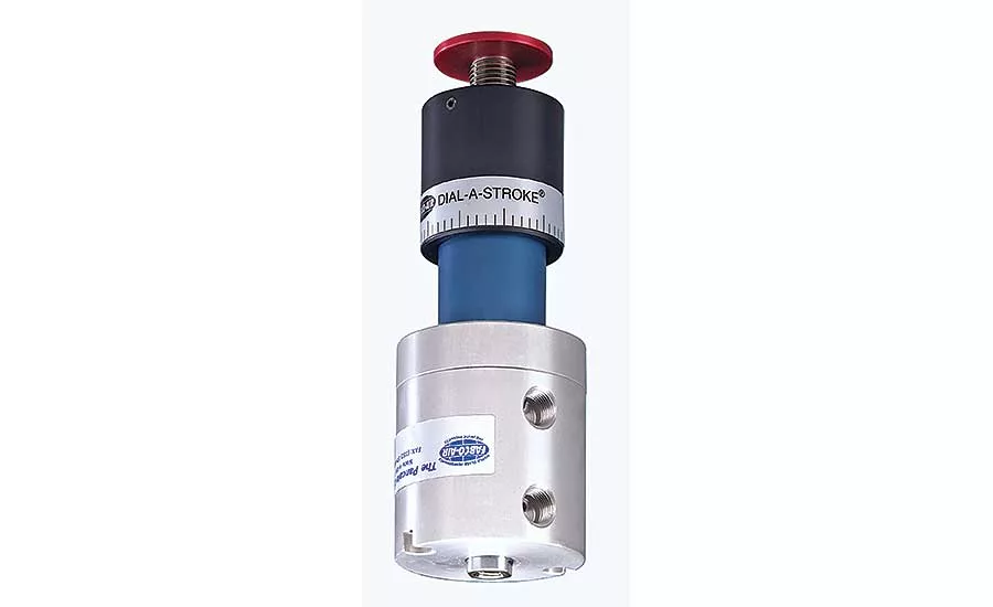

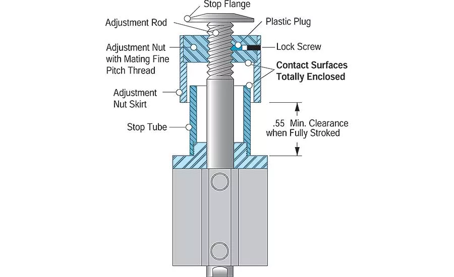

Fabco-Air’s Dial-a-Stroke option allows engineers to precisely adjust the extend stroke of the cylinder. The stop tube, adjustment nut with skirt, and minimum clearances combine to eliminate pinch points, ensuring operator safety. Photo courtesy Fabco-Air Inc.

Today, compact pneumatic cylinders are the primary mechanism for linear actuation when space is limited. Frequently referenced as short-stroke cylinders, these devices are available with bore sizes ranging from 0.5 to 4 inches and standard strokes ranging from 0.0625 to 4 inches.
The original Pancake has a bored body design. Today, compact cylinders are also offered in a conventional tie-rod-and-spacer configuration, with round, square and extruded body designs.

Through-hole mounting is available on many short-stroke cylinder models. In this case, counterbored holes are drilled through the cylinder body for easy mounting with socket head cap screws. Nose mounts as well as front and rear flange mounts are also offered on a variety of compact cylinder styles.
Non-centerline mounting is generally quite rugged, but in some cases, may be less rigid than other mounting options. Because the plane of the mounting surface is not through the centerline of the cylinder, a bending moment is created around the mounting points. Nonetheless, side lug and foot-mounted compact air cylinders are sometimes the perfect solution for unique applications.

For applications in which anti-rotation and registration are critical, nonrotating cylinder designs are available. However, keep in mind that nonrotating options on compact, short-stroke cylinders are for light torsional handling and registration only.
Maintaining the rod’s fixed orientation can be accomplished in several ways. Internal guide pins are one option for double-acting, single-rod cylinders. Two guide pins incorporated inside the cylinder pass through the piston head. These guide pins prevent rotation of the rod with a usual tolerance of ±1 degree. A rubber disk is included at the end of each guide pin to take up end play and firmly seat the pins in the guide holes.
Another option is to use an external guide block securely attached to the piston rod. One or two steel guide shafts, attached to the guide block, assure anti-rotation of usually less than 0.8 degree.
One more option to prevent rotation is to incorporate twin piston rods into the cylinder head. The rods are securely fastened to the piston and tied together externally by a tool bar at the ends of the rods. The tooling plate ensures that the rods move in tandem and provides an ideal mounting surface for attachments required by your application. Tool bars are sometimes furnished with threaded mounting holes or counterbored mounting holes.
Multiple Pistons, Multiple Positions
Multiple pistons are used to increase the thrust force of the cylinder. Multipiston cylinders provide the same output force as single-piston cylinders with much larger bores. Higher forces can be achieved in tight spaces vs. larger bore cylinders, which require a larger footprint and a wider center-to-center space when more than one cylinder is required.
If the application requires a compact cylinder with intermediate load positions, there are options are available. Three or more rod positions can be achieved with a single cylinder.
The most popular is the three-position configuration. In this design, two cylinder bodies are coupled end-to-end using two socket-head cap screws. The piston rod of the rear cylinder extends through the cap end and can push the piston of the front cylinder. In position 1, both pistons are retracted. To get position 2, the piston rod of the rear cylinder extends, moving the front cylinder’s piston rod partially forward. Position 3 is reached when the front cylinder’s piston rod is fully extended. To get three discrete positions with this arrangement, the front cylinder’s piston rod must be longer than the rear cylinder’s piston rod.

Stroke adjustment is another popular option for cylinders. Cylinders can be equipped so that engineers can adjust both the extend and retract strokes.
For example, Fabco-Air’s Dial-a-Stroke option allows engineers to precisely adjust the extend stroke of the cylinder. The stop tube, adjustment nut with skirt, and minimum clearances combine to eliminate pinch points, ensuring operator safety.
For the opposite direction, a screw with a thread-sealing locknut mounted in the rear cover provides simple, rugged and precise means of adjusting the retract stroke of the cylinder. The stroke stops when the piston contacts the end of the screw. The fine thread of the adjusting screw provides precision adjustment.
