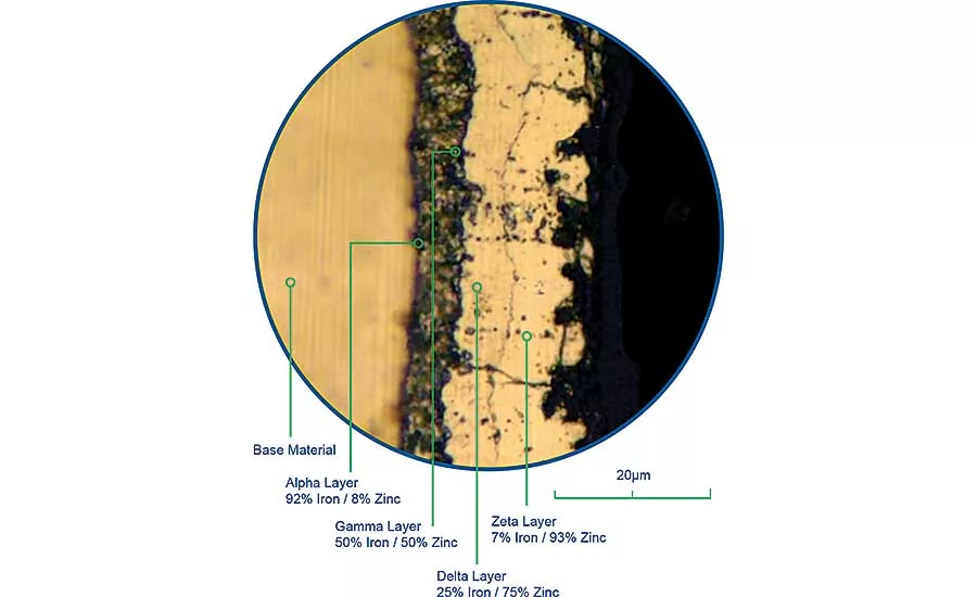

The image below demonstrates the layered structure of ArmorGalv®. Maximum percentages of zinc occur at the surface with the percent iron increasing with depth (20 microns average coating thickness is applied to SPIROL fasteners):

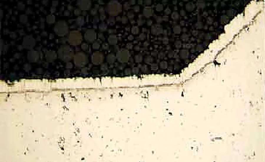

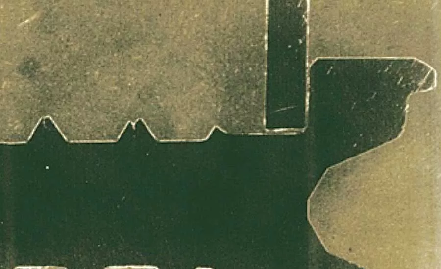

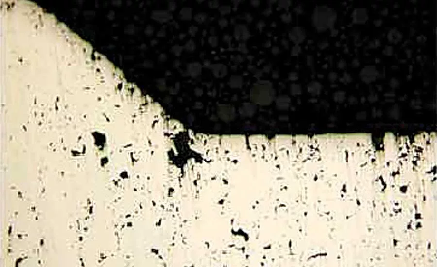

Uniformity of deposition is visible in the following photographs. Note coverage of all surfaces including peaks, valleys, corners, and gaps:
  • Fastener and washer with ArmorGalv® coating)
  • A closer cross-section with thicker deposition for clarity in the two images below:
  • Powder Metal Parts Before ArmorGalv®
  • Powder Metal Parts After ArmorGalv® (100 microns / 4mils))
