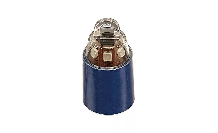

Among SEL’s most popular products are fault indicators used on transformers, switchgear, sectionalizing cabinets, junction boxes and splices. A few years ago, the company faced a challenge when welding a clear lens display screen to the polycarbonate (Makrolon 2607) body of one of its indicators.
Because this indicator is used in harsh, submersed and corrosive environments, its housing requires a hermitic seal. This seal is created through ultrasonic welding and then tested to make sure it withstands a temperature from -40 to 65 C. Unfortunately, the pneumatic welding process SEL was using produced non-hermetic seals.
This led the company to conduct a series of welding experiments over a three-year period, according to Rick Lewis, manufacturing engineering supervisor at Schweitzer. The results always indicated the welding process produced high collapsing speeds and very short weld times. Eventually, SEL engineers decided to redesign the plastic injection molds so the housings had a flatter welding surface—and to have ultrasonic welding supplier Dukane Corp. test the parts at an applications lab in St. Charles, IL.
There, the parts were welded with a 20-kilohertz-frequency iQ Series servo-controlled welder. The tests showed that the part was acting like a spring because of a hollow area under the weld zone, and that it was collapsing faster than the horn movement. This resulted in inconsistent and leaking welds. To overcome these problems, Dukane specialists decided to vary weld speeds.

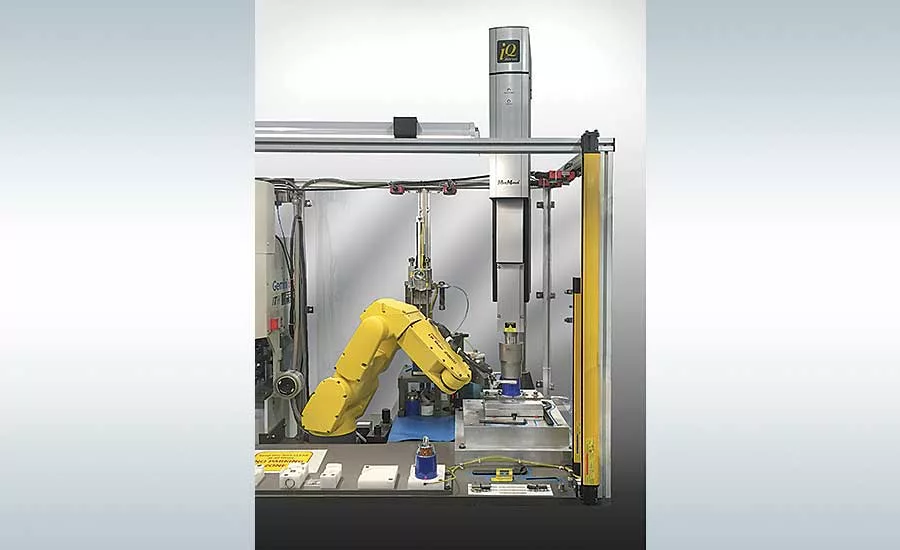

Impressed with the lab test results, SEL purchased an iQ welder and
integrated it into the robotic assembly cell for the fault indicators. Lewis says the welder works flawlessly.
“Its repeatability and graphing functions make it easier to set up new welding programs,” concludes Lewis. “The welder [also] reduces the engineering time and the number of scrap parts required to set up a new welding process.”
