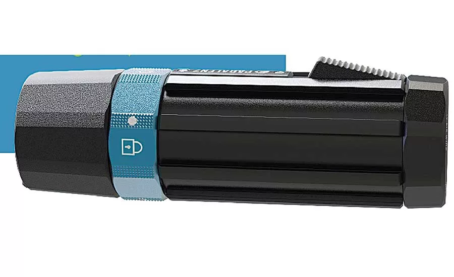

Divers can capture ultra-high-resolution photos or video underwater with the Paralenz Dive Camera. Photo courtesy Paralenz ApS

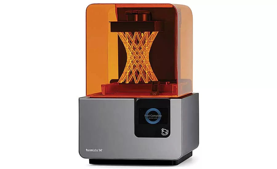

The Form 2 printer produces smooth 3D parts for high-quality prototypes. Photo courtesy Formlabs Inc.

Since 1975, the movie Jaws has made millions of people hesitant about swimming in deep water. Just as many others, though, remain committed to diving and exploring the scenic depths of seas and oceans worldwide. This latter group is the reason Paralenz ApS recently introduced its Paralenz Dive Camera for taking selfies and recording video underwater.

In 2016, at the suggestion of a diver colleague, Trost spent several months developing several designs of a small, affordable action camera for divers. Shortly thereafter, Paralenz purchased a Form 2 stereolithography (SLA) 3D printer from Formlabs Inc. to build various prototypes.
“This printer saves us man hours because [parts just need to be] cleaned, sanded and painted,” notes Trost. “FDM (fused deposition modeling) machines take about three times as long to get a high-end finish, and with a lot of parts, you cannot even get the same finish, regardless of the amount of work.”
Cost-effectiveness and reliability are the printer’s other main benefits, according to Trost. For this project alone, he estimates that the company would have had to pay a third-party contractor $15,000 for the required SLA parts. Printing the parts in-house cost less than one-third of that. As for reliability, Trost notes that, in the past, workers would often run three 3D printing machines to make sure that one would be able to complete a project. The new printer also rarely produces unusable parts.

After finalizing design and beginning production, Paralenz brought the camera to market last June. It is waterproof to 656 feet and captures ultra-high-resolution photos or video at a rate of 30 frames per second. A built-in depth sensor autocorrects image or video color based on the person’s current depth.
