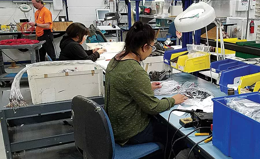

AIM workers build and test wire harnesses and cable assemblies on boards made in-house. Photo courtesy Advanced Interconnect Manufacturing

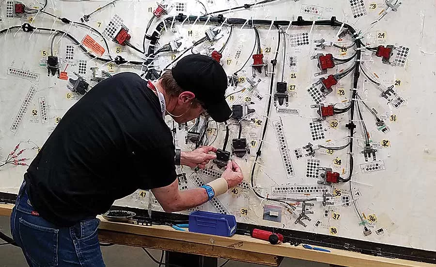

Manual subassembly work is performed at benches by several AIM workers. Photo courtesy Advanced Interconnect Manufacturing

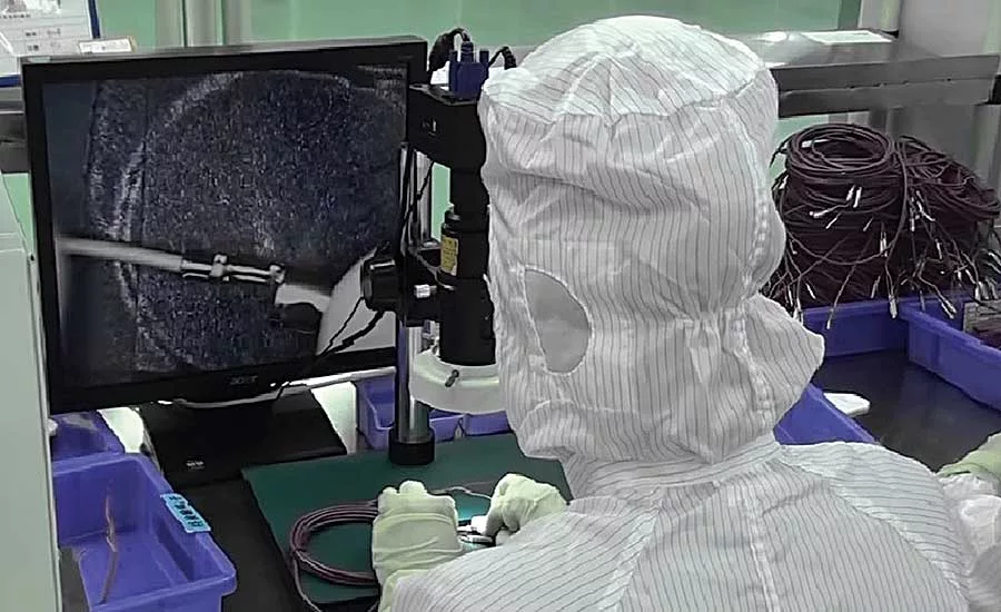

A select group of Lorom assemblers receive advanced training to work in a FDA-compliant Class 100,000 clean room at the Shenzhen facility. Photo courtesy Lorom Group

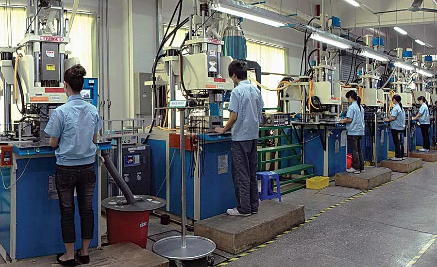

Shenzhen assemblers are trained to overmold cable and do several other tasks. Photo courtesy Lorom Group

Elliott says that all company assemblers are trained in-house for a few weeks before becoming IPC-WHMA-A-620C certified. About 30 assemblers work mostly on medical-related harnesses, although all assemblers can work on various types of harnesses.
“Cross-trained assemblers are a big reason for our success,” says Elliott. “During training, we spend a lot of time teaching each worker exactly what to look for during each step of wire preparation. They also learn about checking each wire or cable they’re given to ensure that all previous work steps were done properly. This gives us the confidence to place any assembler in any assembly situation and get a great finished product.”
AIM’s Victor facility encompasses 56,000 square feet, with 40,000 of it dedicated to production. Office space covers 8,000 square feet, and warehousing the other 8,000. Standard hours for production workers are Monday to Friday, 6 a.m. to 2:30 p.m. (with 30 minutes for lunch), although Elliott says the company, since 2015, has tried to schedule enough work so assemblers average five hours of overtime each week.
“Planning on a 45-hour work week provides us with kind of a production cushion,” notes Elliott. “We find it’s more efficient than aiming for the standard 40 hours and then possibly having to lay off and rehire some workers if things slow down.”
The plant floor has 40-plus workspaces where workers either do manual subassembly work, build and test harnesses on boards made in-house, or operate various wire processing machines. Most wire is cut, stripped, terminated and printed on two fully automated machines from Schleuniger Inc. Workers also use 15 semiautomatic benchtop machines from Schleuniger and Komax Corp.
Assemblers use Random Build from Cablescan Inc. when assembling harnesses. After the worker inserts a wire end, the system indicates the termination point for that wire’s other end on a display panel. A tone indicates that the termination is done correctly. The finished harness is left on the board for continuity and hi-pot testing with a machine made by Cirris Systems.
“We build several layers of quality into each of our assembly processes to overcome the possibility of human error,” claims Yost. “Most of our assemblers have been here 15 to 25 years. In addition, several members of our quality assurance group are former assemblers.”

A select group of assemblers receive advanced training to work in the facility’s FDA-compliant Class 100,000 clean room. The air in this room contains up to 100,000 particles 0.5 micron or larger per cubic foot, or 700 particles 5 microns and larger per cubic foot.
Hansen says that automated wire and cable extrusion and termination take place in the clean room, as well as semiautomated overmolding of connectors. Lorom is one of only a few contract manufacturers in the world with a clean room where all of these processing steps occur.
“Although automation isn’t extensive for assembly, it is current,” notes Hansen. “Assemblers throughout the plant use 52 Komax machines for crimping wire and cable of all sizes, multiple Schleuniger units to strip braids and jackets from coaxial cable, several Sienna laser strippers (made by Spectrum Technologies) and printers that print directly on wire and cable.”
Stripping and crimping equipment built in-house are also used. In addition, workers at the plant’s machine shop make all necessary tooling, fixtures and jigs, the latter designed to both hold the workpiece in place and guide tooling. All software used at the plant, including the ERP system, is written by Lorom software engineers. A total of 80 work throughout the company.
