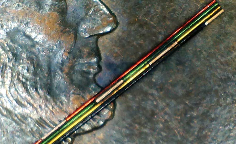

Laser wire stripping allows for precision even on the smallest wires, like this catheter wire. Photo courtesy Schleuniger Inc.

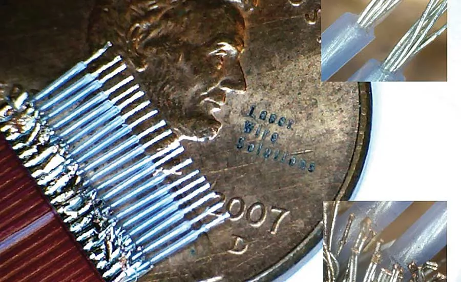

Micro-coaxial ribbon cables, such as those used in ultrasound machines, have small flexible wires that prove difficult for traditional stripping methods. Photo courtesy Schleuniger Inc.

Using laser light to remove insulation or coating layers from electrical wires, catheters and other components for medical devices is now the norm as there are many benefits to using a laser stripping process. The most significant is the highly repeatable quality that is inherent to the process. When using a CO2 laser to strip polymer insulation, from a wire conductor for example, the laser energy is readily absorbed by the insulation but highly reflected by the underlying metal conductor. Since the conductor reflects the laser light, there is no risk of damage during the stripping process. With laser stripping, there are no limits on how small of a wire can be stripped. Also, no matter the wire size there is no risk of damage to the conductor.
Another benefit is that laser stripping machines can strip round, out-of-round, flat ribbon or any other shape of wire or cable. Stripping geometries include end stripping, window stripping, slitting or complete area ablation. The process is user-friendly. There are no blades to change or consumables to replace in contrast to mechanical stripping methods. The process is non-contact, so there are no maintenance or wear items that need to be replaced frequently.

Catheter wiring is used to guide a medical probe or device to the specific tissue location. The highest demands are placed on reducing wiring size to improve maneuverability and increase functionality. Typical applications include radiofrequency ablation where the catheter carries multiple conductors, a number of thermocouples, and the RF ablation signal. This fine wiring tends to be manufactured using either enamel, like polyimide, coatings or bio-compatible fluoropolymers.
Smaller wires used in catheters can easily be nicked when using traditional mechanical stripping methods. However, because the conductor will reflect the laser, laser wire stripping ensures a completely nick-free strip.

Small gauge single conductors are very common in medical devices, whether found in a catheter delivered device or in a cochlear implant or hearing aid —With laser stripping, wires as small as 50 AWG and smaller can be stripped without damage to the conductor.
Flat micro-coaxial ribbon cables are found in a number of medical devices, such as ultra-sound scanners. High-density, high-frequency signals must be transmitted with the most flexible cabling possible. Laser stripping guarantees quality results when stripping the small conductors in high-density micro-coax ribbons.
