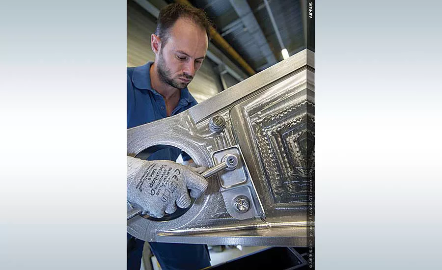

An assembler uses traditional fasteners to attach a 3D-printed titanium bracket to the aluminum pylon of an A350 XWB jetliner. Photo courtesy Airbus

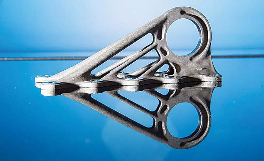

This titanium aircraft cabin bracket was produced with metal additive manufacturing. It weighs 30 percent less than a traditional milled piece. Photo courtesy Airbus

One of the benefits of additive manufacturing is parts consolidation. Complex, multicomponent parts that previously required assembly can be printed as a single object. That enables engineers to consolidate multiple components or assemblies into one part, eliminating time and assembly costs.
The long-term goal of additive manufacturing is to simplify or reduce the need for assembly. Indeed, a lot of plastic printed parts incorporate snap fits, which eliminates the need for adhesives or fasteners altogether. Typically, snap fits stay within the geometric constraints of mold making and use plastic’s ability to elastically deform and then snap back into shape.
“One of the driving factors behind current additive manufacturing adoption is that the finished part…often eliminates multiple subcomponents or optimizes the design structure of a machined part or group of parts,” says Mike Mowins, president of the Phillips Screw Co.
“A metal or plastic part produced by additive manufacturing can be much lighter in weight and have more complex geometries than a traditionally machined or molded part,” explains Mowins “The result is that you have a single part that will still utilize the same fasteners that the original designed part uses, but will be lighter and have an optimized structural geometry.”

For instance, Airbus engineers recently attached a 3D-printed titanium bracket to the aluminum pylon of an A350 XWB jetliner. Other major aerospace manufacturers, such as Boeing, General Electric and Lockheed Martin, are also bullish on the technology.

“We still see the same types of joining techniques being used,” says Mowins. “There isn’t much of a difference between a thread-forming fastener used for a traditional molded plastic part vs. a printed plastic part. A fastener with an aggressive thread profile will give you a good joint with either type of part.”
“Joining techniques haven’t changed,” adds Allen Kreemer, principle applications engineer at Stratasys. “Any conventional joining method, such as adhesive bonding or mechanical fastening, will work. For instance, parts printed with FDM technology can be bonded with many types of epoxies and cyanoacrylates. We’ve also tested silicones, urethanes and UV-cured adhesives.
“Two-part epoxies are commonly used to bond FDM parts,” says Kreemer. “After application, bonded sections are fixtured or clamped while the epoxy cures.
“The tensile strength of cyanoacrylate is higher than that of epoxy adhesives,” notes Kreemer. “However, its resistance to high temperatures, chemicals and solvents is poor. Therefore, bonding with cyanoacrylate may diminish the performance of FDM parts. So, it is recommended for concept models and form-and-fit prototypes rather than functional prototypes or manufactured parts.”
Ultrasonic welding is another joining alternative, especially for parts that are printed with thermoplastic materials. “When higher strength is needed, ultrasonic welding may be used in combination with other methods,” says Kreemer. “This approach is especially useful for bulky or awkward assemblies.”
Mechanical fasteners are another effective alternative. “There are a large number of mechanical fastening approaches and hardware options that can be used when joining FDM parts,” claims Kreemer. “One unique approach to mechanically join sections is to insert fastening hardware in the part during its build process. When it emerges from the [printer], the fasteners are integrated within the part.”
