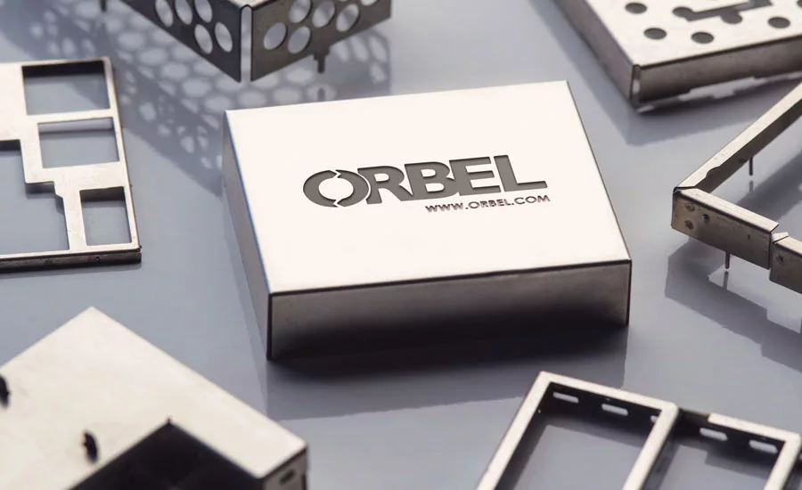

EMI Shielding Applications
Designed around today’s most challenging EMI shielding applications, board level shielding (BLS) is available in one-piece, two-piece, multi-cavity, and custom configurations. Source: Orbel

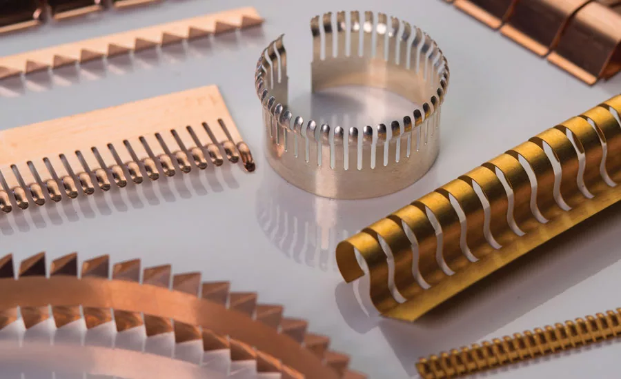

Finger Stock Gaskets
High-performance finger-stock gaskets deliver EMI shielding effectiveness and are available in a variety of materials.  Source: Orbel

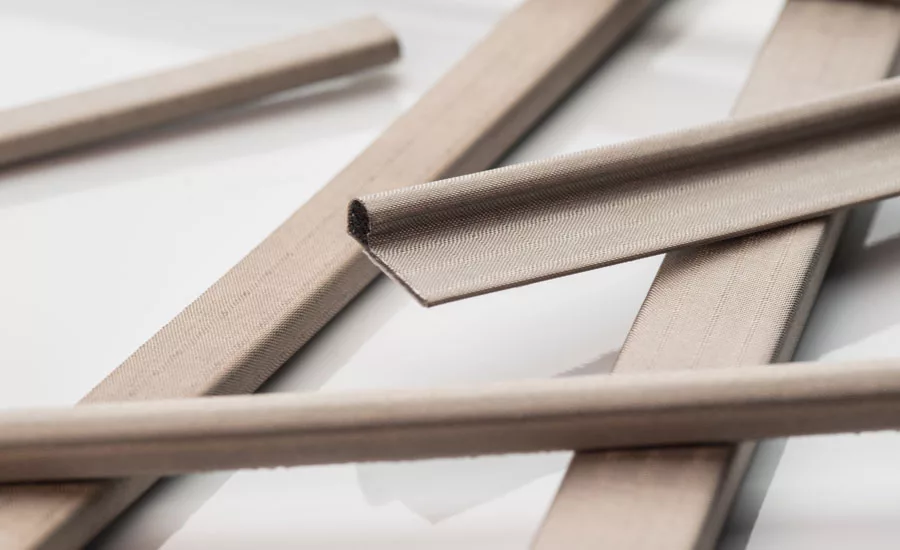

Fabric-over-foam gaskets
Ideal for the control of EMI, fabric-over-foam gaskets shown here are manufactured from a polyurethane foam core and wrapped with nickel-plated copper-conductive fabric. Source: Orbel
