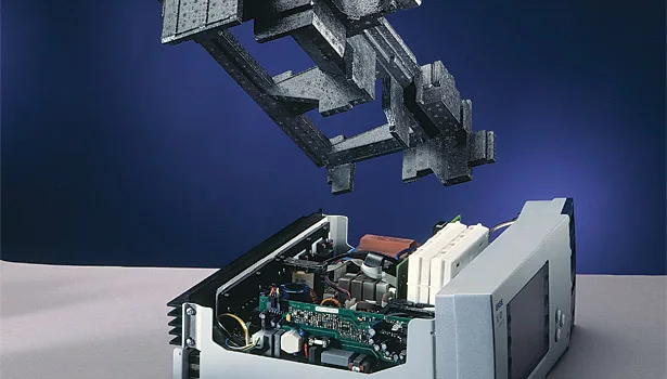

Expanded polypropylene foam serves as a mechanism to assemble the components on the inside of a medical device.

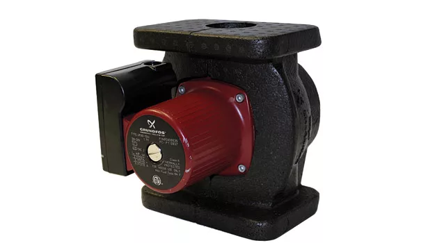

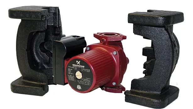

This water pump uses expanded polypropylene as both protection during shipment as well as insulation upon install.

The resiliency of the EPP foam allows internal components such as printed circuit boards, fans and power supplies to be held in place using a friction fit; no other attachments are necessary.  The components are simply slid or snapped into place and then held in place by the foam.  As a result, any of the screws, fasteners and brackets that do nothing more than hold the components in place can be eliminated, right in line with the principles of DFMA.
One method of replacing the internal structure of a device with EPP is to use a sandwich approach with top and bottom EPP pieces that lock the components between them.  Instead of attaching a muffin fan or circuit board to a wall or chassis with screws, EPP can be used such that the components are snapped into place in the bottom piece of foam, and then the top piece of foam is placed over the components in a “sandwich” fashion.  This not only eliminates fasteners and brackets, but it can also help to dampen vibration and/or noise created by the fan.

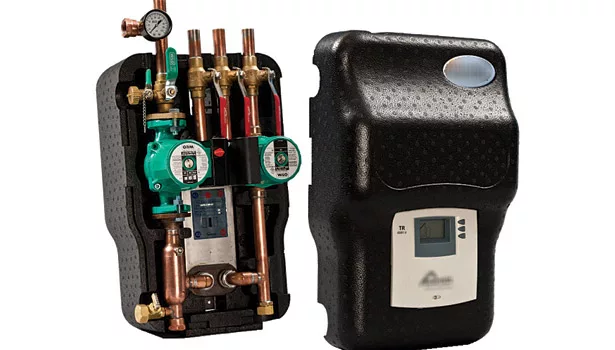

In addition to resiliency, the material properties of EPP are such that a foam chassis structure can be very strong and rigid.  Because of this, the outer housing on a device can be made with a thinner gauge material, and, in some cases, be eliminated completely, leaving the foam as the internal protection, support and outer housing.  In the case of the hot water heater application shown, the foam acts as the internal support and the external housing as well as protects the unit during shipment.   In the case where the external housing must have a particular texture or surface finish, the foam can have a variety of textures molded into it in order to achieve the desired look on the finished product.
One unique benefit of EPP is the ability to mold different types of channels into the part.  Channels are helpful for use in routing tubes, wires or even directing air flow.  Small crush ribs, molded into the sides of the channels allow the wire or tubing to be snapped into place and held there without the need for any additional attachments.  In the case of a channel for air flow, the channel can be designed and molded such that air is directed away from the components and out to the heat sink.  By directing the airflow within the chassis to precisely where it is needed, smaller fans can be used which often results a quieter and more energy efficient design.
