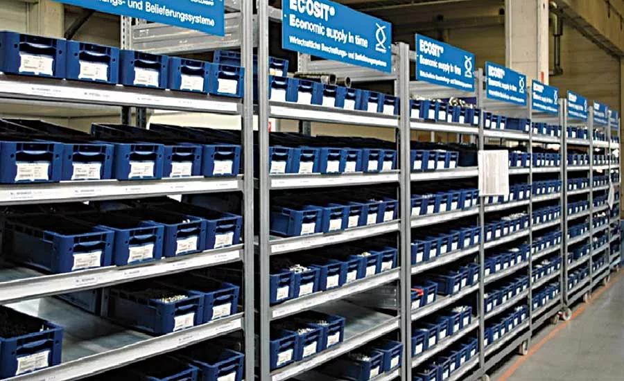

At its non-engine plant in Mattighofen, Austria, KTM recently implemented the RFID-based ECOSIT bin system to monitor and manage fastener supplies. Photo courtesy Bollhoff Group

To help workers respond better to seasonal fluctuations, KTM recently switched to the ECOSIT bin system made by the Bollhoff Group. This system consists of an RFID antenna, RFID tags on bin labels and enterprise resource planning (ERP) software. KTM kept its bin shelves, and with Bollhoff’s help, installed and commissioned the system in only one day.
During production, workers take parts from each bin as needed. Once a bin is empty, it is placed in a collection box next to the shelf, and data is automatically transmitted from the bin’s RFID tag to the ERP software. This process takes only a few seconds and immediately notifies stock workers, via computer, to promptly refill the specific bin.
Reiter and others at KTM are very impressed with the system, citing many important benefits. First, the risk of C-parts being unavailable has essentially been eliminated, thereby cushioning seasonal demand fluctuations in production.
In addition, delivery of replenishment parts requires no manual ordering and is considerably faster, easier and more reliable than before. Empty bins are often replaced within one day. According to Reiter, the ECOSIT system also reduces the need for excessive inventory, and improves inventory security and tidiness.
Bettina Schober, purchasing manager at KTM, says that, despite reducing inventory values, the RFID-based system enables the company to always stay on top of demand fluctuations in their material supply.
