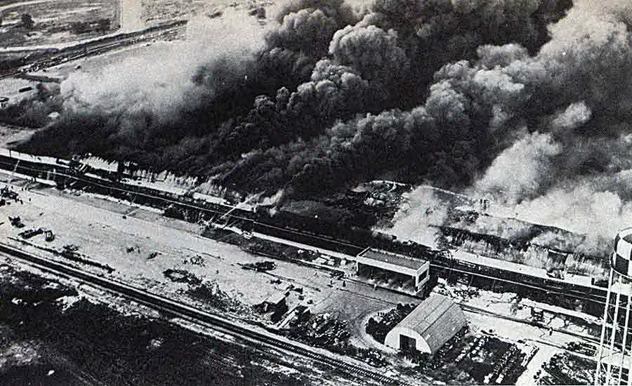

On Aug. 12, 1953, fire destroyed GM’s state-ofthe- art transmission assembly plant in Livonia, MI. Photo courtesy General Motors Corp.
America’s Most Destructive Industrial Fire

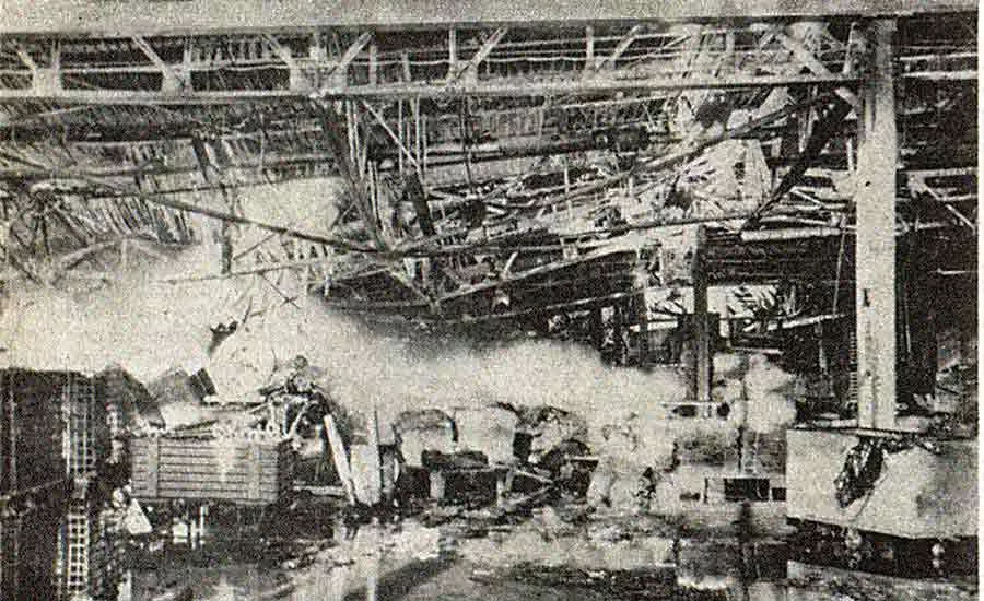

Causing $50 million in damage (almost $500 million in today’s dollars), the fire that destroyed GM’s transmission factory was the most destructive industrial fire in American history. Photo courtesy General Motors Corp.

The fire broke out in the south end of the plant in the flywheel section, where the only firewall on the premises separated manufacturing from a two-story administrative building. A monorail conveyor 11 feet above the floor was transporting stamped metal parts to and from a rustproofing dip tank brimming with 450 gallons of flammable chemicals. A drip pan extended 4 inches below the conveyor to capture its oily spillages.
Around 3:40 p.m. a contractor’s welding crew was repairing a steam pipe beneath the plant’s 21-foot ceiling when sparks from an oxyacetylene torch sailed into the drip pan, setting its liquid deposits ablaze. Two ground-level crew members grabbed fire extinguishers, scrambled up a ladder and began smothering the flames. The handheld extinguishers fizzled out and fire ripped along the drip pan canal, rupturing its metal frame and splattering burning residue onto a wood floor marinated in creosote coal tar and an imperceptible veneer of chemical condensate. The fire moved swiftly, lighting up a nearby heat-treating oven as it took off on a rampage through the plant. Thick black smoke billowed in its wake.
There were no fire barriers to impede the inferno and no alarms to alert employees to evacuate the building. Lacking proper training and adequate equipment, an in-house fire brigade could do nothing. The plant’s only overhead sprinklers rained down on shipping, receiving and storage, but not manufacturing.
Mildred Artrip, starting the second hour of her Wednesday afternoon shift, “suddenly saw people from the back running through the plant. They were shouting it was on fire. We grabbed our lunch buckets and ran. It looked like a tornado. There was black smoke all over the place.”
As Mildred and 4,000 other employees sprinted for the exits, searing heat, trapped by a ceiling without vents to expel it, ate through the roof deck’s thin steel plates. Two thousand tons of tar, hot mopped between three layers of fiberboard insulation and sealed by an asphalt blanket, ignited across the roof’s broad expanse. Burning pellets of tar spewed into nine open tanks filled with almost 4,000 gallons of flammable liquids and over metalworking machines, heat-treating ovens and furnaces with lubricants and cutting and quenching oils coursing through them. Roaring fire engulfed the entire plant.
Some 150 firemen aboard 31 firetrucks from Livonia, Detroit and seven surrounding communities raced to the scene, sirens blaring. First responders watched helplessly as the center section of the roof collapsed, buckling red brick walls. Pressure from hoses fell short of covering the two-block-long blaze, restricting firefighters to soaking a 50- to 75-foot perimeter from widely scattered hydrants. A volunteer fireman died of a heart attack while unloading hoses in the day’s 87 F heat. Beneath the fallen roof, fire burned undisturbed through the night.
