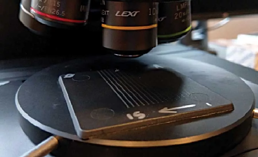

The LEXT OLS5000 confocal microscope uses pinholes to detect light from a well-defined point in 3D and discards all out-of-focus light. Photo courtesy Olympus Corp.

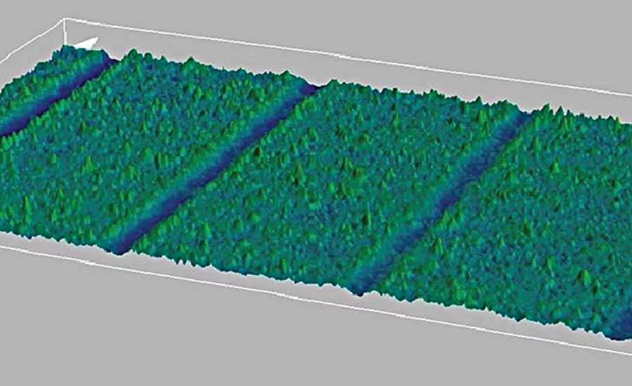

Software used with the LEXT OLS5000 confocal microscope presents scientists with a clear visualization of scratch test data. Graphic courtesy Olympus Corp.

UK-based Croda International Plc is a leading supplier of migrating additives that regularly tests treated parts to validate additive effectiveness. Testing involves scratching the part surface with a standardized tool at a defined force of 1 to 20 newtons, and then measuring the depth, width and profile of the thin film to determine if there are any differences between their compositions.

By using the LEXT OLS5000, researchers can now measure scratch depth and profile to the nearest 10 nanometers. They are also able to obtain a smoother image of the scratched surface to facilitate a more accurate measurement with fewer human errors. Equally important, the LEXT microscope (and operating software) performs scratch width and depth measurements and analysis up to 100 times faster than the OMI approach.
“With the old technique, all four people in our department could get a different result from the same sample,” notes Martin. “Because the LEXT system accurately measures in 3D, we simply view a slice through the scratch and measure depth. It’s much easier, [and lets us] measure and process 10 scratches on a plastic surface in 2 minutes.”
