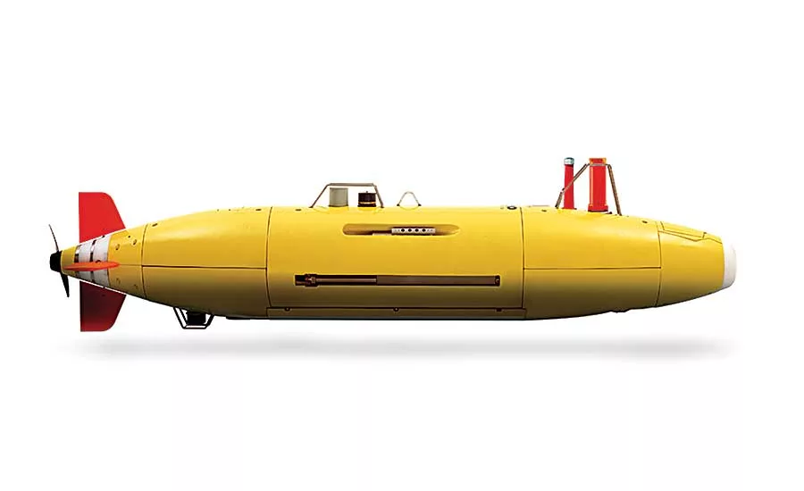

Keeping Wiring Dry Underwater
Autonomous underwater vehicles are small, unmanned submarines that can operate without remote human intervention. Many companies, including the Woods-Hole Oceanographic Institute, Bluefin Robotics and Boeing, make such devices of wide-ranging size for various purposes. Our customer, Hydroid in Pocasset, MA, makes deep-diving vehicles for ocean exploration at depths of up to 6,000 meters.
During the manufacture of these vehicles, various hull penetrations are necessary to admit wiring for external cameras, sonar, and electronic sensors. With great pressure present at normal operating depth, water may seep through microscopic defects in wire insulation that would eventually lead the electronics to malfunction. As a result, all vehicles are tested in the factory using a large tank that can be pressurized to simulate the deep ocean. While under pressure, high-voltage cable testing can reveal insulation defects that cause conductive liquid, like seawater, to penetrate copper conductors.

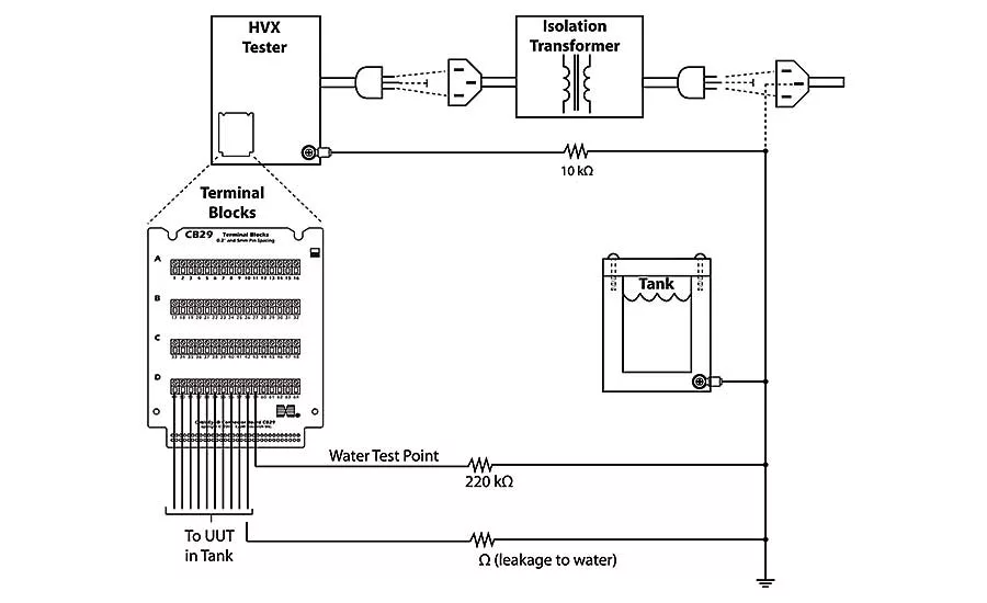

To test the quality of electrical insulation, we normally apply voltage between two unconnected wires and look for leakage between wires in fractions of a microamp. To obtain better than 1 gigohm of isolation between two wires, we would apply 1,000 VDC between the wires and expect to see leakage of less than 1 microamp.
The challenge in this application is that the water itself must serve as one of the conductors so that we can detect leakage under the insulation to a single wire rather than between two wires. However, the cable tester’s electronics require that all points be electrically isolated from earth ground so that each wire can be individually energized while the other wires are not.
A body of water, unfortunately, is, of course, always at ground potential, including a water tank attached to a grounded structure. As a result, using the water itself as a test point becomes problematic. Since we could not electrically isolate the water in the tank, we instead isolated the tester and computer from ground by powering both through an isolation transformer. This permits successful measurements between the water and the wiring to confirm that the insulation remains intact.

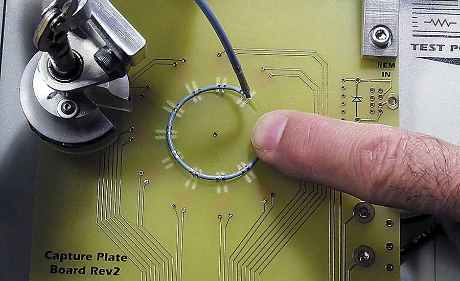

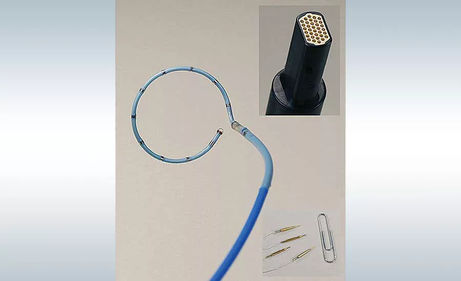

Catheter Testing
Medical catheters for electrical sensing or stimulation comprise small tubes containing extremely thin wires (fractions of a millimeter) that lead from an electrical connector at the near end to evenly separated electrodes along a short length of tube at the far end. Testing such an assembly can sometimes prove quite challenging.
For example, simply clipping a minihook connector to each electrode would not only be awkward, but could apply enough force to the electrode to deform it. The special fixture we developed, however, allows the operator to make physical contact with the electrodes without damaging them.
We milled a circular groove in a 0.093-inch-thick fiberglass circuit board to about half its depth. On the other side of the board, we milled slots perpendicular to the circular groove spaced at the positions of the catheter’s electrodes to just over half the depth of the board. This exposed openings along the circular groove where the electrodes would be located.
By soldering-in a specially designed spring pin on the back side of the board to terminate at each opening along the groove, we made electrical contact with the catheter. A circular clamp closing from above applied uniform pressure around the catheter to ensure that all electrodes touched the spring pins. Once mounted, a test with resistance can be completed in about one second.
