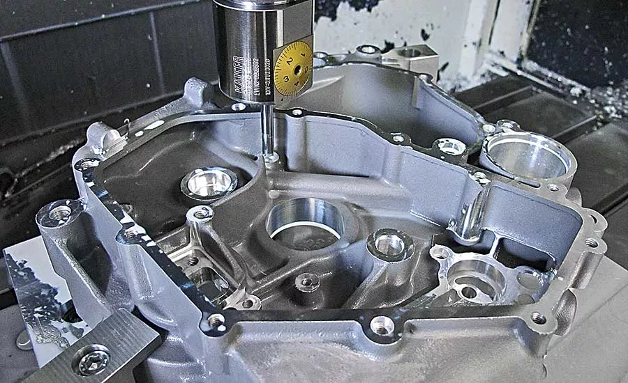

Founded in 1996, Suter Industries Ltd. provides engines and drivetrains for motorcycles, automobiles, specialty vehicles and even yachts. Photo courtesy Suter Industries Ltd.

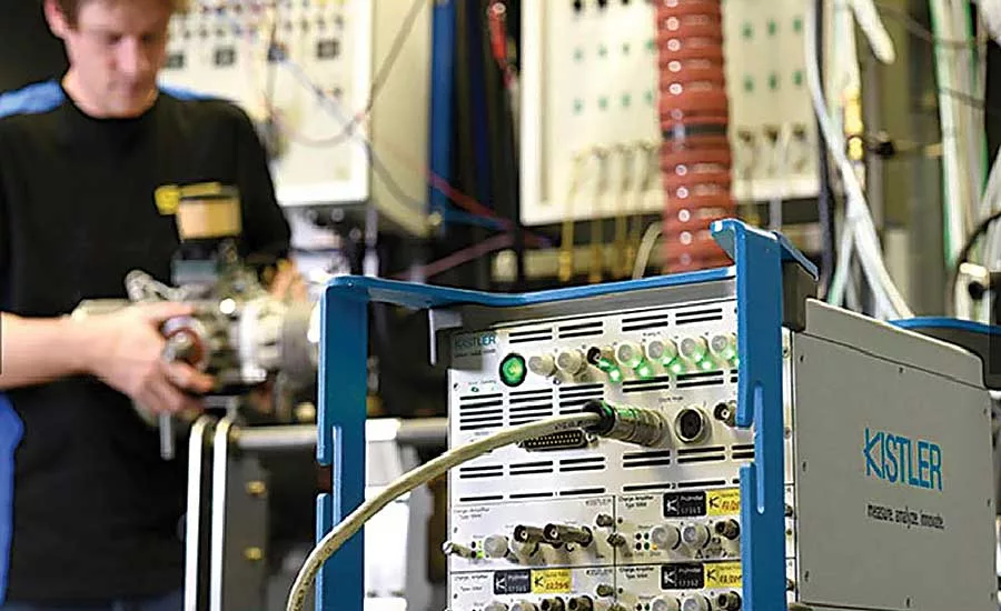

The development team at Suter Industries regularly uses the KiBox system to measure the combustion performance of engine prototypes. Photo courtesy Kistler Group

Recently, Karrer’s team designed four stands that Suter uses for testing engine prototypes. These large-scale installations have a power output of 60 to 405 kilowatts and offer flexible instrumentation.
The key component of each stand is a KiBox combustion analysis system that measures various parameters of engine performance. Suter engineers keep the system stationary on a test stand, although mobile use is possible within a vehicle.
Made by the Kistler Group, the system performs combustion diagnostics, which enable problems that arise in the vehicle on the road to be characterized and resolved efficiently. It accurately measures parameters like cylinder pressure, speed, heat release rate, peak pressure and combustion noise.
The system provides performance data about each individual cylinder, thereby enabling Suter engineers to optimize fuel injection and ignition timing. Collected data also helps them limit engine damage caused by knocking.
“We have been using KiBox since the end of 2015 and are highly satisfied with it,” notes Karrer. “We benefit from its numerous different features to form a comprehensive picture of the processes in an engine. For instance, we can precisely determine the power loss or thermodynamic loss angle with the help of a specialty probe.”
Other key engine-performance parameters tested with the KiBox are energy conversion, maximum pressure increase and its angular position, and overall, high and mean effective pressure. All parameters are conveniently integrated into the application system, and are synchronized with other measurement data and engine control unit parameters via a PC software interface.
