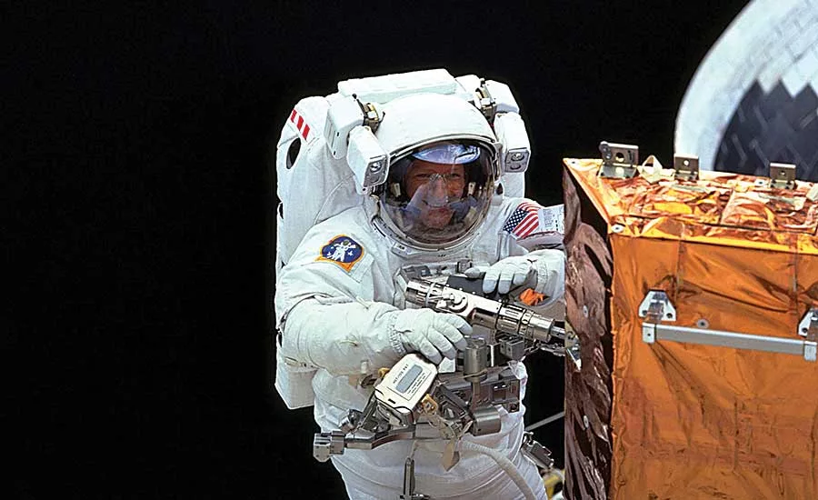

In December 1999, astronaut Claude Nicollier from the European Space Agency works at a storage enclosure, using a specially designed fastening tool. Photo courtesy NASA

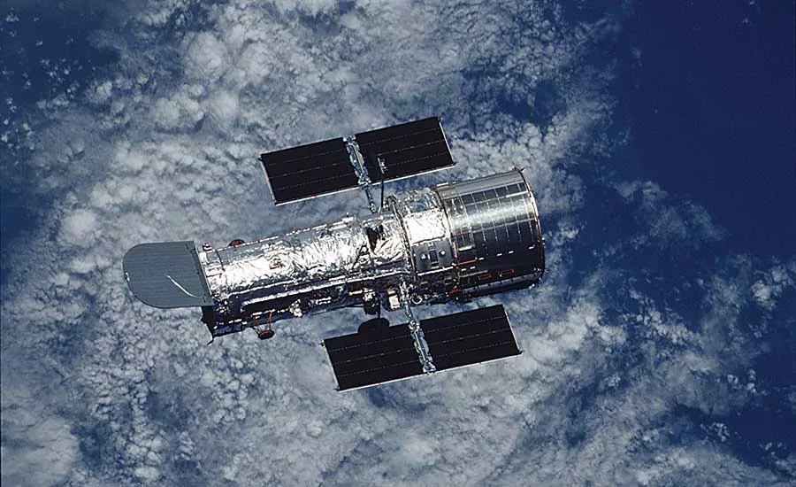

This year marks the Hubble Space Telescope’s 30th year in orbit. Photo courtesy NASA

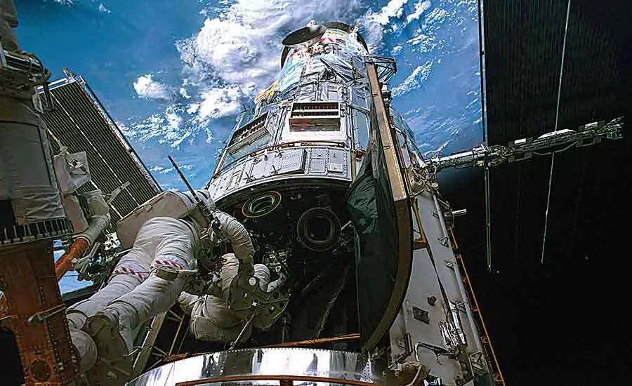

In December 1999, astronauts C. Michael Foale (left) and Claude Nicollier work to install a fine guidance sensor in the Hubble Space Telescope. Photo courtesy NASA

Forty-three feet long and 14 feet wide, Hubble circumnavigated the Earth 15 times a day at 1,700 mph. The size of a railroad tank car, “it looked like an elongated refugee from an Erector set,” according to one writer. A pair of wing-like arrays, 23.3 feet long and 8.6 feet wide, were covered by almost 100,000 silicon solar cells, each as small as a postage stamp. They generated all the electricity needed to power the spacecraft.

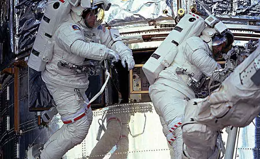

“Working on the Hubble while floating in space is like performing brain surgery upside down while blindfolded and wearing oven mitts,” quipped John Grunsfeld, a veteran of 58 hours of spacewalks, including the final Hubble servicing mission in 2009.
Before venturing into space, the astronauts spent 400 hours practicing their assignments in a 25-foot-deep pool at Johnson Space Center in Houston. Tucked into 350-pound spacesuits, they were lifted by an overhead crane into the pool, which simulated the weightlessness of space. Exact replicas of the equipment to be repaired sat at the bottom of the pool, including hundreds of bolts that would need to be unfastened to gain access to the modules housing the instruments. Once inside these cramped spaces, they were confronted by a maze of screws and plugs to detach and reinstall.
Engineers analyzed videos of each practice session. The observations enabled them to refine procedures and tools that would help the spacewalkers lift and exchange objects as small as shoeboxes and as big as pianos. A power ratchet tool, the workhorse device for the first three servicing missions, could vary speeds and torque while recording every turn in a computer. This input helped designers to craft more efficient tools and refine processes for future missions.
Jeffrey Hoffman and Story Musgrave were the first two astronauts to venture outside Hubble. Attached to foot restraints on the remote manipulator arm, the astronauts were firmly anchored as they went left, right and upside down around the telescope. While free-floating and tethered to the shuttle, Musgrave removed the cover where gyroscopes were situated. Hoffman installed small metal boxes called rate sensing units, each containing new gyroscopes to replace three that had worn out.
The following day, Tom Akers and Kathryn Thornton removed the two damaged solar arrays. One of them was bent at a 90-degree angle, and hundreds of the tiny solar panels had stripped away from each of them. Three days later, Hoffman and Musgrave ran into problems after installing new arrays. Latches unlocked, but the arrays would not deploy. Corrective commands from ground control failed to elicit any reactions, so the two astronauts hand-cranked a mechanism to deploy the arrays.
On day three, Musgrave and Hoffman unbolted the access door to the module where the WFPC was stored. They took out the WFPC and installed the WFPC-2, which was equipped with self-correcting optics that neutralized the spherical aberration on the primary mirror. On the following day Thornton and Akers opened aft shroud doors and installed the clunkily named Corrective Optics Space Telescope Axial Replacement (COSTAR), an enormous and complex optics package. COSTAR’s five coin-sized mirrors were perched on stalks staring at the faint object camera and two spectrographs. The mirrors intercepted and corrected aberrant beams from the primary mirror.
