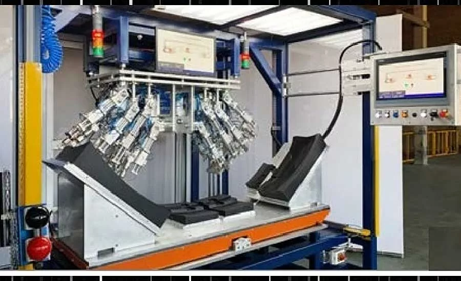

Magna Automotive RUS uses ultrasonic welding systems for bumpers on the Volkswagen’s Škoda Karoq and Škoda Rapid vehicles. Photo courtesy Telsonic AG

Increased use of ultrasonic welding by automakers outside the U.S. is also overlooked. Case in point: Telsonic AG’s Moscow-based distributor Windeq TC is the first Russian company to design and produce semiautomatic ultrasonic systems for automotive manufacturers there. One is Magna Automotive RUS, which makes a wide range of parts for assembly and has used ultrasonic welding since 2019.
The company welds several components for Volkswagen’s Škoda Karoq, Škoda Rapid and VW 316 Tarek vehicles. Magna does likewise for the AutoVAZ Lada models. Sensor brackets are mounted on the Škoda’s thin-walled front bumpers using Telsonic ultrasonic welding equipment. Front and rear spoilers, as well as mountings for reflectors, are welded components on the Tarek.
As for the Lada cars, welding systems attach the balcony structures that guide electric window regulators and the brackets that hold storage compartments to the interior door panels. Galina Steffen, sales engineer at Telsonic AG, says that Magna chose dual sonotrodes for these applications because welding is performed at particular spots and along seams that are close together.
A dual sonotrode provides a huge advantage here, according to Steffen, because it simultaneously produces two welding points, but requires only one converter and booster to apply mechanical vibrations. In addition, any common fieldbus interface can be used to enable the system’s ultrasonic generators to communicate with the control system of the plastics processing machine.
