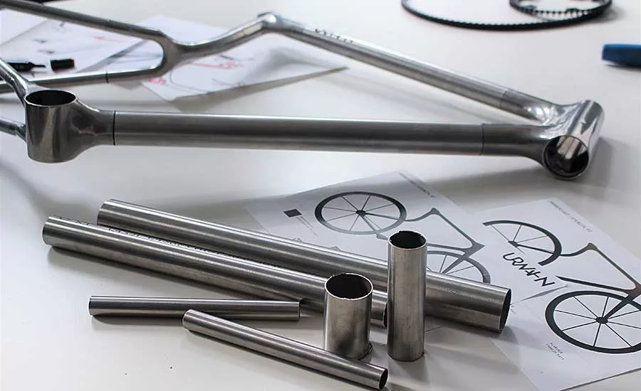

The primary goal was to reduce the frame weight by pushing components like 3D-printed tubular and connecting elements to the limits while still guaranteeing product safety. Photo courtesy Urwahn Engineering GmbH

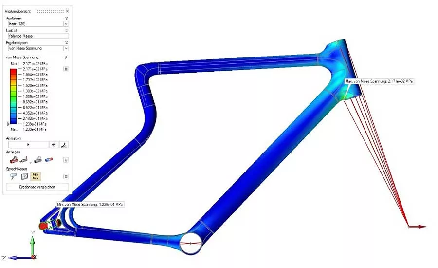

Simulating load cases on the steel frame structure in Altair Inspire enabled Urwahn to meet the DIN ISO 4210 safety standards. Photo courtesy Urwahn Engineering GmbH

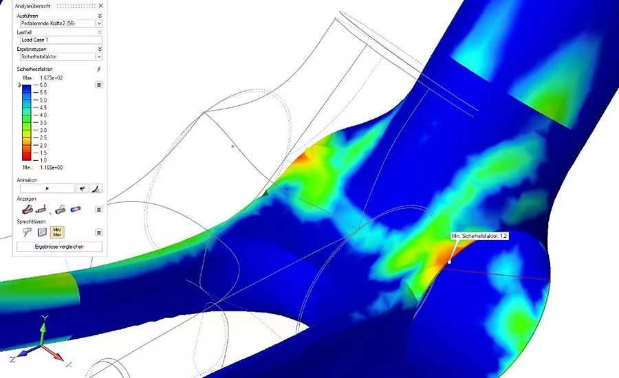

This image shows how forces created by pedaling the bicycle might affect the frame. This helped engineers create improvements to meet safety regulation parameters. Photo courtesy Urwahn Engineering GmbH

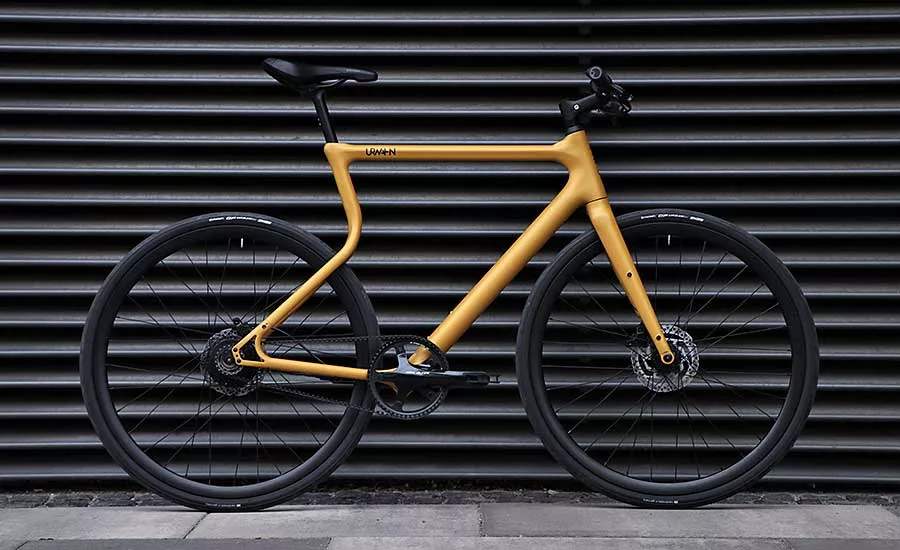

Urwahn’s unique Softride frame geometry lacks a seat tube, which is intended to insulate the rider from unevenness and terrain. Photo courtesy Urwahn Engineering GmbH

The company’s philosophy is based on four pillars: design, functionality, processing and sustainability. Urwahn uses additive manufacturing to create its steel frames, which combine organic design with high brand recognition and high functionality. The company’s unique Softride frame geometry lacks a seat tube, which is intended to insulate the rider from unevenness and terrain.

The company uses additive manufacturing to make a variety of parts, including frame components. The company does not printing the entire frame, but rather those parts that matter from an engineering and design standpoint. The goal is to enable engineers to maximize performance, cost and aesthetic goals.
In addition to additive manufacturing, the process of making Urwahn bikes involves welding, grinding, painting and final assembly.

To meet DIN ISO 4210’s safety requirements, they simulated five load cases on the steel frame structure (three dynamic tests with vertical, horizontal and alternating forces, and two static tests of the frame and fork). In each scenario, Urwahn engineers studied the behavior of the 3D-printed parts and explored the impact of the material distribution on overall system behavior, aiming to minimize weight. Using the integrated topology optimization solver within Inspire enabled Urwahn to push the material usage limit, thereby reducing weight and costs, while keeping stiffness and other boundary conditions on target.
Thanks to Inspire, Urwahn studied the existing framework concept, detected limit values, and reduced wall thicknesses significantly by testing different load case scenarios on the structure. As a result, the team lowered the steel frame’s weight while maintaining its stiffness. In addition to reducing wall thickness by up to 15 percent, the Inspire results also implied that there is still room for improvement within safety regulation parameters.
