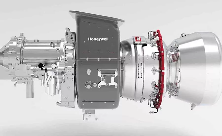

The electric aircraft ecosystem also involves companies like Honeywell, a Tier One aerospace supplier that makes electric propulsion systems, and magniX, a start-up electric motor manufacturer.

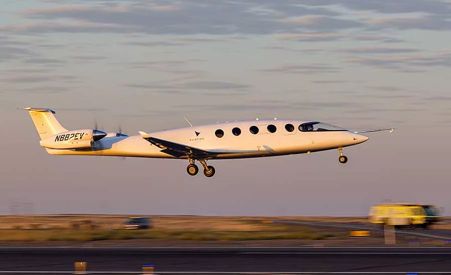

Last fall, Eviation, a start-up aircraft manufacturer based near Seattle, celebrated the inaugural flight of its prototype Alice electric aircraft, which can carry nine passengers or up to 2,600 pounds of cargo. The successful test was heralded as the start of an electric future for short-haul air travel.
"The development path for getting this aircraft to market includes working with the Federal Aviation Administration (FAA) on our certification program, which is what we're doing right now,” says Gregory Davis, president and CEO of Eviation. “We're finalizing market and technical requirements.”
In 2025, the company will begin the certification flight test program, which is when the next prototype aircraft is going to be built, followed by further testing programs, before delivering the aircraft to customers in 2027. It already has orders from companies such as Air New Zealand, DHL and Global Crossing Airlines.
"DHL sees Alice as a vehicle for enhancing their network through additional services," notes Davis. "The great thing about electric aircraft is that you can go and add new services without worrying about harming the environment."
The core difference between traditional turbine-powered, fuel-burning aircraft and an all-electric aircraft is the propulsion system. Rather than having fuel tanks and turbine engines, planes like Alice use batteries and electric motors.
"We're taking the advanced technology we need to get to the core issues of carbon reduction, lower costs and more convenience," explains Davis. "We're taking the path that we see gets us into the marketplace as quickly as possible."
Eviation sees that path as using conventional takeoff and landing methods and existing certification requirements.
"We're taking the current state of aircraft regulations and working with traditional aircraft designs to adapt our technology to it," says Davis. His company has produced the batteries for the Alice prototype in partnership with AVL, which makes battery systems for automakers such as Volkswagen.
According to Davis, another major benefit of electric aircraft is reduced maintenance cost, which contributes to overall operating efficiency.
"The maintenance for the turbines on a conventional aircraft is one of the key costs, while the electric motor has one moving part," Davis points out. "The overall costs of that motor are going to be substantially lower."

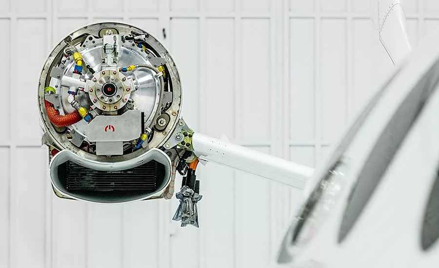

Honeywell Aerospace has formed a partnership with Wright, in addition to Eviation, where the company's lightweight Micro Vapor Cycle System will cool propulsion systems aboard the Alice, and Faradair, where it will provide turbogenerator units running on sustainable aviation fuel.
"[We] see a lot of clean-sheet [designs from start-up manufacturers] that are building new aircraft from the ground up," says Taylor Alberstadt, senior director of sales and marketing at Honeywell. “The requests are often for more compact, lighter weight components. That enables them to use different types of technology and deploy it in a way that meets specific needs, such as steer-by-wire systems."
According to Alberstadt, an all-electric aircraft that use one or more motors instead of a traditional gas turbine engine, typically results in a reduction of operating costs by 35 percent to 75 percent.
"Without that gas turbine engine, it's quieter, which enables you to get into different airports at different times, and it might allow unlocking additional flight plans and paths that typically you couldn't have if you have a fixed wing flying at low altitude," explains Alberstadt. "From sustainability to safety to noise abatement and reduced cost in operation, there's really a lot of reasons we want to play in this space."
Alberstadt says every gram of weight on an electric aircraft is critical. In fact, he claims that some customers are drilling holes in screws to try and take out just a little bit of excess weight.
"From a power density point of view, the lightest possible motor to achieve the desired electrical output is going to be necessary," Alberstadt points out.

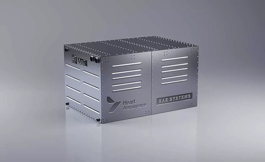

“The battery will be the first of its kind to be integrated into an electric conventional takeoff and landing regional aircraft, allowing it to efficiently operate with zero emissions and low noise,” says Ehtisham Siddiqui, vice president and general manager of controls and avionics solutions at BAE Systems. Work on the program will be conducted at the company’s state-of-the-art facility in Endicott, NY.
“BAE Systems’ extensive experience in developing batteries for heavy-duty ground applications, and their experience in developing safety-critical control systems for aerospace, make them an ideal partner in this important next step for the ES-30,” adds Sofia Graflund, chief operating officer at Heart Aerospace.
“The ES-30 will also have a cost-effective and scalable upgrade path as future battery technology matures,” claims Graflund. “The battery upgrade roadmap allows for increased usable energy at the same weight, resulting in longer flight durations and expanded route options.”

That's why Honeywell engineers are focusing on designing a core solution that can scale up and down to meet the needs of these various new aircraft manufacturers.
"The designs are different, so the power requirements are different," notes Alberstadt. "Having a [product] that can meet multiple customer needs is going to be imperative, too. The market will eventually converge on what the design looks like, but at this point, there's many different [variants]."
Alberstadt says few people are asking for the exact same thing from an electric propulsion point of view, whether it be packaging, or power geared vs. direct drive. "There's really just not one set standard, so scalability is a key piece of it, too," he points out.

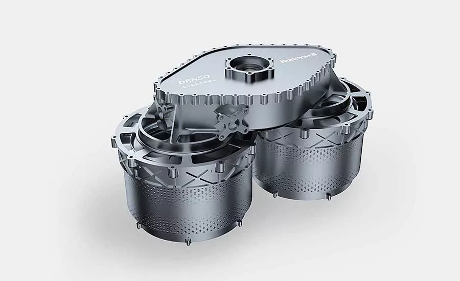

To marry automotive and aerospace expertise, Honeywell joined forces with Tier One automotive supplier Denso. The companies are two years into a long-term strategic alliance to develop electric motors and other components.
"We [discovered that the needs of the electric aviation] market would not just be a rollover of aerospace from a technology and a production point of view," says Alberstadt. “When we think about advanced air mobility and the scales that some customers are talking about, it's way beyond what aerospace has traditionally been capable of."

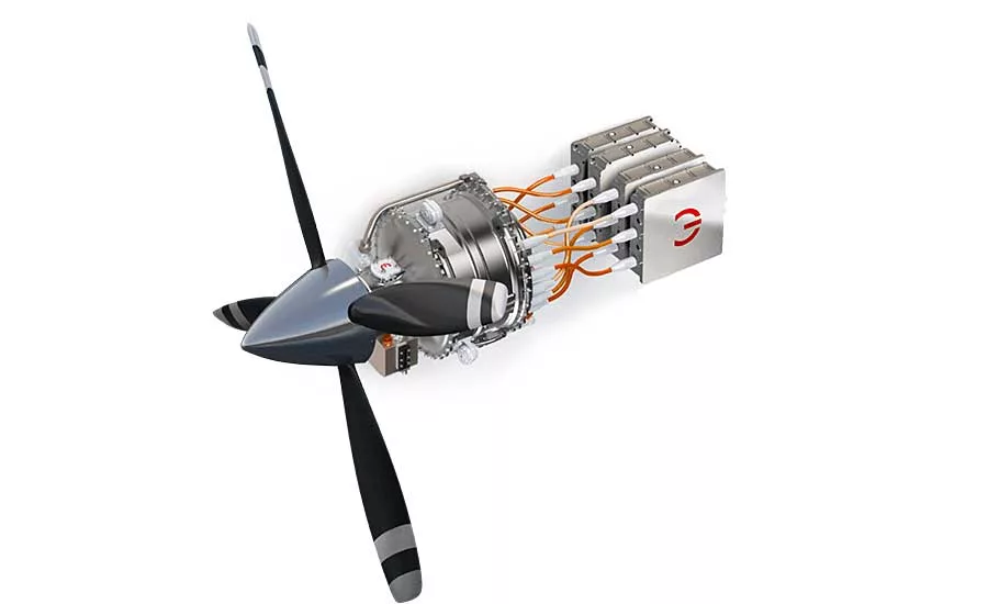

The start-up company has developed electric propulsion units (EPUs) and energy storage systems for aircraft. It prides itself on how much thought is given to the way magniX’s system is designed to integrate with aircraft, from the engine mount, to the way the propeller loads are reacted through the motor. In addition, the EPUs are electron agnostic, meaning they can be powered by any electric power source.
"After the piston engine and jet engine, the electric motor promises to usher in a new age of flight," claims Sercombe. “One unique attribute of the assembly process of an electric propulsion system is translating the unique demands of the aerospace industry where quality, traceability and documentation are paramount.
"The challenges lie in creating solutions that are not only exceptionally powerful or torque-dense, but that are also built in a traceable, repeatable manner within an aerospace quality framework," explains Sercombe.

Major milestones like Eviation's Alice test flight make the future of electric flight more tangible.
"It's happening," claims Honeywell’s Alberstadt. "There aren't major technological hurdles anymore. Is battery technology exactly where we want it to unlock everything we want to do in the future? No. But, is battery technology sufficient today to enable a lot of the missions that can still revolutionize the way we travel? The answer is yes.
"This is no longer a pipe dream or a Jetson’s TV episode from 50 years ago that's never going to happen," says Alberstadt. "Electric aircraft are flying now."
