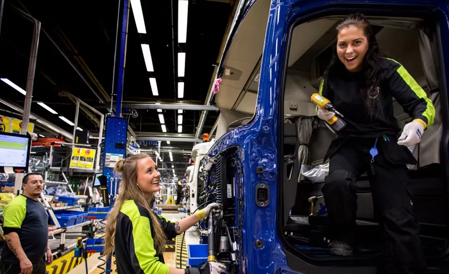

TUVE, Sweden—Every time an assembler uses an electric fastening tool at the Volvo Group truck factory here, the data from the operation is logged and stored. Engineers are now using that data to increase quality.
A truck has thousands of bolted joints. Most of the time, assemblers use pneumatic fastening tools to tighten them to a predefined torque. But, for the most critical bolted joints, assemblers use electric tools.
“It is the clamping force that decides if the bolted joint is tightened enough,” says Filip Bergman, bolted joint specialist at Volvo. “But the clamping force can’t be measured directly in production, only in laboratories where we perform tests to decide suitable assembly torque for each joint.”
The problem is that the clamping force is dependent on friction. And, friction can vary, depending on the fastener and what parts are being assembled.
“With electric assembly tools, it was possible to pre-define not only the target torque but also the angle of rotation for the screw during tightening,” says Thomas Norberg, who works with maintenance in the Tuve plant. “By monitoring two parameters, instead of only one, we can be sure that we reach the needed clamping force most of the time.”
The target torque and angle limits are set for each joint. The operator gets a green light from the tool when the operation is within the predefined limits and a red light when it is outside. Most of the time, it is easy for the operator to understand why something is wrong and how to fix it, but not always.
