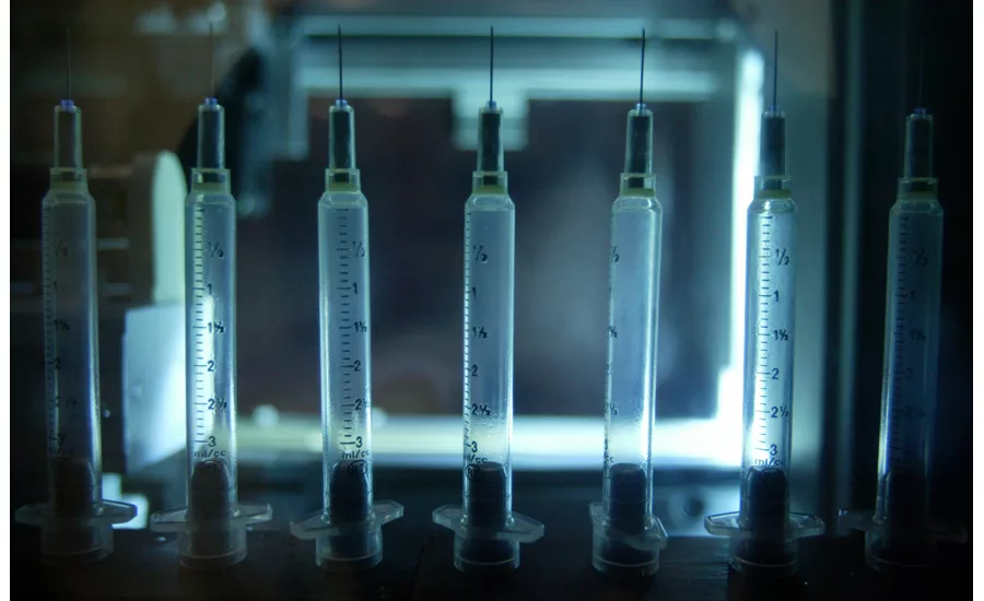

Disposable needles make up a large percentage of the disposable medical device market. Billions of needles are assembled annually.
A wide variety of medical devices incorporate a needle or cannula, such as insulin syringes, hypodermic and angiographic needles, blood lancets, prepackaged medication syringes, introducer catheters, intravenous sets, venous-winged and port-access infusion sets, and blood collection sets. The federal Needlestick Safety and Prevention Act requires needle manufacturers to provide safer alternatives to existing needle designs, resulting in hundreds of new designs annually.
Needle assembly can be quite challenging. Joints must be well sealed to prevent fluids such as blood or medicine from leaking. The joint is small and cylindrical. It typically joins a stainless steel cannula to a plastic hub. Only a high-strength joining method will ensure that the cannula does not move or release from the hub during use.
Medical device manufacturers have historically used a variety of time-consuming and expensive methods to assemble disposable needles. Insert-molding the cannula into the plastic hub is one method, but it must be extremely accurate to ensure that leak paths are not present. Because the aesthetics of the needle assembly are critical, weld flash must be well hidden or eliminated. Mechanically interlocking cannulae to hubs is similarly limited due to expense and resource requirements, and joint sealing is even more challenging.
Adhesives deliver high strength, hermetically sealed bonds, simple processing and gap filling. Although many different types of adhesives are suitable for needle assembly, light cure technology has become the joining method of choice because of its fast cure and simple processing. Both acrylic and cyanoacrylate adhesives are available for light-cure applications.

When assembling needles, the cannula is inserted into the hub well. The well helps align the adhesive dispense tip with the cannula-to-hub bond joint. It also promotes adhesive flow into the bond line. As the adhesive is introduced to the needle assembly, the well ensures that the material flows and achieves adequate bond line coverage. The larger the well diameter, the faster the adhesive typically flows into the bond area.
The core or engagement length is located beneath the well, where the inner diameter of the hub decreases to a slight slip fit with the cannula. By increasing engagement length, needle pull strength will increase until the adhesive joint strength exceeds that of the hub or cannula. When high viscosity adhesives are used, the adhesive may only partially fill the engage- ment length.
Cannula gauge size has a significant impact on both pull strength and failure mode. As gauge size increases, the circumference of the cannula decreases, resulting in reduced surface area. This reduction in bond area can decrease needle pull strength vs. a needle assembly with a smaller gauge cannula or an increased cannula circumference. In general, adhesive bonds of large cannula gauges, such as 27 gauge, fail to the cannula, leaving the majority of the adhesive in the hub. Conversely, smaller cannula sizes, such as 22 gauge, typically fail to the hub.
The diametrical gap is the difference between the inner diameter of the hub and the outer diameter of the cannula. A 0.002-inch diametrical gap is common. As the diametrical gap decreases, the adhesive more slowly fills the annular area in the core. It is also more likely to migrate out the back of the hub. This could reduce pull strength.
A diametrical gap greater than 0.002 inch is uncommon, unless an engineer intends to use multiple gauge cannulae in one hub. In such a case, diametrical gaps of 0.005 inch to 0.01 inch have been used.
Annular rings are recesses that are molded or machined into the well or core of the needle hub. They can significantly increase adhesive strength. Although the depth of annular rings can vary, recesses are typically 0.005 inch to 0.008 inch.
When an adhesive flows into the recessed rings and cures, it bonds to the cannula and is mechanically held in the rings. Annular rings are typically used in hubs made of difficult-to-bond substrates, such as polyethylene and polypropylene.
