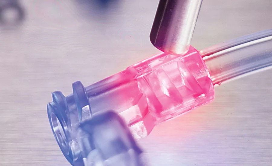

Encompass UV-cure acrylic urethane adhesives incorporate Ultra-Red fluorescing and See-Cure color-change technologies. The adhesives are blue, but become colorless when cured and appear red under low-intensity black light during inspection. Photo courtesy Dymax Corp.

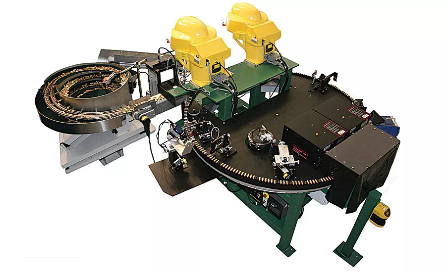

Ammunition manufacturer Sellier and Bellot uses a custom Autosealer 5500 UV-adhesive dispensing and curing system to increase productivity. Photo courtesy Hernon Manufacturing Inc.

Ammunition manufacturer Sellier and Bellot is familiar with these challenges, having faced them for many years while using a solvent-based sealant to seal the bullet and primer of various caliber ammunition (0.38, 0.40 S&W, 0.45, 0.357 and 0.308). Although dispensed automatically, the sealant required nearly a minute to cure and often caused the dispense valve to clog, resulting in low production rates.
In the fall of 2013, Sellier and Bellot significantly increased productivity by switching to a custom system that dispenses and cures ultraviolet (UV)/anaerobic sealant. Made by Hernon Manufacturing Inc., the Autosealer 5500 system features a vibratory feeder bowl combined with robotic feeders, an HMI, conveyor belt, vision cameras, the SureShot 3500 dispenser and Ultracure 6 light (with mercury-arc bulb) for rapid curing.
Edgardo Rodriguez, director of sales and marketing at Hernon, says the system dispenses a micro-shot of sealant, cures it and then inspects and verifies its location on each bullet. At top speed, the system processes up to 300 bullets per minute. Its conveyor belt switches out in 15 minutes to accommodate different-caliber ammunition.

Dymax Corp.’s line of Encompass UV-cure acrylic urethane adhesives incorporate the company’s Ultra-Red fluorescing and See-Cure color-change technologies. The adhesives are blue, but become colorless when cured and appear red under low-intensity black light. This allows inspectors to quickly and easily verify the adhesive is present and fully cured to the proper depth.

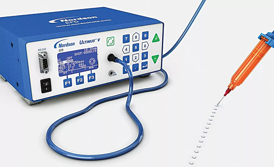

UV-cure adhesives do not require special dispensing systems. Standard time-pressure and positive-displacement systems can work just fine, so long as they meet two conditions. The first is that all wetted parts (plastic or metal) must be compatible with the adhesive. Incompatibility may cause material contamination or inadequate performance.
The other condition is all plastic components—feeder tube, syringe, dispense tip and fittings—need to be black, opaque or amber to block UV light. Suppliers make these parts by blending color resins into the liquid plastic prior to molding.
“When dispensing UV-cure materials with a pneumatic system, only use dry filtered air,” recommends Tom Muccino, business manager for adhesives packaging systems at Nordson EFD. “Air that has any moisture or even trace impurities, like oil, will cause fluid contamination. Or, if the adhesive is moisture-cure, it will harden in the syringe barrel.”
Muccino advises not to reuse disposable plastic components as an additional way to prevent material cross-contamination. He also advises using amber syringes that block UV light and use a barrel piston. Without a piston, air can enter the material. A piston also provides uniform emptying of the barrel and more-consistent deposits, without leaving residue on the syringe’s inner walls.
A couple years ago, an equipment manufacturer replaced its dispense valve with Nordson’s 752HF high-flow diaphragm valve to eliminate the creation of tiny air bubbles, which had formed due to outgassing from the UV adhesive. Muccino says the valve’s inert polymer diaphragm, which isolates the actuator from the valve, provides improved material flow.
