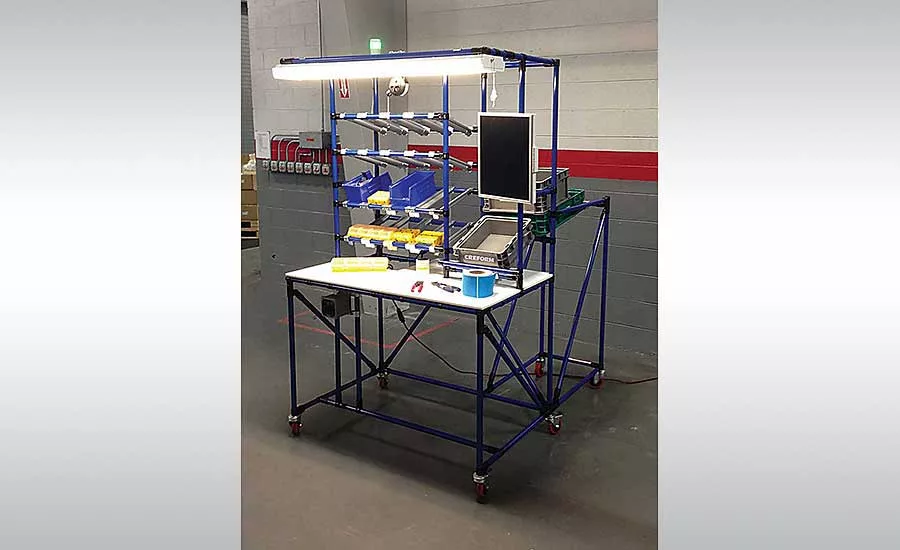

  • Heavy-duty portable workstation
  • On wheels for cleaning or repositioning
  • Features O/H light, tool balancer and PC screen
  • 650 lb. capacity station
  • Placon conveyors present parts, boxes and totes
