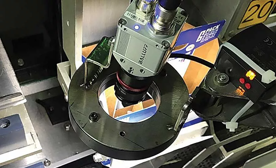

Camera-based vision systems are used in many industries. Here, a camera with a ring light performs inspection on a carton making machine. Photo courtesy Balluff Inc.

Correct lighting is the most crucial element for successful machine vision applications. To successfully apply machine vision, basic lighting concepts and lighting techniques for industrial applications should be understood.
Machine vision systems and smart cameras are capable of precision measurements. Precision measurements are needed for inspection and quality control purposes. To facilitate exact measurement, the vision system must identify edges and other part features by maximizing contrast through various lights and lighting techniques. With many machine vision applications, solving lighting issues is tantamount to solving the application itself.
Many questions arise concerning lighting: What type of light should be used-spot, ring or dome light? Maybe an on-axis, linear light or backlight is needed. Should color be considered? Experience may help, but even lighting veterans begin the process by choosing a light and working through a process of elimination. Each light is tested by varying its angle and height above the parts. Keeping an assortment of lights on mobile testing equipment can lead to quick solutions.
Lighting can be a complicated challenge. However, some applications can use ambient light. To use ambient lighting, applications need consistent artificial light with no variations due to skylights, windows, or lights being turned off and on. If ambient light can consistently light the defect area so that a vision system can conduct an inspection, it may work.
