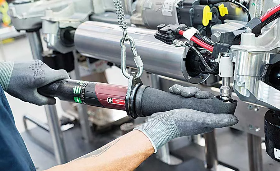

Using a handheld angle wrench, a Rhenus SML assembler tightens various brackets on an axle. Photo courtesy Desoutter GmbH
