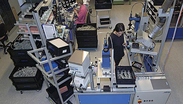

Photo courtesy Bosch Rexroth Corp.
People, workstations and equipment should be arranged to optimize flow, minimize waste and boost productivity. Photo courtesy Bosch Rexroth Corp.

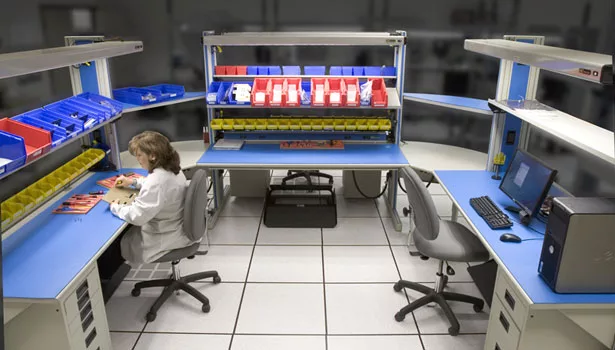

Workstations that can be easily assembled and disassembled allow more flexible plant layouts. Photo courtesy Bosch Rexroth Corp.

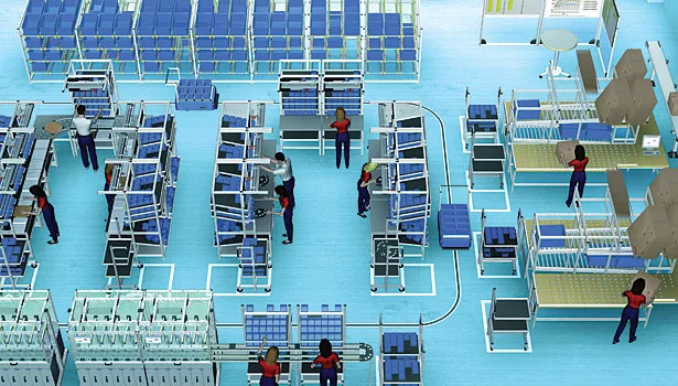

Illustration courtesy Bosch Rexroth Corp
In a lean plant floor layout, equipment is arranged to ensure the flow of people, material and information. Illustration courtesy Bosch Rexroth Corp

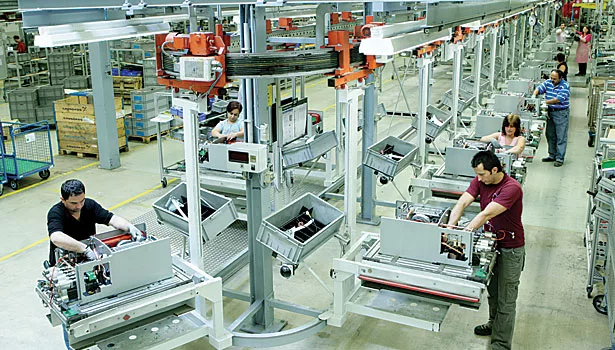

Photo courtesy IAC Industries Inc.
Assembly lines have changed dramatically due to trends such as just-in-time delivery and parts sequencing. Photo courtesy IAC Industries Inc.
