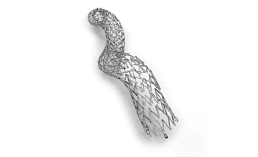

Engineers turned to nitinol when they created a new stent that features a 3D geometry. Photo courtesy Veryan Medical Ltd.

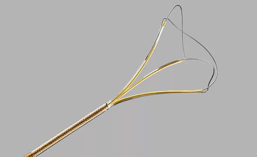

This nitinol medical device is used by surgeons to engage, reposition, release or extract stones in the kidney and the ureter. Photo courtesy Cook Medical LLC

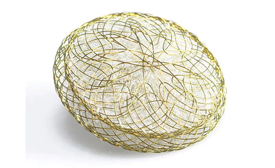

This atrial septal defect occluder consists of flexible nitinol wire mesh. Photo courtesy Occlutech International AB

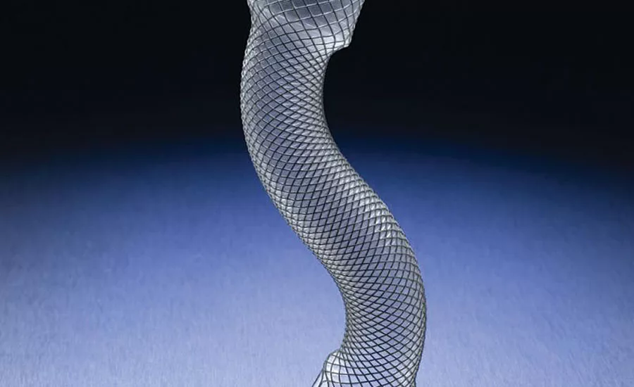

Nitinol is a metal that has magical properties, such as superelasticity and the ability to repeatedly retain its preformed shape. Photo courtesy Boston Scientific Corp.

Engineers at Veryan Medical Ltd. also turned to nitinol recently when they created a new stent that features a 3D geometry. The BioMimics 3D device uses helical center line geometry that mimics natural vascular curvature to promote secondary (swirling) flow and elevated haemodynamic shear stress, which has a protective effect on the endothelium.
