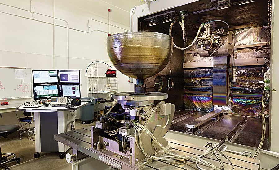

This titanium propellant tank, designed for use in a satellite, was created using electron beam additive manufacturing technology. Benefits included an 80 percent time reduction to manufacture the tank, a 75 percent reduction in waste and a 55 percent reduction in cost. Photo courtesy Lockheed Martin Space Systems

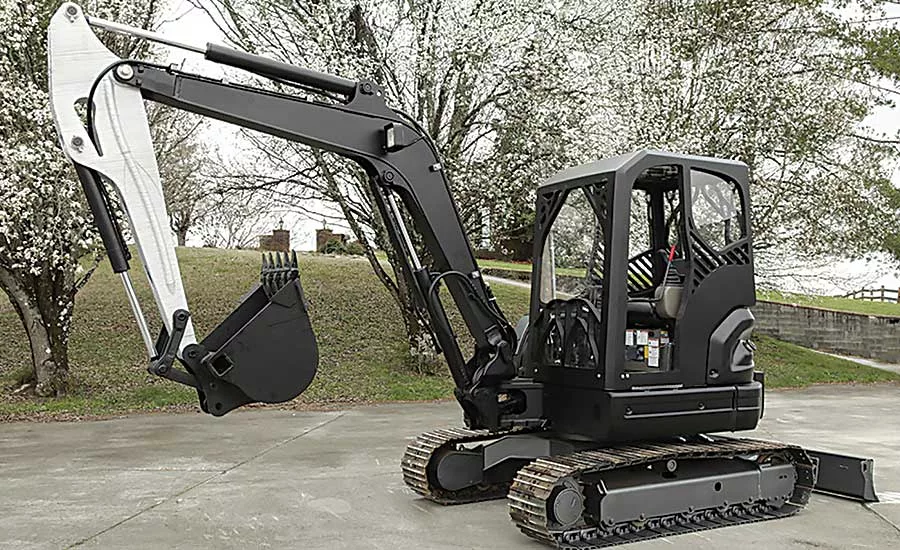

This mini excavator features metal parts that were printed. Photo courtesy Oak Ridge National Laboratory

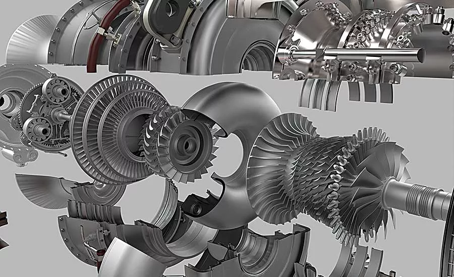

When it debuts later this year, this advanced turboprop engine will use a wide variety of 3D-printed metal components. Additive manufacturing will replace 855 conventionally made parts with just 12 printed components. Illustration courtesy General Electric Co.

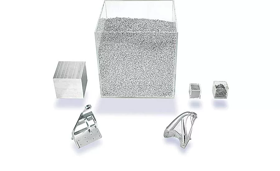

The bracket on the left was produced using traditional subtractive manufacturing methods from the left-most metal cube. Most of the input material became waste (the largest cube). The bracket on the right was 3D-printed from a metal powder (the third cube from the left). The waste, in the right-most cube, was also minimal. Photo courtesy Concept Laser GmbH

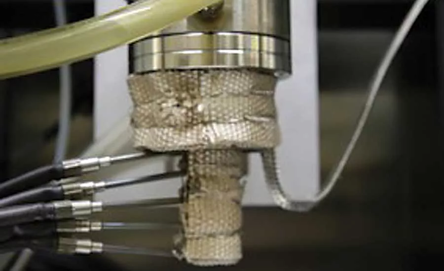

A new process called direct metal writing creates parts by extruding semisolid metal through a nozzle. Unlike other metal 3D printing techniques that use lasers to fuse metal powder, the direct metal writing approach incorporates an ingot that’s heated until it reaches a semisolid state before it’s forced through a nozzle. As it cools, the material hardens to form a metal structure. Photo courtesy Lawrence Livermore National Laboratory

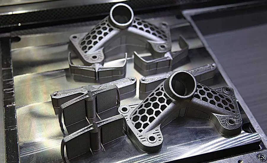

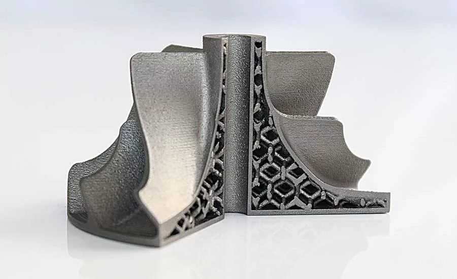

Additive manufacturing allows companies to easily manufacture complex shapes and structures that have been difficult to make with traditional subtractive manufacturing methods. Photo courtesy Stratasys Direct Manufacturing

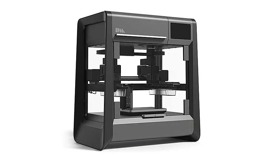

This new end-to-end desktop system aims to make metal printing easier and less expensive than traditional processes. Photo courtesy Desktop Metal Inc.

Electron beam additive manufacturing is favored by aerospace manufacturers, such as Airbus, General Electric and Lockheed Martin. It’s ideal for producing large-scale, near-net shape parts made of Inconel, tantalum, titanium and other high-value metals. The process can replace a long lead-time component or unitize what was formerly many components into a single preform.
Electron beam melting (EBM) is a proprietary process developed by Arcam, which recently became a division of GE.
EBAM is a proprietary process developed by Sciaky that can produce high quality, large-scale metal structures, up to 19 feet in length made out of tantalum, titanium and nickel-based alloys in a matter of days.

Another new player in the metal 3D printing market is Desktop Metal Inc. It claims that its Studio System, which consists of a printer and a microwave-enhanced sintering oven, is similar to the safest and most widely used 3D printing process—fused deposition modeling (FDM). The company also claims that the machine will be able to print parts using a variety of metals and even more than one metal at a time.
Instead of using a laser to melt powdered metal, this system uses metal rods in the same way that 3D printers have used plastic in the past. The metal is fused together using a combination of microwaves and a furnace. Desktop Metal calls it “the first office-friendly metal 3D printing system.”
“It’s the only metal 3D printing system that is cost-effective for engineering teams,” claims Ric Fulop, CEO and co-founder of Desktop Metal. “For the first time, it’s possible to produce highly complex metal parts and assemblies with metal 3D printing without leaving the office.
“Unlike traditional metal 3D printing processes, the DM Studio System requires no hazardous powders, no lasers and no cutting tools to operate,” says Fulop. “Instead, it uses bound metal deposition, a proprietary process, to make accurate and repeatable parts, similar to FDM.”

Engineers at LLNL also recently developed a method for printing metal parts that extrudes semisolid metal through a nozzle. The metal is engineered to be a shear thinning material, which means it acts like a solid when standing still, but flows like a liquid when a force is applied.
Instead of starting with metal powder, the direct metal writing technique uses an ingot that’s heated until it reaches a semisolid state. Solid metal particles are surrounded by a liquid metal, resulting in a paste-like behavior. Then it’s forced through a nozzle.
