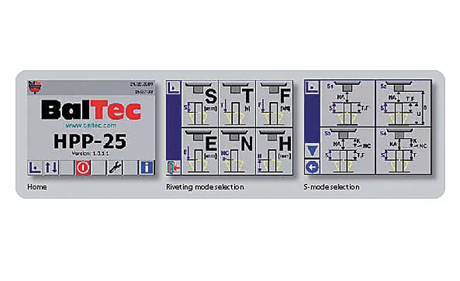

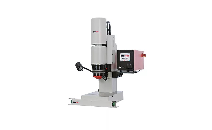

The Baltec HPP-25 is based on a revolutionary new hardware and intelligent software; this system offers users a broader application spectrum for continuous quality assurance allowing for effective monitoring of any riveting variable in assembly applications.

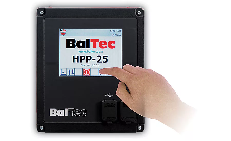

The HPP-25 process controller is comprised of a microprocessor control system as part of a Baltec riveting machine control. This new, extremely user-friendly system with touch screen interface has been designed to work with an even wider range of applications.
Previous system functions were re-evaluated and consequently optimized or fully redesigned to improve set up, programming and user-comfort standards enormously. These features have resulted in numerous user benefits, for example: A maximum 6 program-modes, 63 rivet program storage capacity; rivet spindle speed display, sensor calibration adaptable to mode of operation (e.g. riveting from below); hiding of unwanted data or functions; USB and Ethernet interfaces for data recording and processing; collection of all relevant riveting process parameters via data logging with each parameter being selectable as a “controlling parameter” and a lot more features beside.
