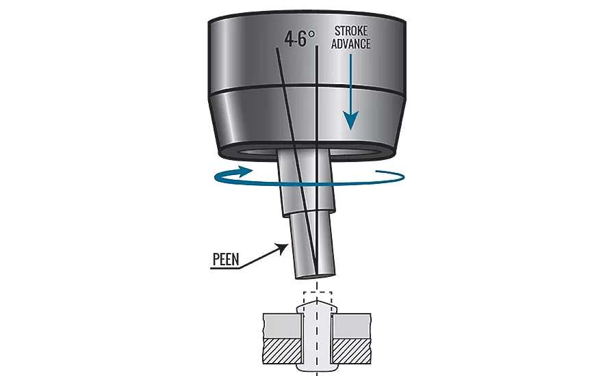

To assure a quality head form it is critical that the center of the orbital head be aligned with the center of the rivet being formed. A misalignment can produce undesired results, rejected parts and possible damage to bearings and the orbital head. Alignment issues can come from: the fixture, the part, and/or the machine setup. The easiest method to check the alignment is with Orbitform’s Orbital Alignment Kit. Typically on a 1/4” diameter rivet, the center of the orbital head should be within 0.004” Total Indicator Runout from the center of the rivet.
THE PEEN:
The peen is the perishable tooling that touches the rivet or part being formed. Make sure the peen-holder turns freely inside the orbital head. The peen is held in place with a magnet or set screw and should be easy to remove. Apply an anti-seize lubricant to its shank at least once a week.
Check the peen for excessive wear. Never sharpen or machine a worn peen. Changing the length of the peen changes its point of contact, which can affect the resulting head form, and possibly lead to bearing failure. Always replace worn tooling. Make sure new tooling meets the standards for hardness, polish, and coating set by the manufacture.
Check if the peen is too hot to touch after forming. Excessive heat can lead to or indicate bearing failure. A hot peen may mean it’s hitting the part too hard or dwelling on the part too long and/or not rotating properly. The flow control on the Powerhead’s exhaust may need to be adjusted to increase or decrease the Powerhead’s advance rate.
