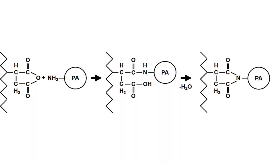

The maleic anhydride groups are the most commonly used coupling agents. The maleic anhydride is grafted on the PE and the pendent anhydride groups then react with the polyamide amine end-groups. This illustration shows the reaction of a succinic anhydride group in the modifie

Most polymer blends are immiscible. In the absence of a coupling agent, polymer blends typically show no improvement of their properties over those of their individual components. Among the several types of coupling agents available, the maleic anhydride groups are the most common. The maleic anhydride is grafted to the polyethylene, and the pendent anhydride groups then react with the polyamide amine end-groups.

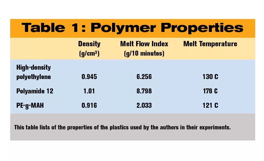

All the materials in our study were industrial grade. For the HDPE, we used Lupolen GX 5038 from Lyondell Basell. For the PA12, we used Grilamid L 20 from EMS-Grivory. For a compatibilizer, we used SCONA TSPE 1112 GALL from BYK, a linear low-density polyethylene that has been grafted with 2 percent maleic anhydride (PE-g-MAH). Also referred to as coupling agents, compatibilizers are additives that, when added to a blend of immiscible materials during extrusion, modify their interfacial properties and stabilize the melt blend.
To eliminate the effects of moisture, the materials were dried for six hours at 85 C before blending. The blends of PA12, PE-g-MAH and HDPE were mixed using a co-rotating, twin-screw extruder. The blends were prepared in the following weight ratios:

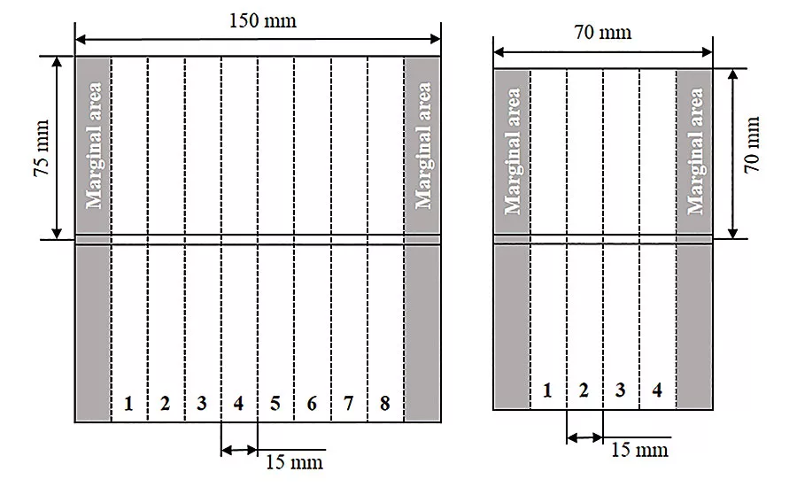

For the diffusion welding experiments, the test specimens were cut and milled to a size of 70 by 70 millimeters. They were inserted into a mold to prevent leakage of the melt under the subsequent applications of a preload force, which was needed to guarantee contact between the molten plastic. As a result of pilot tests, a heating tool temperature of 200 C and a heating time of 1 hour were chosen.
After welding, the test plates were cut into specimens for quasi-static tensile testing. The test plates that were joined with hot-plate welding were cut into eight test specimens to analyze their strength. The test plates that were joined with diffusion welding were cut into four test specimens. Both outer test specimens were not analyzed to eliminate marginal influences. We used a tensile testing machine with a 10 kilonewton load cell. The cross-head speed was 20 millimeters per minute.

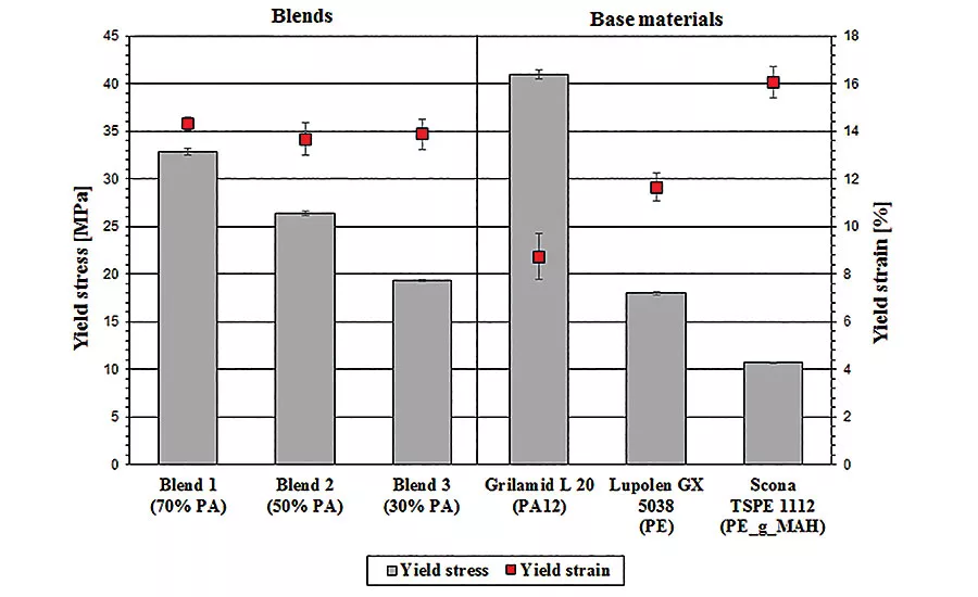

Graph 1 summarizes the results for yield stress and strain. Values for the base materials are plotted on the right to serve as a comparison. The yield stress of the polymer blend decreases with increasing HDPE content, while the yield strain remains constant at around 14 percent and is higher than that of the base materials.
Yield stress and strain were found to be rather sensitive to force transmission between phases. According to this, yield stress and strain can be regarded as
suitable measures to evaluate the adhesion between different phases. A smaller
domain size shows a better dispersion of the polymers and, consequently, a better interfacial adhesion.

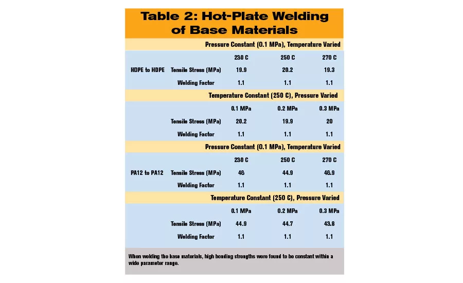

The welding experiments of the base materials show for both, polyethylene and polyamide, a welding factor of 1.1, which is illustrated in Table 2. (The welding factor, fz, is defined as the quotient of the weld strength, σWS, and the yield stress of the base materials, σBM: fz = σWS / σBM.)
These high bonding strength values are found to be almost constant within a wide parameter range for heating tool temperature and welding pressure. The variation in pressure is exemplarily shown for the temperature of 250 C. The welding factors greater than 1 were caused by the increase of the cross-sectional area of the weld bead.

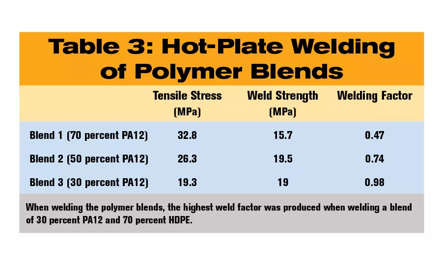

Welding tests on the polymer blends were always done with blends of the same weight ratio. The welding factors of these experiments are shown in Table 3. The results show that a decreasing ratio of PA12 causes an increase of the welding factor. A reason for this could be the dominant phase of the polymer blend. Up to a ratio of 50 percent of PA12, HDPE seems to be the dominant phase. As long as HDPE is the dominant phase, it can be seen that a slightly higher bonding strength (around 19 MPa) can be achieved in comparison to the tensile strength of pure PE (18 MPa). The welding factor decreases only because of the higher tensile strength of the polymer blend.
Surprisingly, if HDPE is the minor phase in the blend, the weld strength decreases. However, the weld strength should be higher once PA12 is the dominate phase, because of the higher tensile strength of pure PA12. The theory of the weld formation mechanism is based on the relaxation of the molecular chains and the diffusion through the joining plane. As long as PE is the dominate phase, this theory can be considered valid.
If PA12 is the dominate phase, the diffusion process seems to be restricted. The reason for that could be the HDPE, which hinds the diffusion of the PA12 chains through the joining plane.
Furthermore, the mobility of the polymer chains is important for the diffusion process. The mobility of the PA12 chain is restricted because of the chemical bonding of PE-g-MAH. Due to the restricted mobility, the diffusion process decreases. Also, the unmodified side of the PA12 chain is only affine to other PA12 chains. For that reason, just this part of the chain can generate entanglements with other PA12 chains.
On the contrary, HDPE is affine to HDPE chains and modified PA12 chains. This supports the diffusion through the joining plane, so the weld formation mechanism.

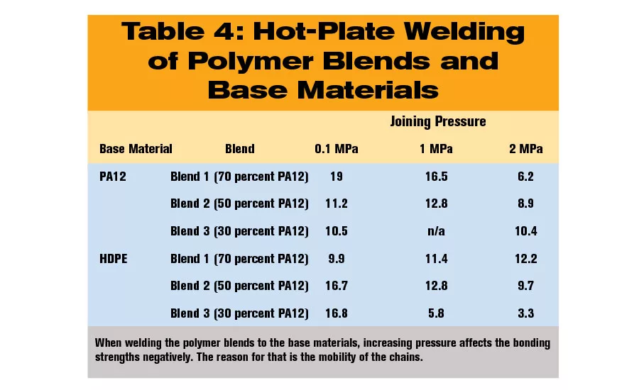

The welding experiments of blends to base materials were done with the optimized parameters for the base materials. Thus, the heating tool temperature was 230 C for welding a blend to HDPE and 270 C for welding a blend to PA12.
As might be expected, the highest weld strengths are achieved with a high ratio of the base material in the blend. It is noticeable that the bonding strength of blend 2 (50 percent PA12) to HDPE already reached the level of the tensile strength of HDPE (18 MPa). On the contrary, the welding of blend 1 (70 percent PA12) to PA12 did not nearly reach the tensile strength level of the polymer blend. Here the comparison with the polymer blend instead of PA12 is required, because the blend has the lowest tensile strength of all involved components. The results confirm the expectation of the restricted mobility of the PA12 chains.
Considering the welding pressure, it can be seen that increasing pressure affects the bonding strengths negatively. The reason for that is the mobility of the chains. The molten layers on each plastic part possess temperature gradients. The temperature of the molten plastic is highest at the heating tool. But, with increasing distance from the tool, the temperature decreases. Increasing the welding pressure pushes the hottest molten material out of the welding zone, leaving somewhat cooler material to flow into the joining plane. With lower temperatures, the mobility of the molecular chains decreases and the diffusion through the joining plane is aggravated.

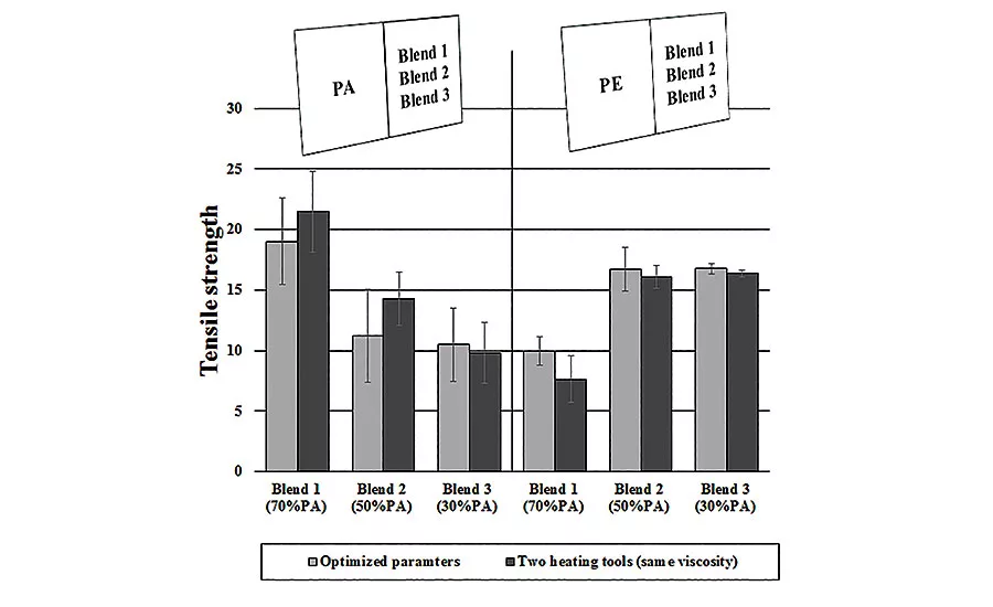

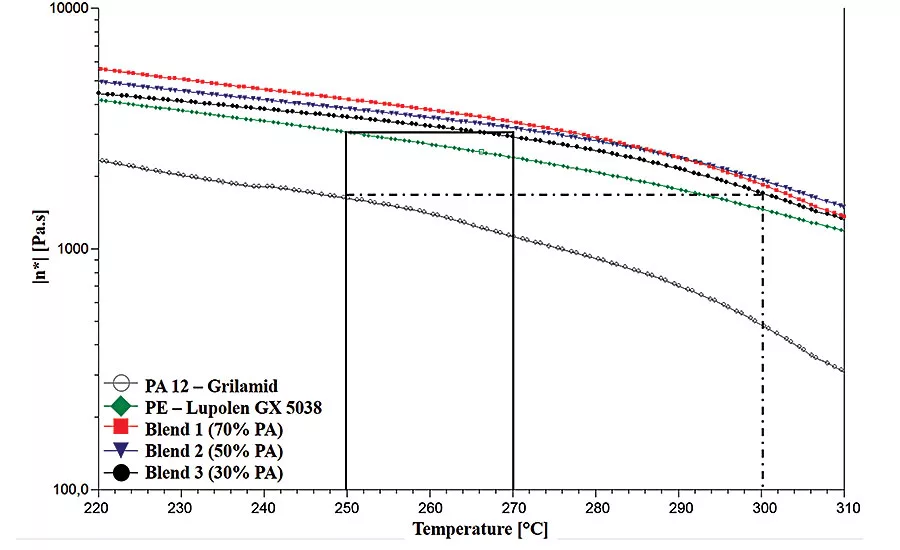

Due to the restricted chain mobility, we realized that we had to modify the welding parameters so the molten plastic of each part was at the same viscosity. This required us to heat both components to two different temperatures, which we achieved by using two heating tools.
To see if our thinking was correct, the polymer blends and base materials were analyzed rheologically. Graph 3 illustrates the melt viscosity of the polymer blends and base materials at varying temperatures. It can be observed that the viscosity of the blends is higher than the viscosity of the base materials, which is caused by the higher molar mass of the blends.
Following up, the tool for HDPE and PA12 was heated to temperature of 250 C, while the tool for the blends was heated to 270 C or 300 C, depending on the ratio of HDPE to PA12. If the weld strength is taken into account, the results, illustrated in Graph 2 (dark bars), show on one hand, a small increase for the welding of blends to PA12. On the other hand, the joint strength for the welding of blends to HDPE decreases. This could be a consequence of the increased chain mobility of PA12 within the blend that results in a better diffusion. However, this increased mobility could restrict the movement of the HDPE chains, which, in turn, would explain the slight drop in the tensile strength for the weld of blend to HDPE.
In this experiment, higher weld strengths for the welding of the blend to PA12 were expected. As the blend is always the weakest component, the weld strength should be at one level with the respective tensile strength. In contrast to the welding of blend 3 to HDPE, having a welding factor of 0.93, the welding of blend 1 to PA12 shows a welding factor of only 0.65.

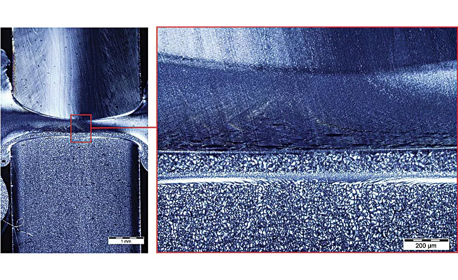

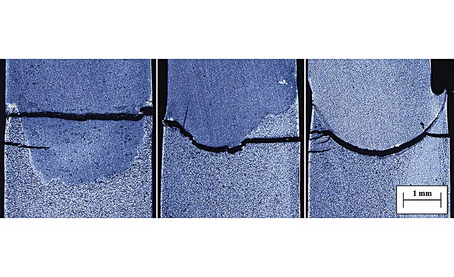

The reason for that decrease surprised us. In the vicinity of the PA12-blend interface, solely on the part of the blend, the welding seam contained several small micro-cracks which emerged in the flow channel lengthways to the orientation of the molecular chains. We do not yet have a plausible explanation for the formation of those cracks.

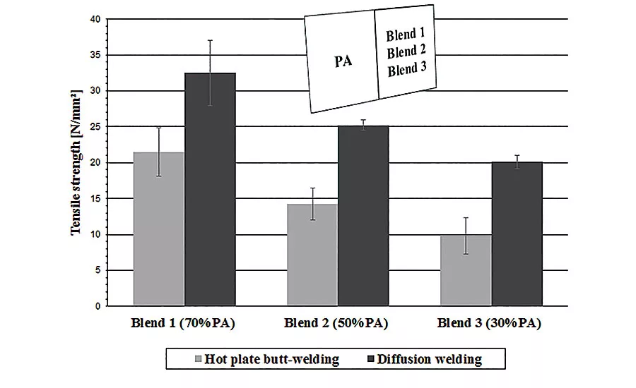

To eliminate the flow process of the melt, diffusion welding experiments were performed. In these trials, the polymer blends were welded to PA12. Graph 4 shows a weld strength plateau at the level of the tensile strength of the involved polymer blend, which indicates a welding factor of nearly 1. This particular joint is corroborated by the absence of micro-cracks. It can therefore be assumed that the flow of the melt influences the polymer structure, so that the interfacial adhesion decreases. It is worth highlighting that, despite the low ratio of PA12, the welding
factor is still nearly 1.
For joints with blend 1 (70 percent PA12), the fracture path goes through the base material, and the fracture starts in the most fragile polymer part—the blend. If the ratio of PA12 in the blend decreases, the weld seam becomes weaker, yet its bonding strength never decreases below that of the pure polymer blend. In general, all the fractures start in the most fragile polymer part. As soon as the fracture reaches the welding seam, the item breaks down. Hence, the joint’s breaking point is not associated with the welding seam.
