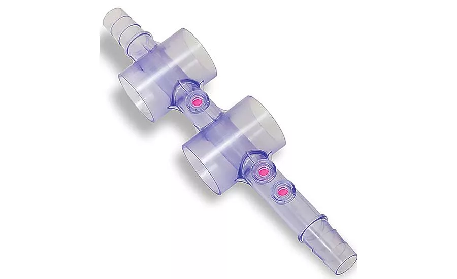

A few years ago, Dukane helped a medical device manufacturer find the right ultrasonic system to weld three tiny film caps (less than 0.25 inch wide) on polycarbonate disposable sensors. These sensors monitor pH and gas in artificial blood during ex-vivo assessment and evaluation.
Before meeting with Dukane, the manufacturer used a pneumatic ultrasonic welding system that performed somewhat poorly. Average scrap rates were 50 percent, and at times soared to 90 percent. In addition, lack of welding control caused the press thruster to traverse down after the thermoplastic melted. This unnecessary force caused part deflection, inconsistent welding and solidification. It also required vacuum leak testing on each sensor to ensure a hermetic seal.
Barton says that Dukane recommended the old system be replaced with Dukane’s iQ ES servo-based welder featuring Melt-Match technology. A 40-kilohertz unit, the welder precisely controls weld speed during the weld phase and initiates plastic part collapse only when a melt has been detected.
According to Barton, the manufacturer likes the servo-driven system because it repeatably produces a weld that hermetically seals the cap. This allows the company to significantly lessen its product testing time to just 10 percent, while lowering its production costs and improving product quality.

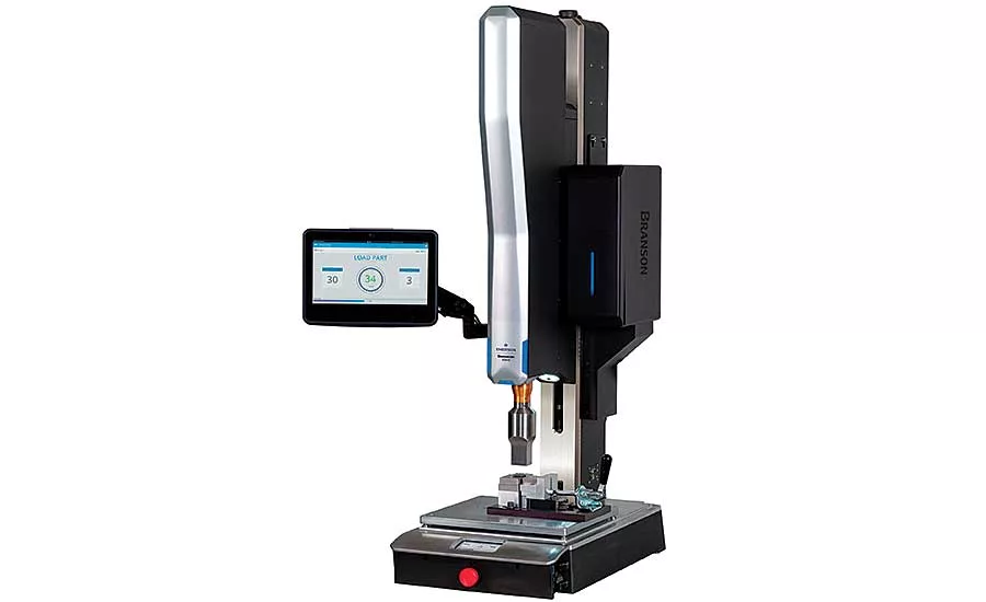

Last October, Branson unveiled its GSX-E1 Series ultrasonic welder, the first unit based on the company’s new GSX platform. Tarick Walton, global product manager for ultrasonics at Branson, says the platform took three years to develop. It is based on more than 70 years of ultrasonic welding experience, coupled with feedback from more than 400 customers.
“This first model meets manufacturers’ growing demand for damage-free welding of smaller and more intricate plastic parts, such as those with thin walls,” explains Walton. “Early users include manufacturers of medical and wearable devices with embedded electronics.”
Modular and flexible, the welder has the lowest trigger force in the industry at 5 newtons. It offers excellent repeatability with precise actuator control throughout the welding process. Also standard are various smart technologies such as intuitive graphing, quick tooling changeover and actuator setup, and an easy-to-use HMI.

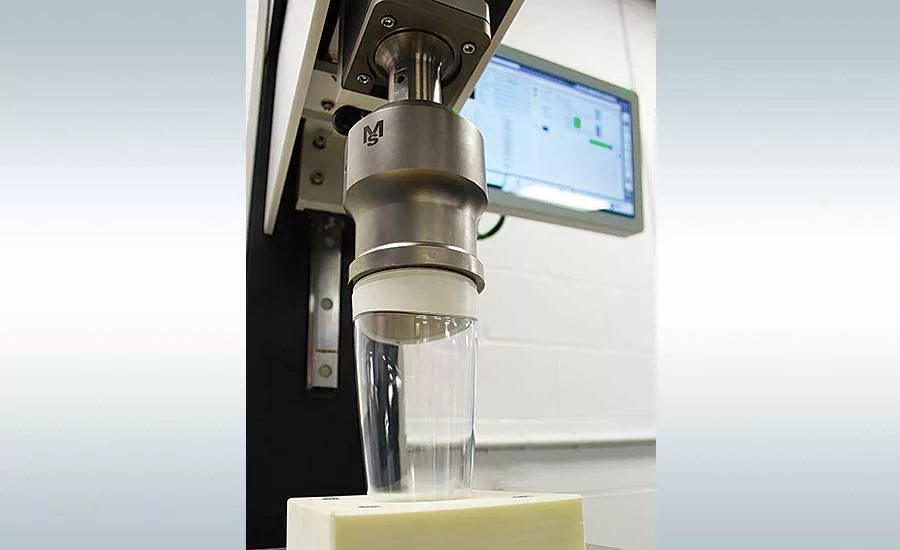

“Servo-driven ultrasonic welders have been around for quite awhile, but their data feedback capabilities were only so-so until the last few years,” notes Brad Rogers, director of sales for North America at MS Plastic Welders LLC. “Many servo welders, including ours, are now able to get feedback and make weld adjustments in milliseconds for parameters such as time, distance and energy input.”
Rogers adds that medical-device makers tend to have a greater need for immediate feedback during ultrasonic welding than other manufacturers, such as those, for example, that swage over a thermoplastic post to join a dissimilar material onto a housing. Feedback from advanced ultrasonic welders helps manufactures ensure that each welded medical part complies with electronic records and signatures.

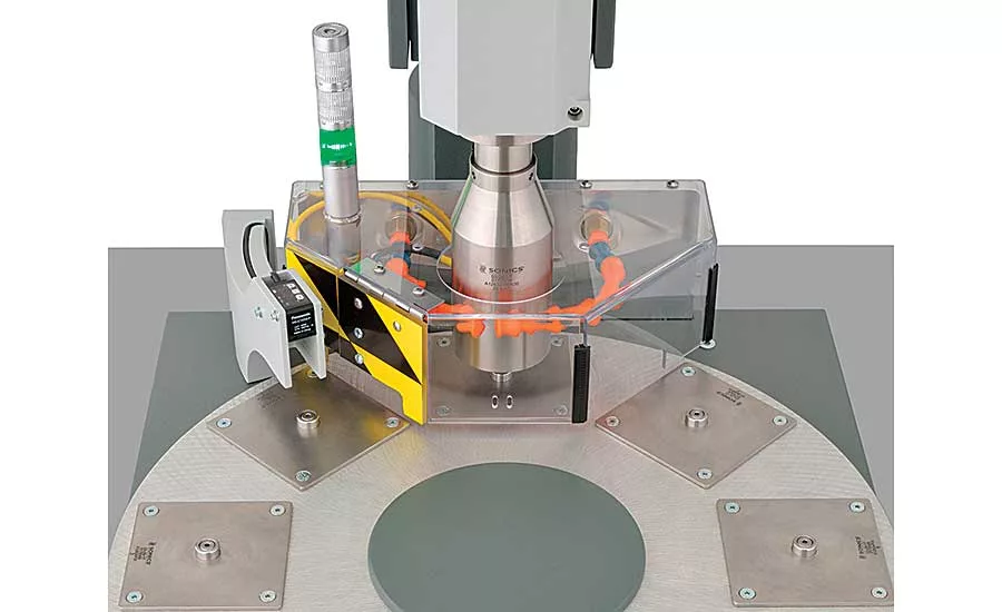

Sonics & Materials also offers a high-throughput rotary index table for use with the company’s pneumatic and stepper motor welding systems. The table features a built-in HMI and a safety guard with hinged door. An LED light tower provides visual process indicators of green, yellow and red.
When used with the 15- kilohertz pneumatic welder, the table can increase throughput for medium to large-size parts at higher amplitudes, as well as softer-plastic parts with a joint that’s more than 0.25 inch from the horn.
