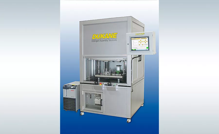

Laser welding is one of the newest technologies for joining thermoplastic parts. This noncontact process has many advantages. It’s fast and precise, and it doesn’t generate flash or particulates.
Its only limitation has been that the top part had to be made of a transparent material, while the bottom part had to be made of a material that absorbs near-infrared light. Without special additives, entirely transparent assemblies were not possible—until now.
Dukane Corp. has introduced a new laser welding system that allows clear-to-clear plastic welding without the need for laser-absorbing additives. The heart of the system is a new 2-micron laser that is readily absorbed by clear polymers and enables highly controlled melting through the thickness of optically clear parts.
The machine’s beam delivery system integrates a programmable multiaxis servo gantry and a scan head, supported by the company’s LaserLinQ software, which harmonizes the action of both components moving the beam. This assures highly precise and controllable beam delivery when welding large and midsized components.
The software also gives engineers the ability to break complex weld patterns into separate geometric segments, modify each segment independently, and assign different welding parameters to each segment. A CCTV camera within the machine provides a live weld preview on the HMI screen and gives engineers the ability to directly monitor and record welding cycles for further analysis. The machine’s laser enclosure is Class I certified and equipped with laser-safe glass windows.
This flexible welding system also allows rapid changeover of a wide variety of highly specialized tooling cassettes. The tools incorporate a binary tool identification system for automatic recall of weld recipes. They support multi-cavity function, multiple feature detection, vision systems and independent clamping systems to compensate for part variations.
Engineers can see the technology for themselves at Dukane’s display (booth 1312) at the fourth annual ASSEMBLY Show, which will be held Oct. 25-27 at the Donald E. Stephens Convention Center in Rosemont, IL, adjacent to Chicago O’Hare International Airport.

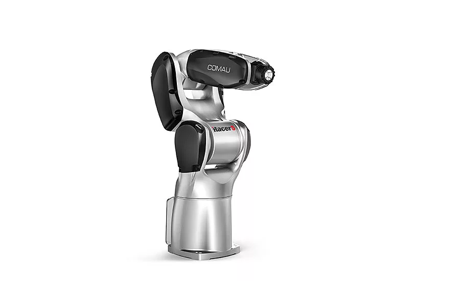

One supplier making its first appearance at The ASSEMBLY Show is Comau LLC (booth 145). The robotics OEM and systems integrator will be showing a number of new products, including the Racer 5-0.63 and Racer 5-0.80. These small six-axis robots were designed for high-speed applications in restricted spaces, such as handling, assembly and pick and place.
Both robots are controlled by Comau’s R1C 19-inch rack-mounted controller, which can be integrated into a single cabinet to control an entire line. The robots are also available in “openRobotics” versions, which can be directly integrated into existing automated assembly systems controlled by B&R Industrial Automation products.
The Racer5-0.63 has a reach of 630 millimeters and payload of 5 kilograms. Racer5-0.80 is also rated for a payload of 5 kilograms, but has an extended reach of 809 millimeters.
