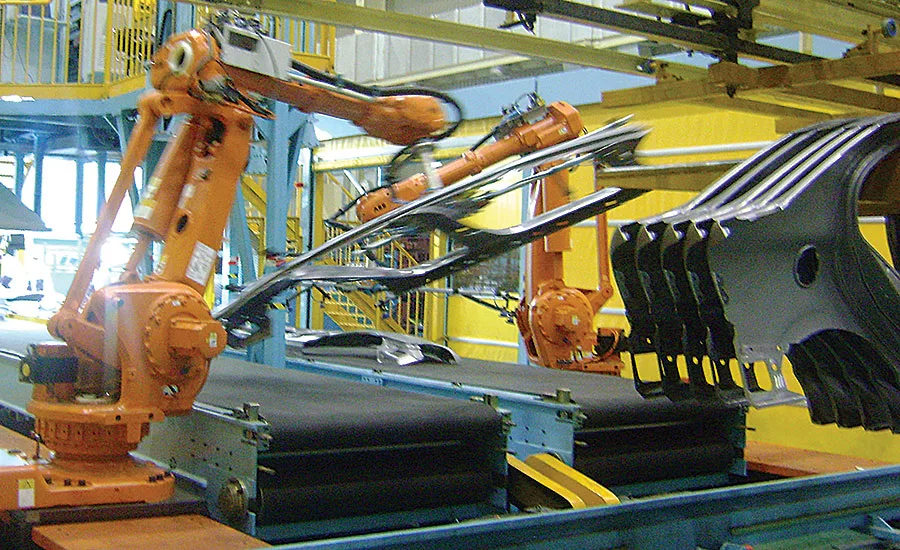

At a high-volume automotive plant in China, robots grab large metal parts one at a time off a rack and place them on a moving conveyor. A vision-inspection system ensures that the robot’s gripper properly attaches to each part. Photo courtesy Teledyne DALSA

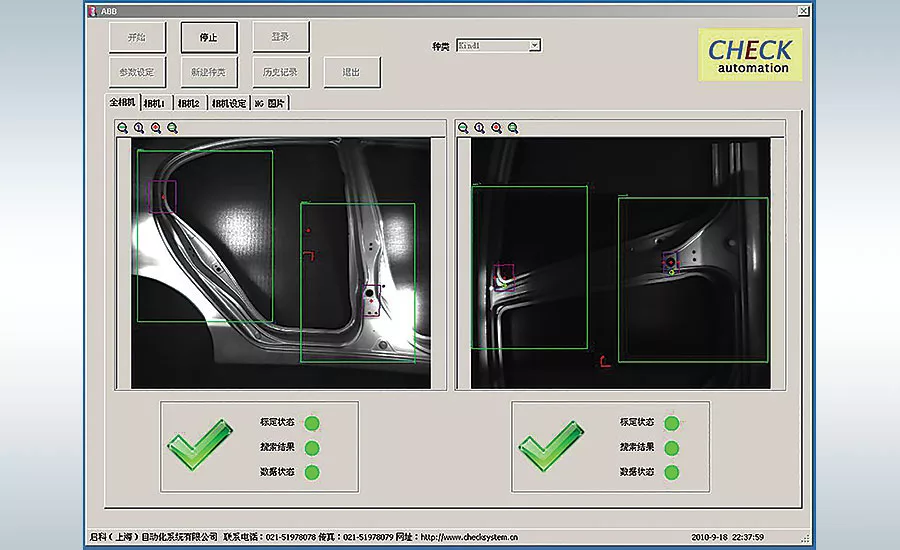

Sherlock image-processing software is used to verify that the position coordinates of the gripper and part are correct. Photo courtesy Teledyne DALSA

At one such facility, the assembly process begins with a robot grabbing large metal vehicle parts one at a time off a rack and placing them on a moving conveyor. The parts used to be lifted and placed by manually operated equipment, but this approach was time consuming and posed a safety risk to the operator. There was also a risk of damage to the part if it wasn’t moved correctly.
Automating the process has increased productivity and reduced costs. Nevertheless, safely grabbing each part poses a challenge for the robot, notes Tony Zhu, general manager of Check (Shanghai) Automation System Co. Ltd., a systems integrator that installed the plant’s automation equipment. If the robot gripper doesn’t attach to a part at four designated marks, the part can tilt and hang from the robotic arm, or drop off the rack and be damaged.
To ensure that robots on two assembly lines securely grip parts, the manufacturer uses a GEVA 1000 vision system from Teledyne DALSA. Installed earlier this year, the system consists of a controller, Sherlock software and a pair of Genie 2-megabyte cameras.
Each camera is dedicated to one assembly line and triggered independently. It captures images (at a rate of 15 frames per second) of the robotic gripper as it attaches to a part. These images are then analyzed with Sherlock’s pattern-matching Search Tool to verify that the position coordinates of the gripper and part are correct. The controller, in turn, tells the robotic arm to place the part onto the assembly line conveyor.
According to Zhu, the manufacturer likes that the vision system is easy to use, scalable (for future applications) and, thus far, has performed flawlessly. It also is impressed with the software’s advanced calibration capabilities.
Some image-processing software can distort the shape of large parts. Sherlock minimizes this distortion to increase alignment accuracy of the gripper and part. In addition, the software’s algorithm parameters ensure that marks on a part are clearly seen so that the robot’s lifting position is properly located.
“Before vision guidance, the robot gripped one part every five to six minutes,” says Zhu. “[Now it] grips a part every two minutes, and productivity has increased by about six times overall.”
